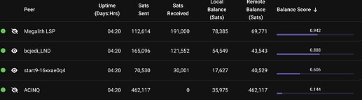

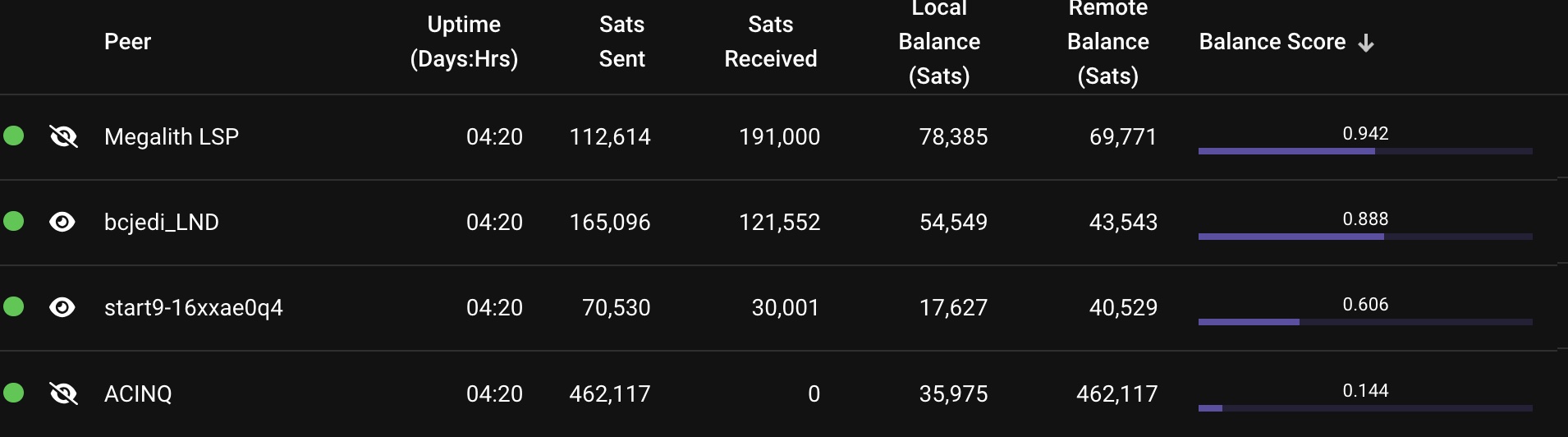

I found that MegaLith LSP is a better channel and re-balancing seem to work. I cannot re-balance from ACINQ at all. It also appears that MegaLith LSP is balancing there channel automatically. It is always close to 1 for me. It does move around but usually comes back to 8 or 1 daily. Something to think about.
I’ve not had any problems with ACINQ myself. What other channel were you rebalancing it against?
I guess I need to learn to dance…hehehe. So can I start a LND node right now and won’t make any problems with both running?
Just my start9 and @Fletcher channel. When I re-balance between him and myself ACINQ shows no route. As you can see from pic ACINQ is very very lopsided. Its not and issue for me since Megalith works perfectly.
