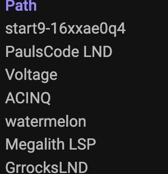

Hey Greg, Just to twist your noggin further I have not been able to route any payments out through your channel until this week, when a 2k sats payment went out. It routed to you / Start9 / Pauls LND and then onward 2 more hops. Do you know what the Start9 node’s fee for forwarding is? I have tried multiple small amounts and fees.
Yep…U twisted it alright. I have no clue. I haven’t changed anything. I’ll be back in 10 and Ill look into the logs and see if I can make heads or tails of what they are telling me

@paul Got a question sir - Why so many routes here for re-balancing?
I might be costing @Fletcher dearly?
ps- this might not be the correct place to post this query…
Your channel with Fletcher is not likely to be costing anything significant in fees (my node at 1% is probably the most expensive step in the route – you can always close your channel with my node if that is a concern). I assume you have both reached an agreement on the ratio of inbound/outbound for the channel between your two nodes or who should manage it, so rebalance transactions should be infrequent. Whoever does the rebalance transactions is the one who pays the fees. But these are Lightning fees, which tend to be quite small.
