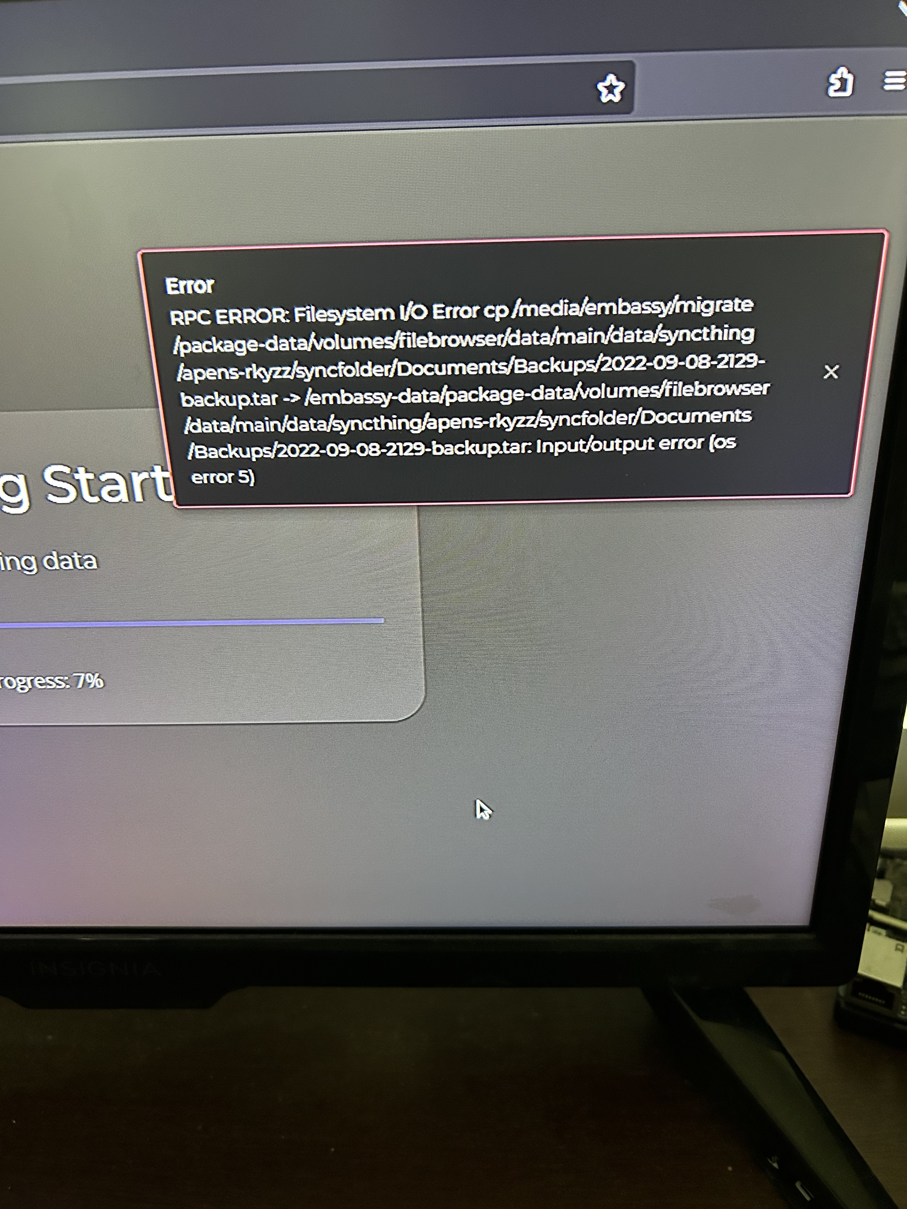

Had to do another transfer to keep block chain data , also uninstalled some apps like file browser, sync thing and Nextcloud to make transfers better, now getting this error below
In Linux, “OS error 5” indicates a file I/O error, usually related to hardware issues with storage devices themselves, but can sometimes also be caused by a problem with adapters or cables. It is a bit different than your last error (which was specifically a write error), but both can point to problems with the storage device.
I’m using the same cable that use to do previous transfer
Should I continue to try this option with a different cable
is there a reason why its referencing the data that has been uninstalled from startos
Based on the name, it looks like a backup.

In most cases, restoring from a backup restores the data as well. I know that Core and Knots, however, do not restore the blockchain data, due to its size. For details on particular services and what data is included in the backup, the Start9 team will know about that in more detail. I’ve restored a couple of services from backups just to test the process, but no experience beyond that.
The two errors indicate a hardware problem. Even though I mentioned that a cable could be the cause, that is usually not the case – in my experience it is typically the drive itself that is going bad.
It is your question about why a file from a deleted service is being copied during the Transfer step, that I think the Start9 folks will be able to answer better, since they have more inside knowledge of how that process works under the hood.
