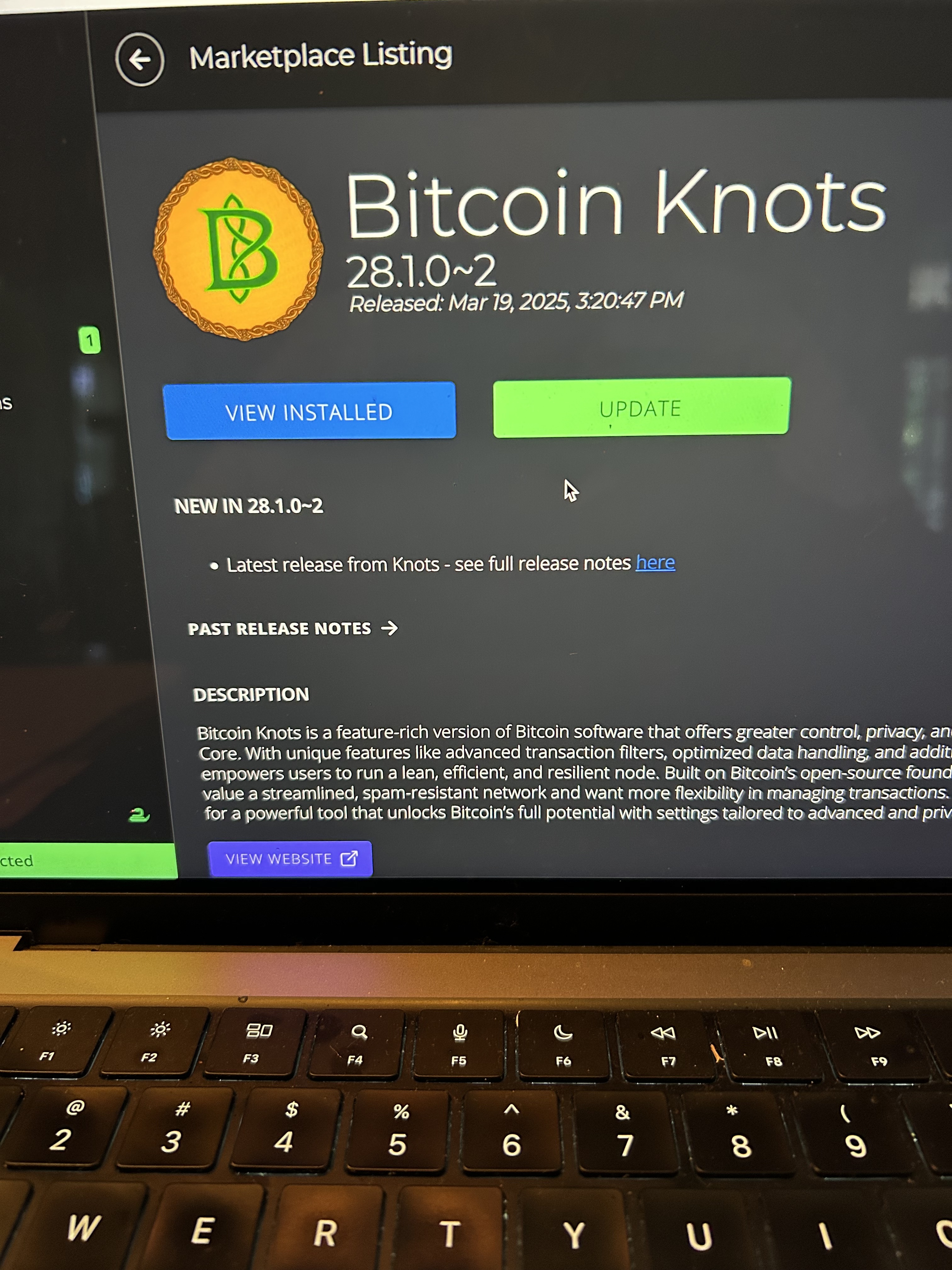

Knot is activing if installed but I’m not able to see it , when I open dev tools it not showing a reinstall button
Sorry, I don’t understand what you mean by “activating if installed”. Could you post some screenshots?

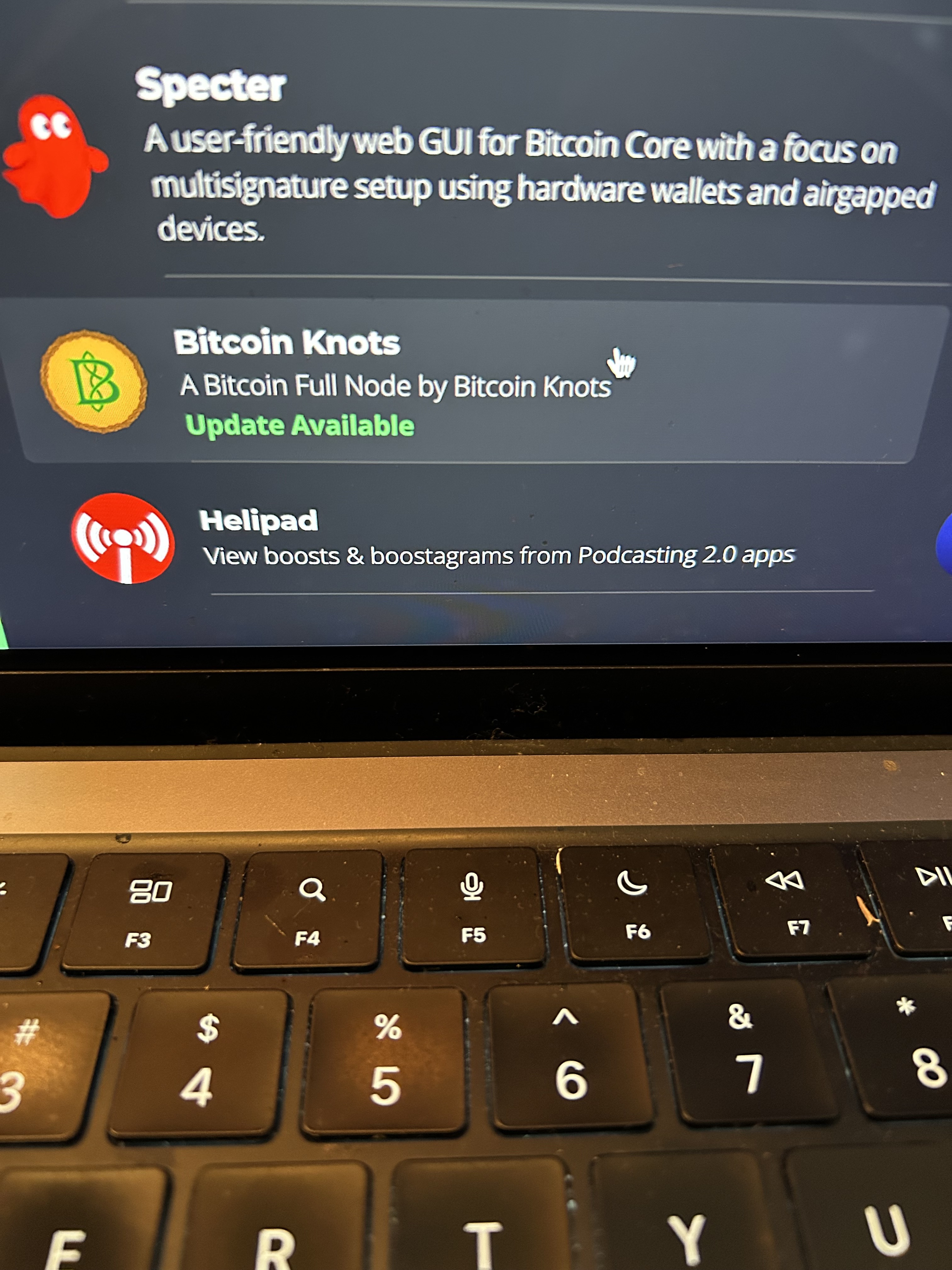

In the community marketplace knots show as update available, when clicked on the shows knot page with blue button -view installed and green button- update, when clicked on shows installing and bitcoin core comes up with a green start button
Ok, I think it is due to there being a Bitcoin Core update, and that conflicting with reinstall. Could you follow these steps and confirm whether or not you see the Reinstall button?
