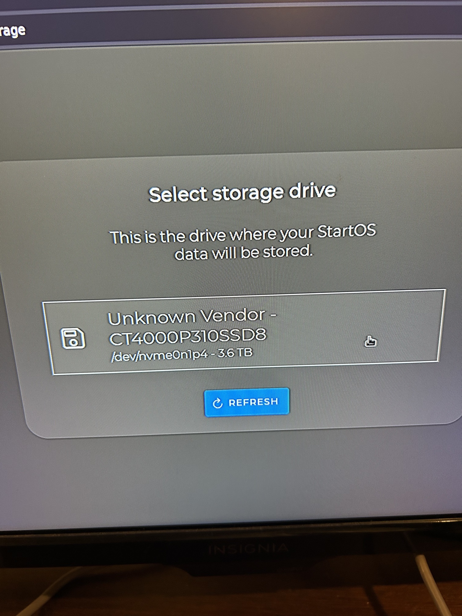

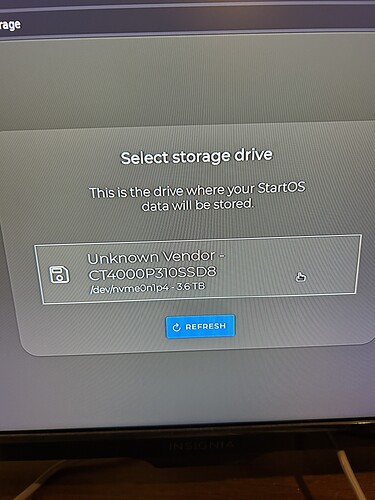

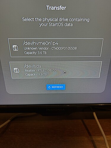

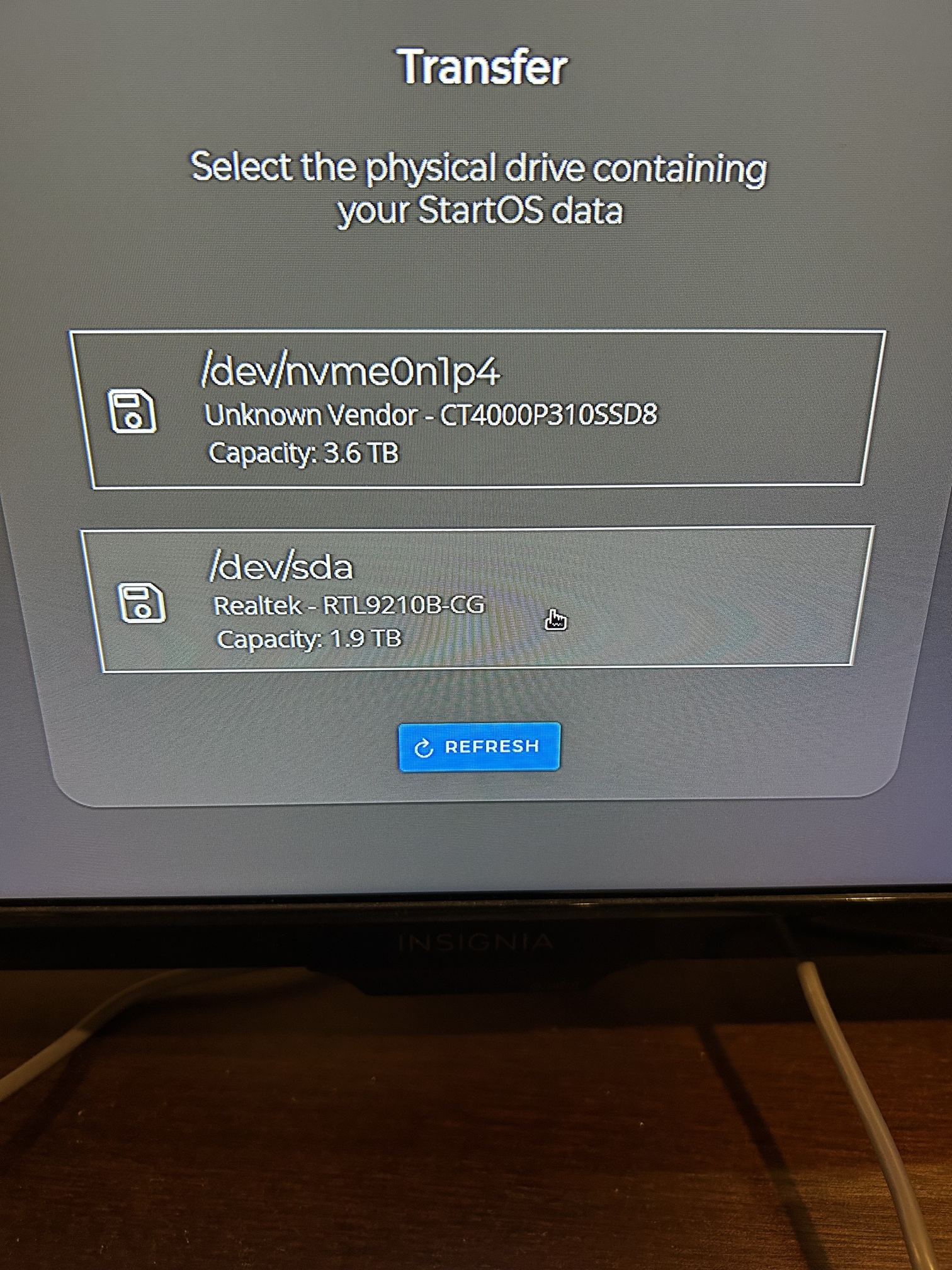

Ok, so the earlier two steps, which drive did you select for the “Transfer” page, and which did you select for the “Select storage drive” page?
transfer from the external 1.9 tb ssd and store on the 3.6 ssd
Ok, and what were the names of the two drives? Were they /dev/sdb and /dev/sda, or were they /dev/sda and /dev/nvme0n1?
I believe so , didn’t record that info
Those are two different scenarios. Can you repeat that step, and get the two specific device names. I need to understand which drive it is trying to write to when it gets that error.
I can retry the transfer again
BTW, do you happen to have a backup, just in case there is something wrong with the old drive? I don’t know why it would be trying to write to the old drive, so that worries me a bit.

I decided to try another transfer, but with a usb C connection and the transfer completed with no errors, the issue was not all apps where transfered like Datum gateway, Bitcoin Knots, NextCloud apps.
