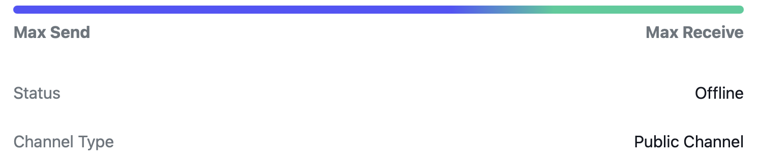

I’m a bit worried because the channel constantly shows ‘offline’ at both ends. Not sure what to do if anything?
You could try restarting the services to see if that helps. Simple test of the connection would be to create an invoice for a few sats on the CLN node, and see if you can pay it from the LND node. If that works, then we can test if the broader network can reach you (create a small invoice from your CLM node, say 100 sats, and send it to me and I’ll see if I’m able to pay it).

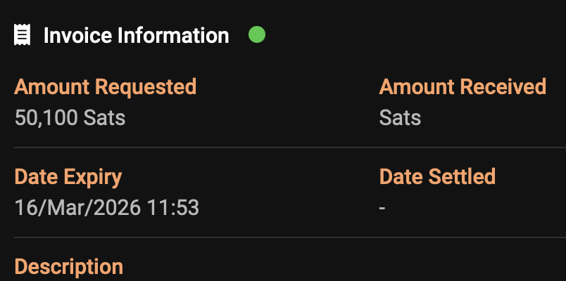

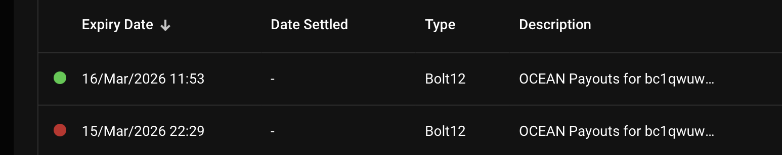

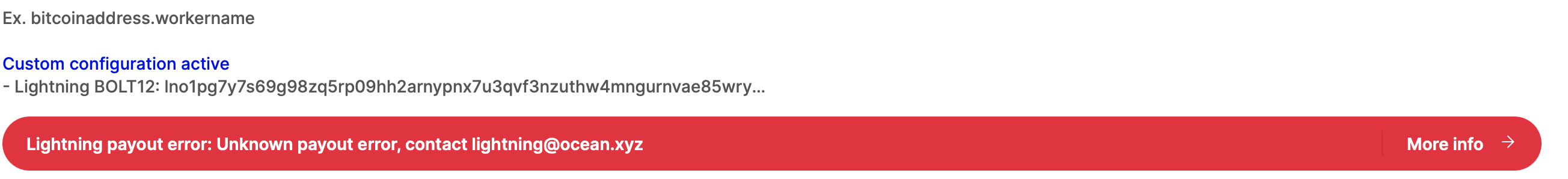

I couldn’t figure how to get the sats into my CLN Lightning wallet and then the offer timed out!
Could see it RTL but have no clue what action is required for the offer to be paid? Both the attached are snaps from RTL

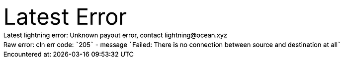

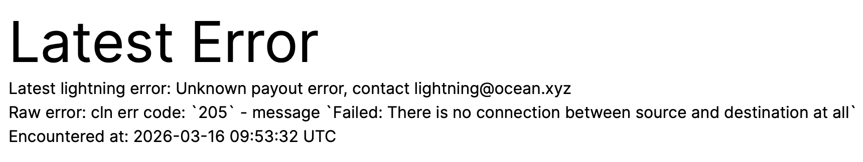

And… various error messages Ocean payout end…
Technically speaking, it is the individual invoices which expire, not the offer. They expire when they are not paid by some expiration date.

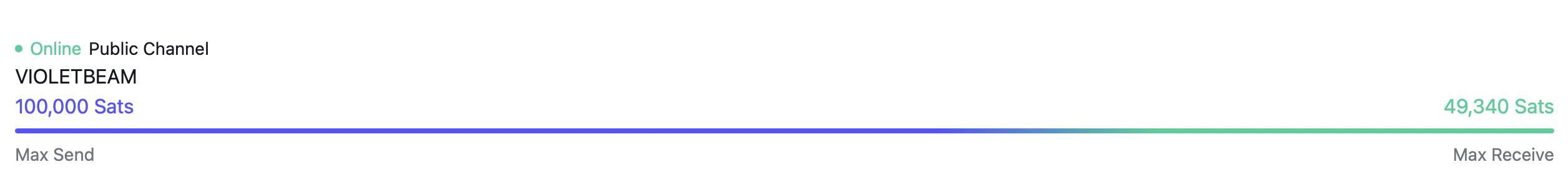

The interesting note is that Ocean reports no connection to your CLN node. The most likely cause for this that I can think of would be if you made the channel between your LND and CLN nodes a private channel instead of a public one (which would result in there not being any gossip data for Ocean to be able to construct a route) There is a way to add hints to normal lightning transactions when you want to use private channels, but I don’t know how to extend that capability to offers. I think you need public channels for offers to work.
If your channels are public already (and not private) then the next thing to look at would be liquidity. In the above example, you would need 50,100 sats of inbound liquidity into your LND node from the larger network, and 50,100 sats of inbound liquidity into your CLN node from the channel with the LND node. I couldn’t see what is the inbound/outbound ratio on your channels from any of the screenshots you posted. Could you let me know what those ratios are for each of your channels? You probably already understand this, but for reference, inbound means the sats are on your side of the channel, and outbound means the sats are on the other side of the channel.
Noted re the difference between the invoice and offer. I was helplessly watching this invoice expire!

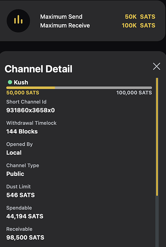

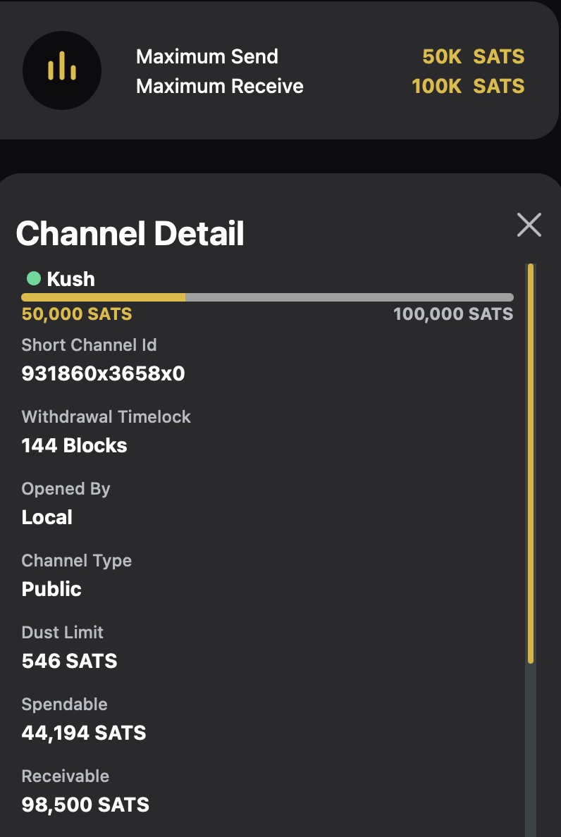

The channel is public with a total capacity of 150,000. I can see it’s as you’ve said, insufficient liquidity LND end? If I’m understanding it correctly, LND inbound is a few sats shy of the required 50,100. CLN end looks ok at 98,000 inbound?
Is it a case of send 50,000 out of LND?
Yes, that is definitely a problem. Send some sats out of that VIOLETBEAM chanel to open up more inbound liquidity. You’ll need a place to send to (another Lightning wallet, Boltz.exchange, Aqua or other Liquid wallet, etc). Then wait for Ocean to mine another block and see if the rewards come in this time.

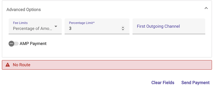

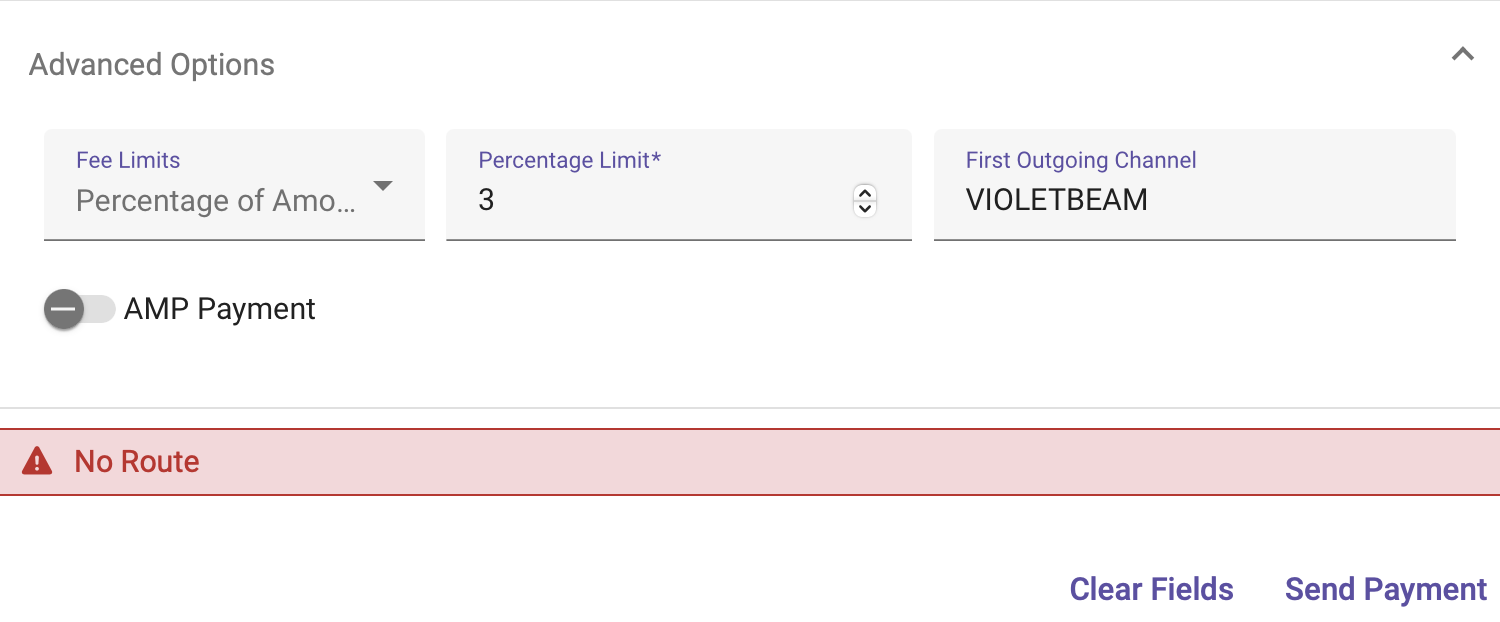

Well… I can’t find a route out of VioletBeam for neither love nor money! Tried sending 50k Lsats to Blockstream, then Aqua but ‘unable to send lightning payment: no_route’. Then tried 50k straight up sats to Blink but again ‘no_route’. Is it me?
Try increasing the maximum fee rate. 2% usually works, and 4% will definitely work if there is enough liquidity out of the node you have a channel with.

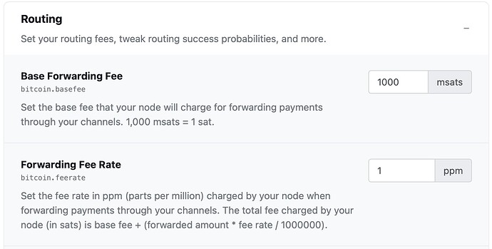

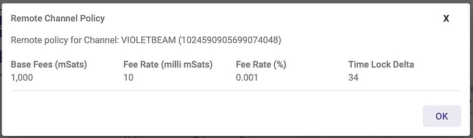

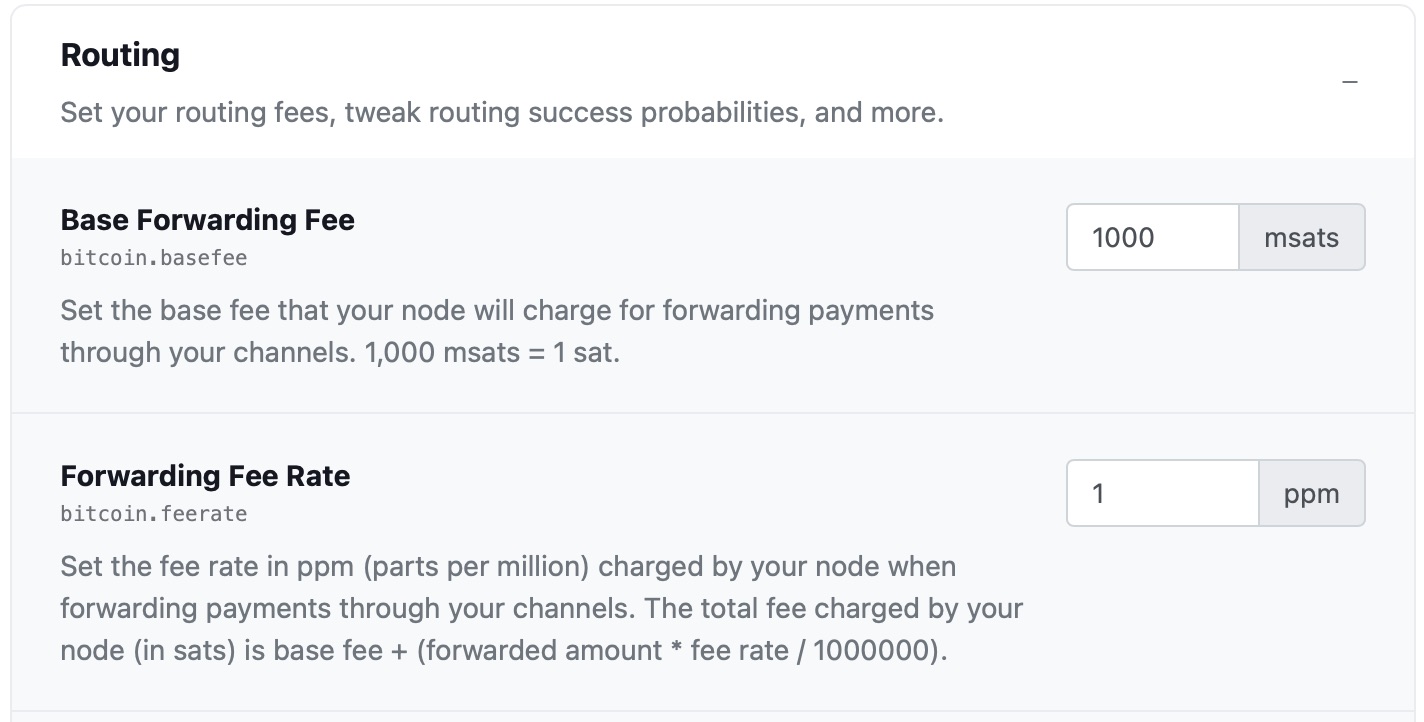

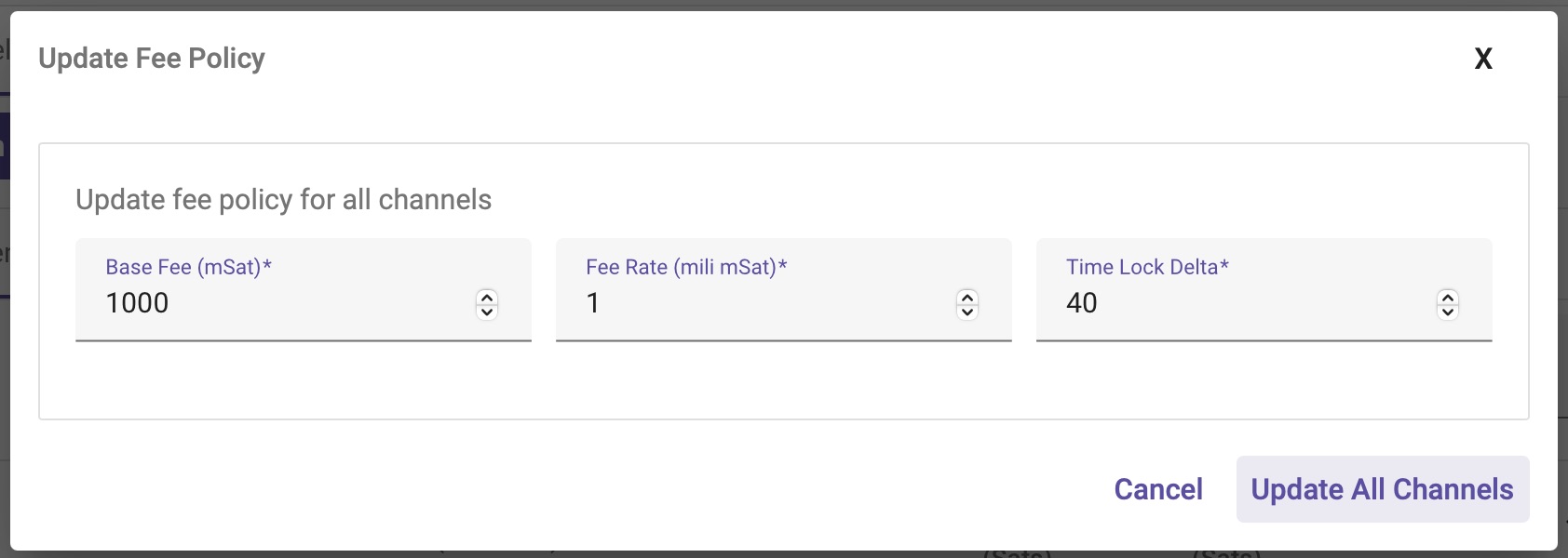

Wow and well… I found this on the LND under Advance Setting

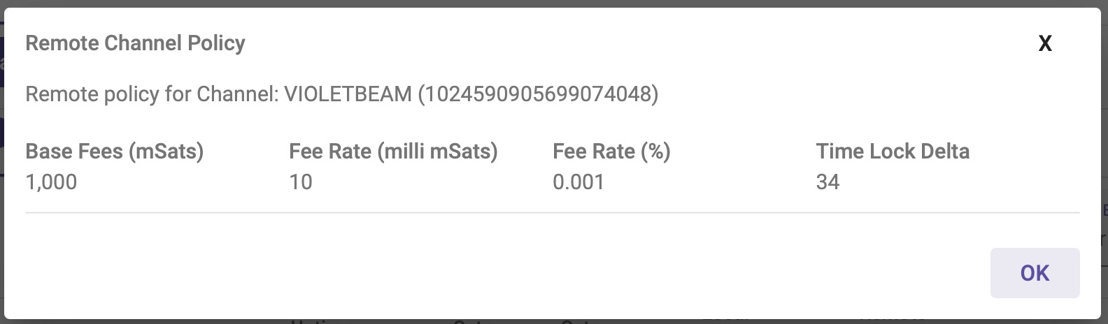

Then the current fee setting on RTL

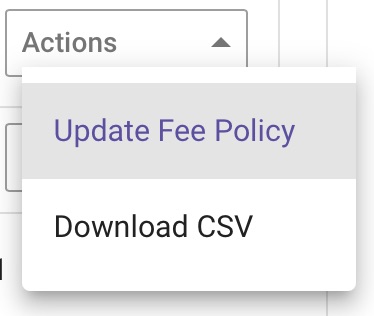

Then the option to update policy on RTL
And finally the actual options on RTL
Is this where I make the changes?

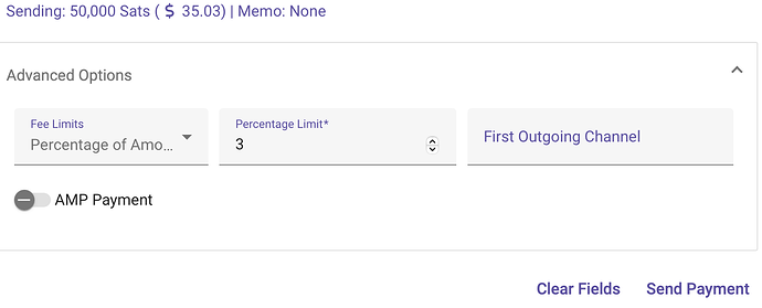

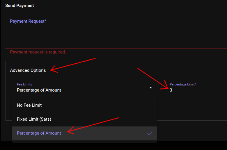

You should have an option when you are sending the sats, under the Advanced section:

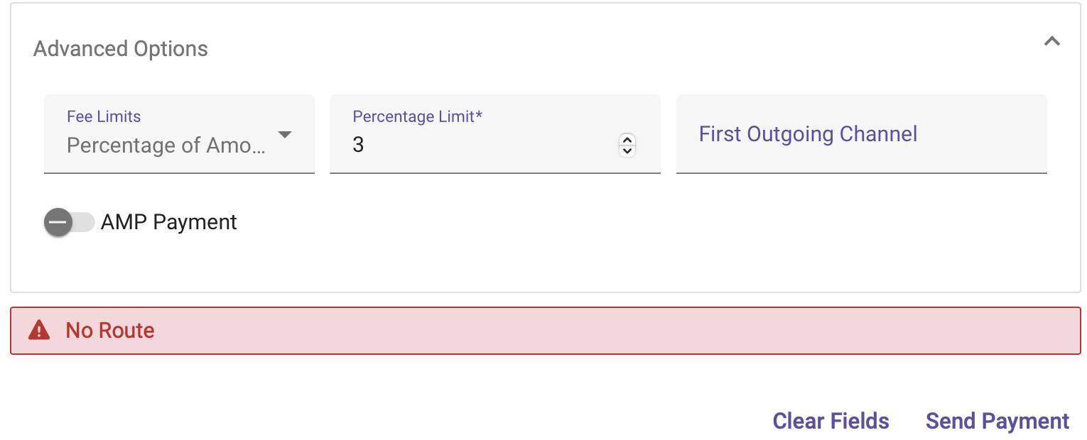

Found what looks like the option to send in RTL

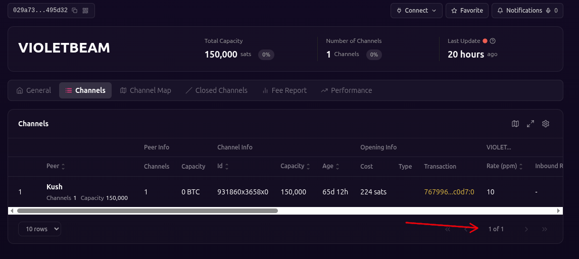

It looks like VIOLETBEAM has only one channel (with you), so there is no path in or out from the broader Lightning network if that is the only channel you have on LND.
Wait, Kush also only has one channel listed (with VIOLETBEAM). Is VIOLETBEAM your CLN node? If so, you will need to open another channel from your LND node with some other node which is well connected with other nodes on the network.
