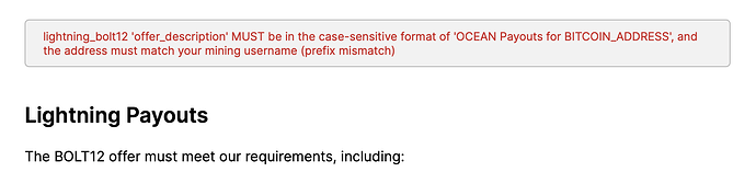

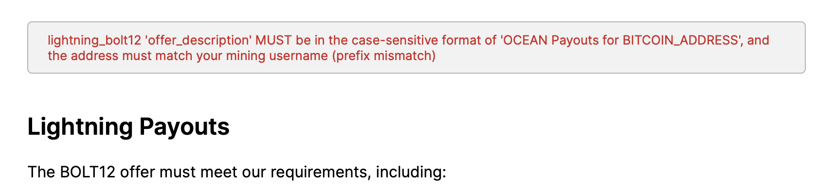

I’m trying to sign the offer generated from the CLN Lightning wallet via the Ride the Lightning interface for CLN but getting this error message
The format should be : OCEAN Payouts for “your Bitcoin address”

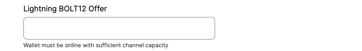

Should the CLN offer be copied here?
