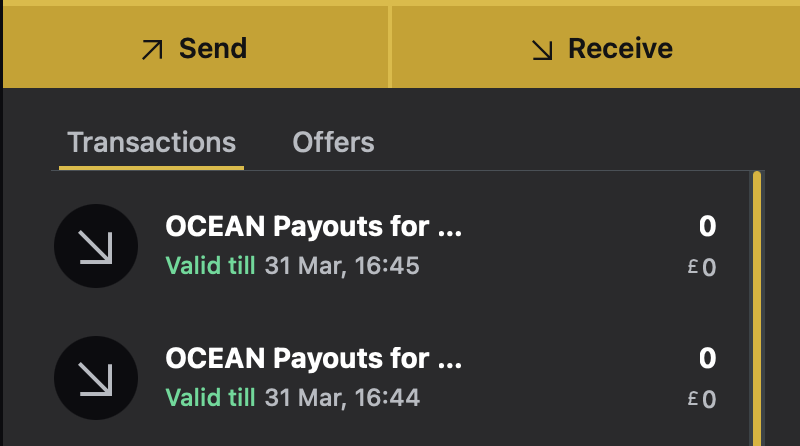

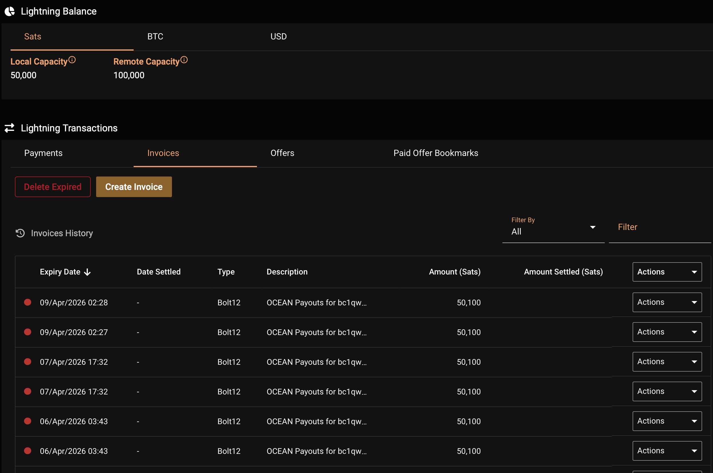

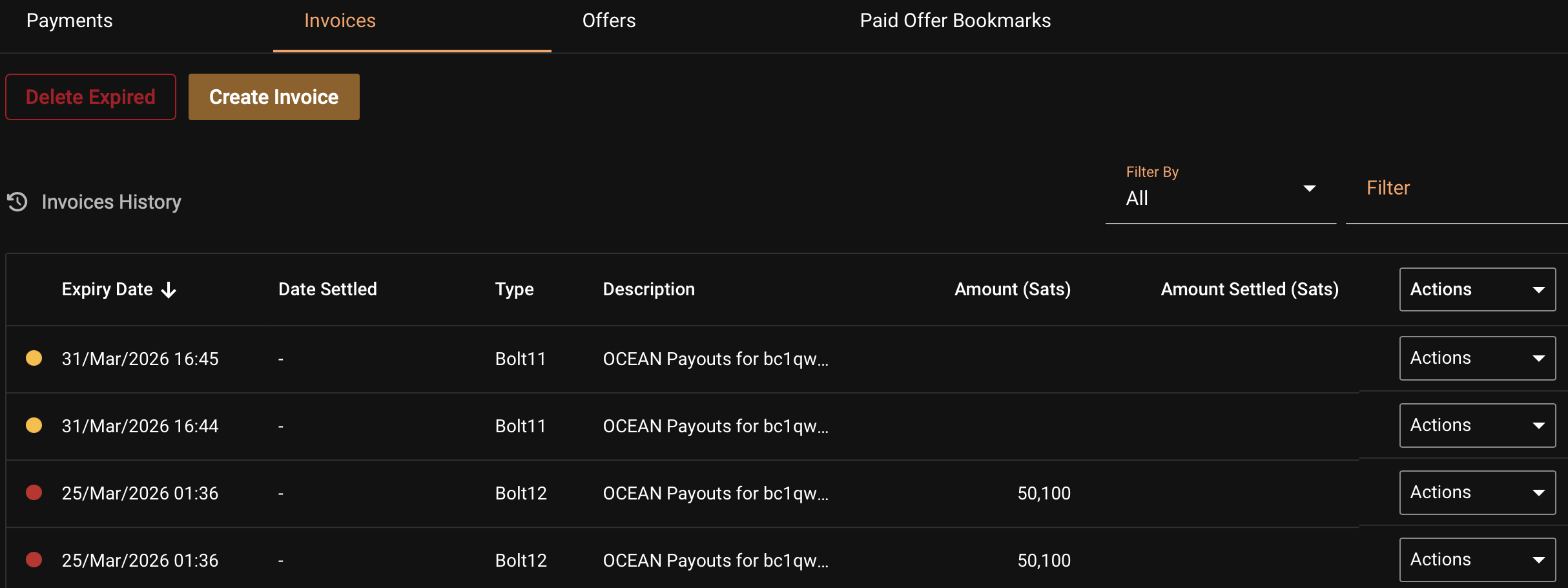

So… I jumped back in yesterday; created what I thought was a Bolt12 offer via CLN and signed via Sparrow. All appeared to be accepted Ocean end. However the following is showing on my CLN Lightning wallet:

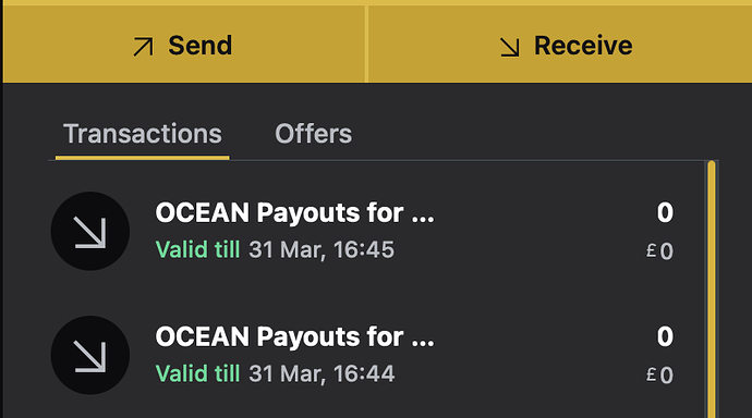

Along with this on RTL there is no sat value and it’s formatted as Bolt11

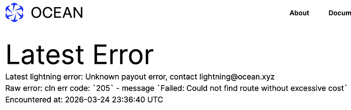

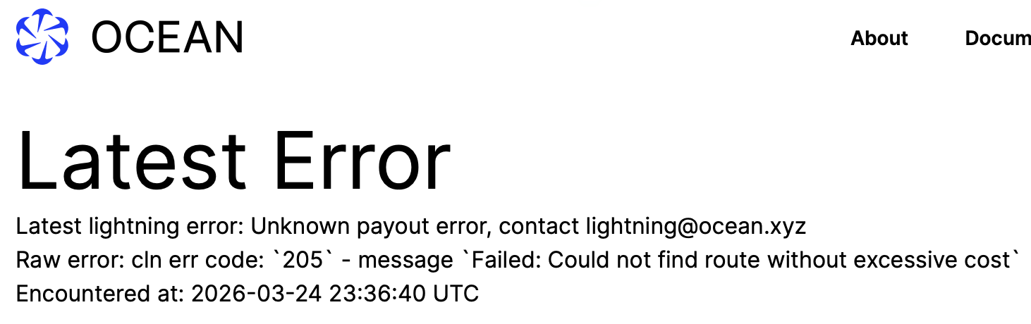

This is accompanied by the following error message on Ocean:
I’m guessing I’ve created the wrong offer type?
I don’t have RTL connected to my CLN node (I use it to manage my LND node, and it can only be pointed to one or the other), so not famialiar with the interface you are showing there. In any case, I’m not aware of different types of offers (and the Core Lightning UI only creates one type anyway). Bolt12 referrs to the update that implemented Offers, and Bolt11 refers to the update that implemented Invoices, LNURLs, etc. I don’t know what the “Type” column is referring to in that RTL interface TBH.

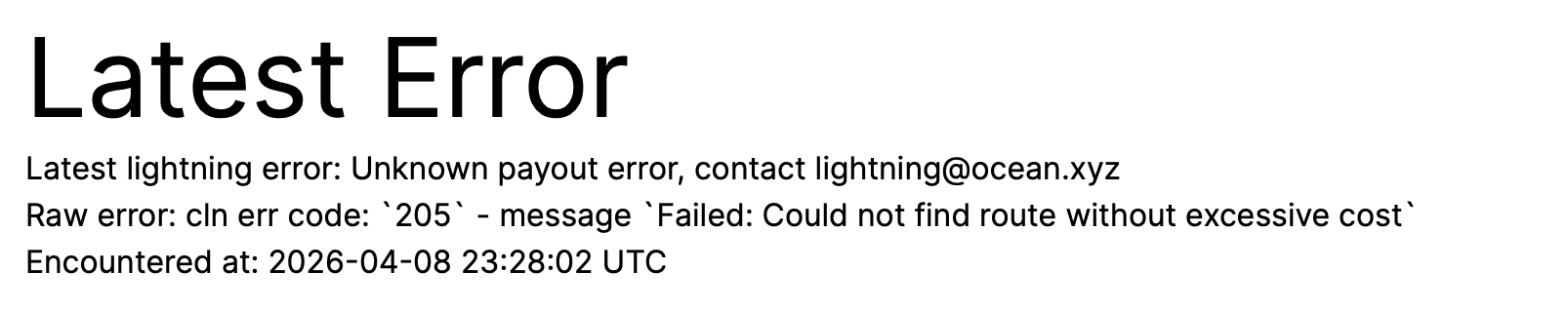

In any case, the error message in Ocean is fairly clear – no route could be found without excessive cost. I don’t know what logic Ocean applies to define “excessive”, but if it is based on number of sats (rather than percentage of transaction amount), then then maybe the fee rate on my node (1%) would trip it for larger payout amounts. Hopefully others on the forum have run across that message and have some insights into how they fixed it. I recall someone seeing this same error in Ocean a while back, but don’t recall if a solution was posted.

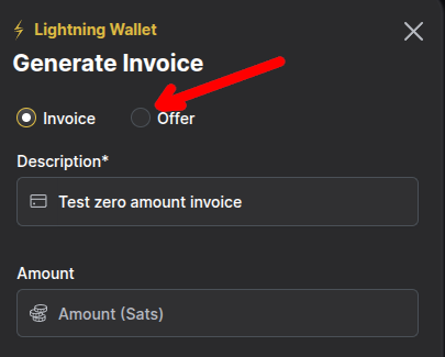

Actually, I just realized that in CLN you can create a zero-amount invoice (which would be Bolt11) if you accidentlly forgot to click on the Offer radio button:
This used to not be possible, but I just tested, and it generates a valid invoice (albeit a pointless one since one cannot technically “pay” zero sats). Perhaps you signed a zero-amount invoice instead of a zero-amount offer? I haven’t tried that before, but maybe Ocean doesn’t have a check for that. It would explain the different “Type” (since Bolt11 is related to Invoices, and Bolt12 is related to Offers)

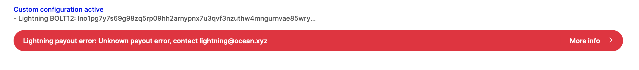

So… still no joy on my part.
Ocean messages

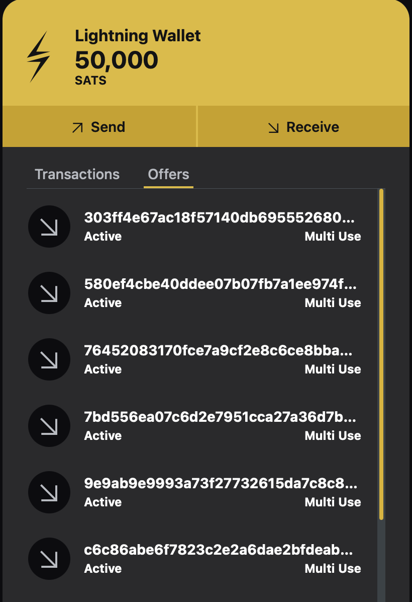

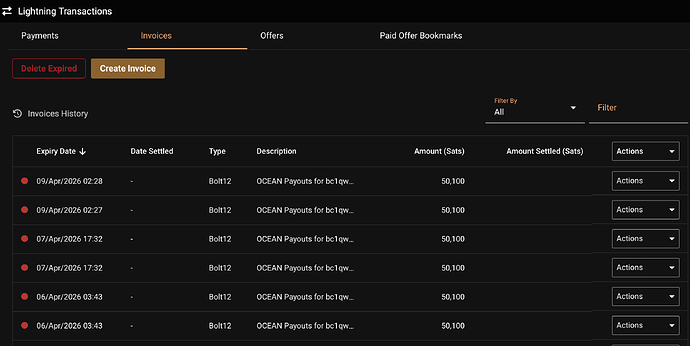

Got a number of active multi use offer pilling up on CLN

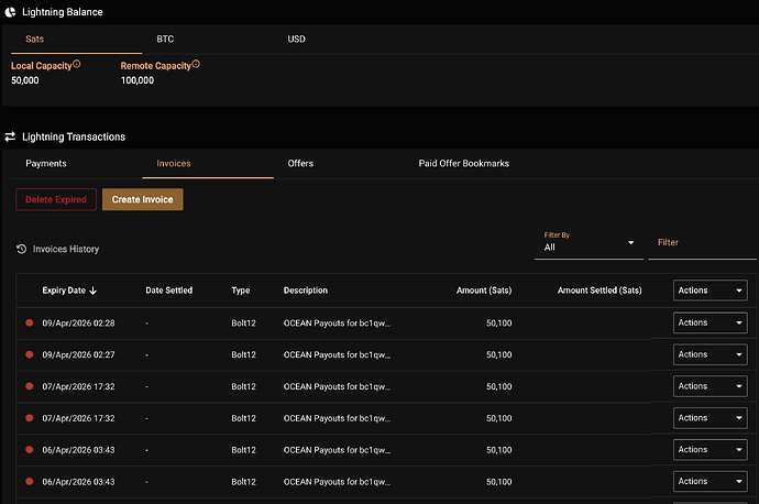

Along with numerous Bolt12 invoices mounting up on RTL. All appear to have the correct details but none are settled
:confused:

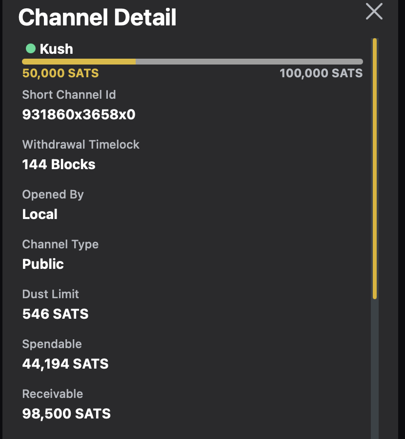

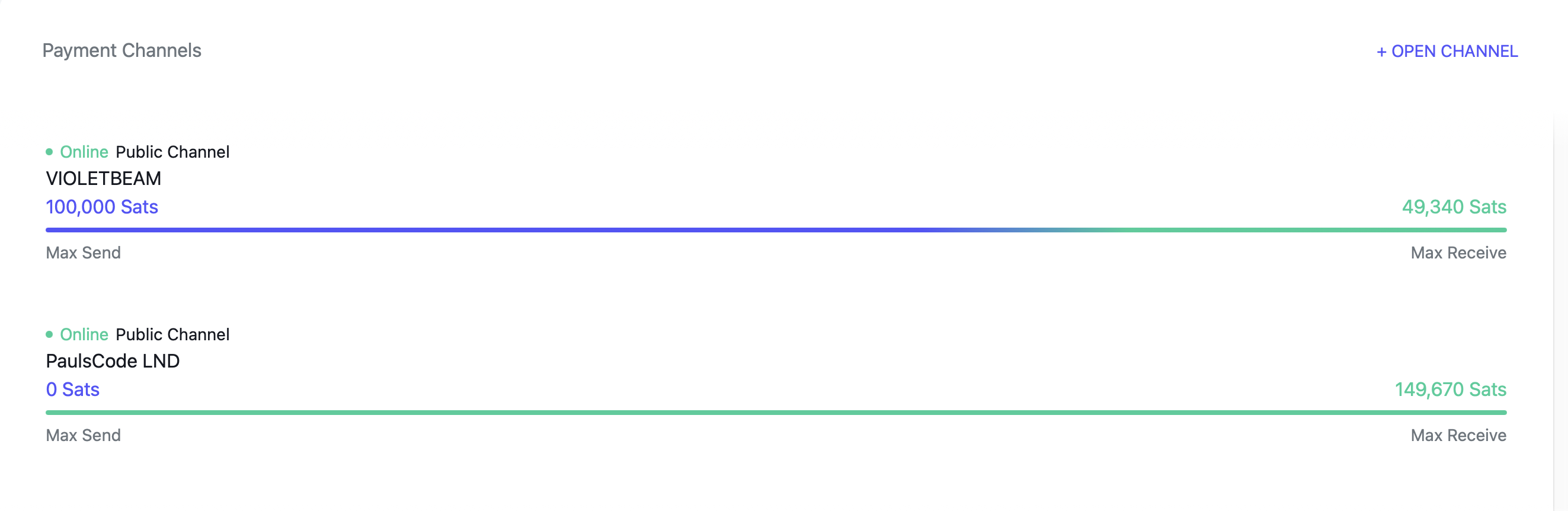

What are the liquidity numbers on your channels currently?
CLN
… and the 2 channels on LND
Should be plenty of room to receive the ~50k sats. I do see my lightning payouts (mine are much smaller, ~5K) have been failing since 3/27. Sometimes restarting my server seems to resolve that. I’ll do that later when I have some time.

After pointing a large amount of hash rate at my node with Braiins, I also now see the message “Failed: Could not find route without excessive cost”. My theory is that Ocean is using static fee thresholds rather than percentage thresholds. This would explain larger payouts failing the threshold, while lower payouts make it through.
To test this, I’ve temporarily lowered the fee rate on my node to see if the next payout goes through. If so, I may end up having to increase the minimum channel capacity on my node (since low minimum channel capacity coupled with low fee rate is too costly in base layer fees to manage)

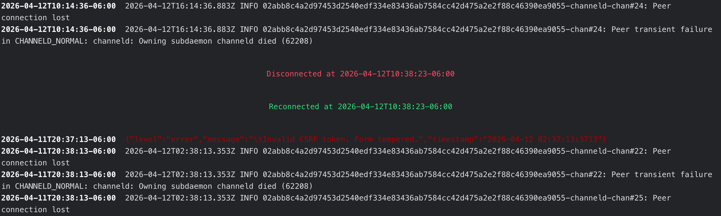

Although I have had large payment issues in the paste that were resolved via OCEAN’s routing I got a new one today. This one has to do directly with my node. Payout currently sits at 186396 sats.
Failed: could not route or connect directly to (My node ID): {“code”:401,“message”:"All addresses failed: Error connecting to (my node URI).onion: Tor server reply: TTL expired. (my node URI).onion:9735: Connection establishment: Connection refused. "}, data=map`
Encountered at: 2026-04-12 03:37:41 UTC
To check- I can still move sats from Core to Alby (LND). Going to have to ponder this further…
EDIT: Attached
This might explain the error from OCEAN although I cant match timestamps from the error vs the log? Date is correct but timestamp different.
NOPE: This is a repeating issue…currently the log shows that error 3 times since I posted it here. This particular post is irrelevant to the large payouts from OCEAN. I apologize.

Back when I first ask you about payouts exceeding my channels capacity you mentioned I could simply open another channel from LND to Core which I did. I have 3 channels totally 380,000 coming from LND. Cured the large payout issues. Could the fix be as simple as that other than fees? I’m sure I have the exact same setup as your channels as far as fees because I copied what you had suggested.
