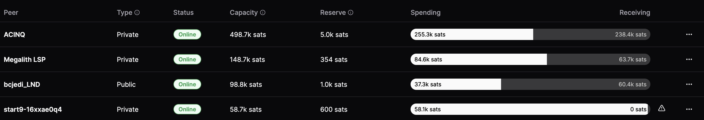

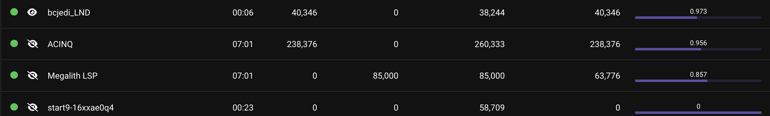

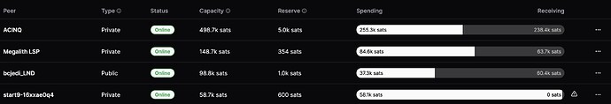

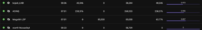

OK…rebalnced worked between ACINQ and Megalith LSP…both of which are private. It appears I might need to reopen both those channels to public…lightning challenge!!
@Fletcher …I tried smaller amounts…still no route with 10000 sats and 2%.
I’ll keep fleshing it out
\o/ great success \o/
Ok…I had to rebalanced once between ACINQ and Megalith. Then I rebalanced from bcjedi and Megalith a few time. Seem to work that way. Dont know how much it cost me but worked
Challenge complete…but dont ask me to explain it

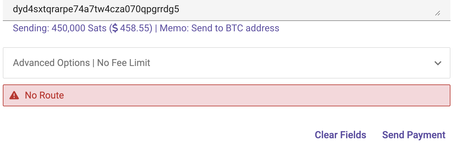

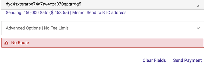

Hey Paul, I tried this all the way up to the last step, when I try to send sats from LND lbtc > btc using boltz, I get an error of no route being available. Is there anything I can do to fix this?
I have 1 channel with ACINQ (500k), and 1 channel with my CLN Node (60k)

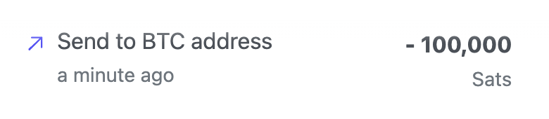

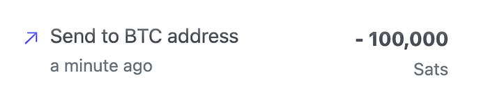

I would try breaking it into smaller chunks. Since you have just the one channel with ACINQ, it may be limiting the amount you can send through in one go. See if 100,000 sats will go through. If so, you can try a little larger next one (or just do it in 4-5 chunks, since you will probably be doing a UTXO consolidation at the end anyway) You may need to wait for a block to be mined if you start getting smaller limits after a couple chunks (to give the LSP a chance to rebalance)
Wow, worked like a charm! Ser… are you a magician or sumtinggg??? :laughing::joy:
TYSM :pray:
