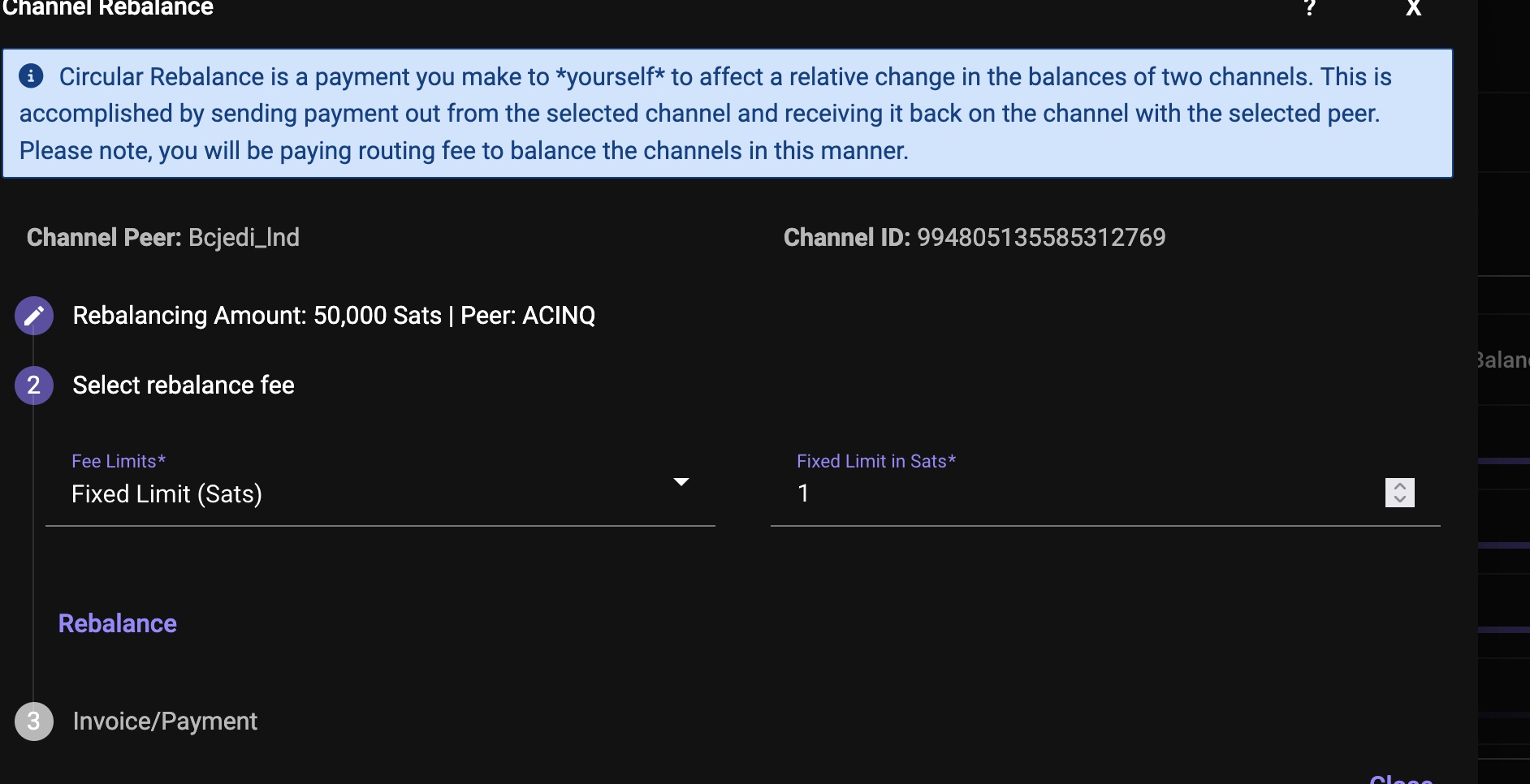

Ok..I tried this but doesn’t work as described but does appear it would work in reverse like so…
Check/verify
I didn’t execute yet…
I never know what is the correct direction (the terminology is ambiguous). My understanding is you take the channel which has the outbound liquidity that you want to move, and select Circular Rebalance on that one, and then for Receive From Peer you select another channel where you want to move the outbound liquidity to. In my explanation, the scenario was that Fletcher opened the channel to you. Perhaps it is different because you were the one who opened the channel?
Well…no harm in trying I guess. It’s not like the sats just go poof!

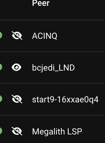

This a snippet of my channels…could it be that private thing again?
lnd
I think if you are doing the transaction, then you can use your own private channels (if someone else where doing the transaction, they could not since they don’t know about them). Did the one you had fail? That one (if I’m correct) should send sats out through the channel with Bcjeci_lnd and back in through the channel with ACINQ. The result would be that the Bcjeci_lnd channel would have more Inbound liquidity opened up, and ACINQ would have less.

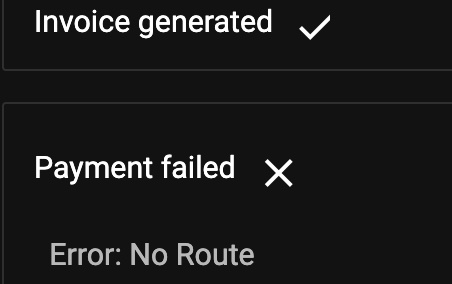

Yep…
noroute
Not sure TBH. I suppose there could be not enough liquidity somewhere in between to handle 50,000 sats (though that seems unlikely since it is such a small amount).
