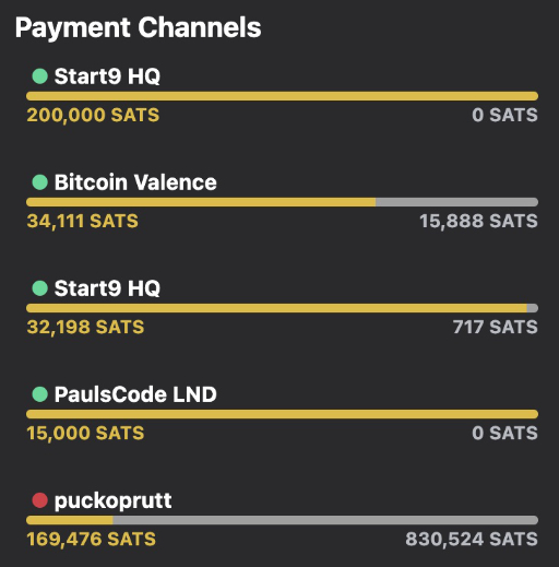

I opened up a liquidity swap (triangle) at lightningnetwork.plus with 2 nodes. One of the nodes is not staying up on a regular basis and I notice that my Lightning wallets balance goes down every time this node goes offline. As of today I see my wallet balance has dropped by 169,00 or so sats.
The question - If I close the channel with this node will I regain those 169,000 sats or do I lose them?

When you close a channel, you get the balance that is on your side of it (the outbound liquidity) deposited into your base-layer wallet for your Lightning node (minus fees). This balance does not appear immediately, though. If it is a mutual close (where both nodes are online and agree to close), then it should be unlocked within a couple of days. If it is a force-close (i.e. you close the channel because the other node is offline) then you will need to wait several days before it gets unlocked. This is meant to give the other node some time to create a dispute transation in the case where you were trying to cheat them.
Personnally, I wouldn’t mess with liquidity triangles. They were necessary prior to submarine swaps and Boltz.exchange becoming ubiquidous, but now-a-days, just open channels with good, high-uptime, reputable nodes, and use Boltz.exchange when you need to swap some of your outbound liquidity for inbound and move your sats to cold storage.
