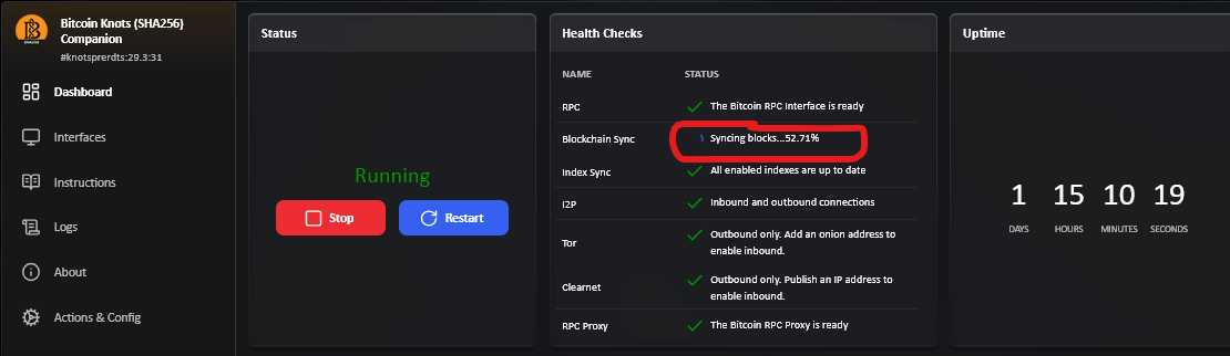

Does this look about right? Any way to accelerate or do I just need to adjust my expectations? :slight_smile: I need this for a Sparrow hot wallet (following previous advice on how to replay protect sha256 stack → Running Knots Blake2b on Start9 but need to replay protect cold storage bitcoin - #17 by paul ) and my understanding is I need wait for Knots Companion to sync, Electrs Pruned to index before I can go any further. I’ve already sent the test transaction, just waiting for hot wallet setup.
Thanks for any ideas on acceleration.
Yes. If you want to use Electrs on one of my test servers in the mean time while you are waiting for the IBD and indexing to finish, I can send you an onion endpoint that you can use in Sparrow.
That would so great. Thank you.
I DM’d one to you that you can try.

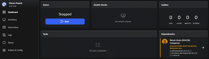

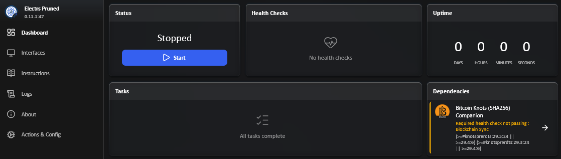

So installed the apps, synced. When imported wallet got this. Could this be because this is Taproot wallet?
Make sure Electrs Pruned is pointing at “Bitcoin Knots (BLAKE2b) Companion” (not “Bitcoin Knots”). Actions & Config > Select Node. Then also make sure Shrike is pointed at Electrs Pruned (not Electrs or Fulcrum).
What exact step-by-step process did you use to import the wallet?
I installed both app at the same time, then uninstall the Electrs Pruned as the Bitcoin Knots was not synced. Waited next day till it finished. Install Electrs Pruned again, pointed Srike to Pruned, imported wallets and that was the result. In Electrs Pruned there is no option to choose nothing else, there is only Bitcoin Knots. When I click on the rolling arrow, does not open.
The problem is that it is pointed at the main slot in Start9 (where you are running Bitcoin Core), and not at the Companion slot (where you are running Bitcoin Knots (BLAKE2b) Companion). What options are in that dropdown for Select Node? Maybe try clearing the browser cache and a hard refresh.
BTW, you will need to completely re-index Electrs Pruned, since it is synced to the SHA256 chain. Probably the cleanest way to fix this is to uninstall Electrs Pruned completely, then reinstall it. Do not start it until you have been able to successfully select “Bitcoin Knots (BLAKE2b) Companion” in the Select Node dropdown.
