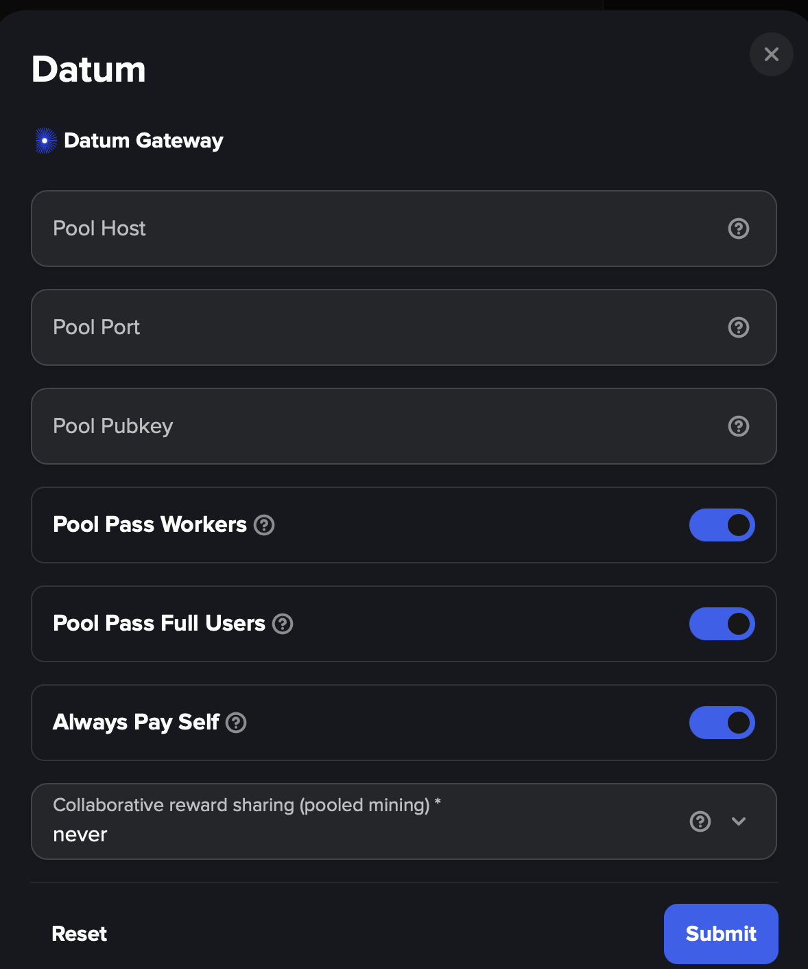

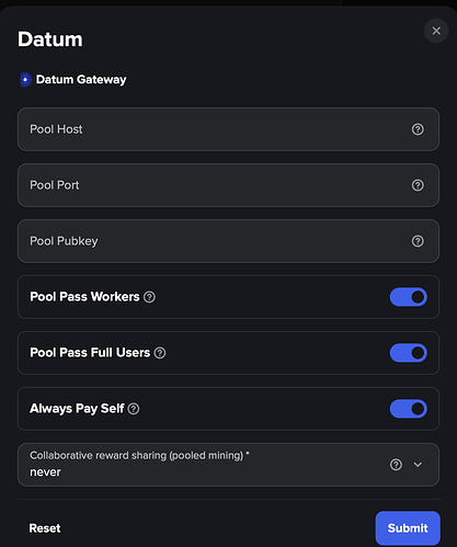

Thanks. I already did that but still not reporting hash on Datum. I’m not sure what I’m doing wrong. I sideloaded the updates to both Knot and Datum, and pointed my miners at my stratum port.
Did you update it to solo mine? If it is configured to connect with Ocean, it won’t work.
Also, make sure you are using the correct Stratum port in your ASIC settings (it is different than the one my build uses)
And also make sure Knots has fully synced. It should sync pretty quickly, but if it is taking a while for any reason, then this also would prevent Datum from serving block templates.
I just removed pool port and pubkey, had host removed before as well as having the collaborative mining set to never. Hopefully clearing those two will now work. I’ll keep you updated. Really appreciate the help !
I think collaborative mining never is the only one you need from that list. Probably the next thing is making sure the node is fully synced. Unfortunately, that isn’t so simple without Mempool.

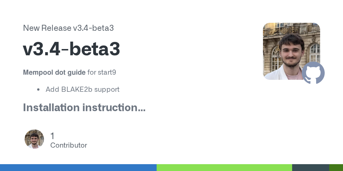

Oh, Retropex has a compatible Mempool explorer – that would be faster than using mine (since it doesn’t need electrs, so no need to wait on it to sync)
Retropex seems to have taken a very similar path that I did (though mine was focused on supporting pruned nodes, not just full nodes). I’ve gotten a little bit further than him, though – he has an electrs fork, but no releases published yet. And I don’t think he has a Sparrow fork started yet (assuming he plans to).
–EDIT-- I take that back – Start9 makes you pick the indexer. However, I just selected electrs and have electrs stopped. Mempool still starts up and shows the blocks. Worth a try to make sure you are seeing the blake2b blocks syncing in.
alright i’m downloading the updated mempool now and will get the electrs pruned off your registry ust in case it doesn’t work . lets see hope i can get this working tonight to have my miner working through the night
