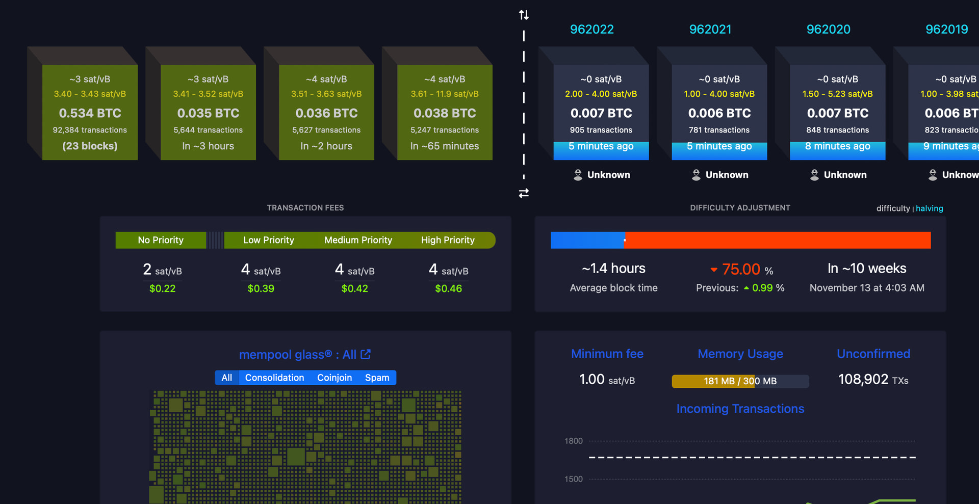

Then Start “Mempool Guide” (that’s how it shows up in the services list). Give it a couple minutes, then launch the UI. Wait a few more minutes for the cache to start. Once the blocks stop animating, check if it is showing blake2b blocks (meaning it is syncing the new chain) or if it is stuck on the newspaper blocks from the BIP-110 chain.

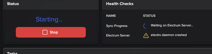

mempool has been working and synced for me for a while now. even though my electr has not been running properly since updating knots today

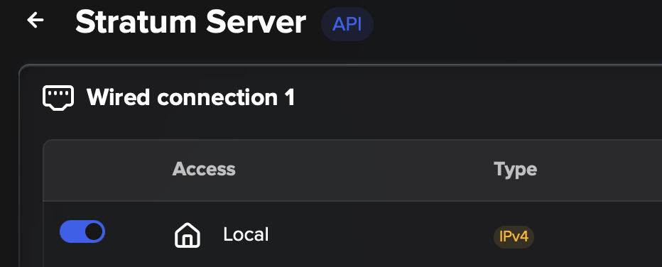

Ok, I see one difference in the Interfaces section on Retropex’s Datum Gateway. He doesn’t add the “stratum+tcp://” to the beginning of the local IPv4 stratum interface (he just starts with the IP address). Some ASICs require this at the beginning, so you might check if adding it helps.

I got the Retropex mempool and shows the current blocks vs mempool.guide, but it doesn’t populate the miner tag. Is that normal?
Yes, I see that as well. It may be a bug in Retropex’s fork (though I’m still syncing my fork, so mine may have the same problem once it is finished, haha)
