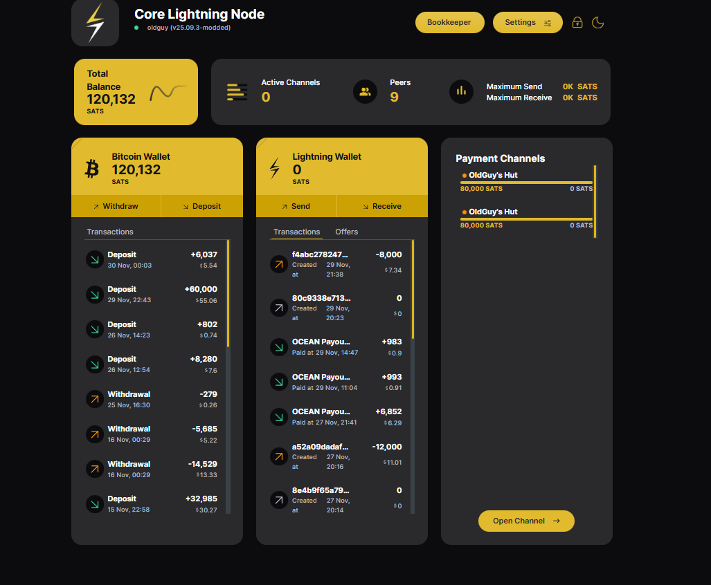

I have two Core Lightning channels that failed to work and now I can’t remove them because they r inactive. Can u tell me how to remove them they r only channels on my CLN node.
Thanks Wayne
Thanks Wayne
Is the status color on them red or orange? If it is red, then it means the node on the other end of the channel is offline. The CLN Application UI does not support unilaterally closing a channel when the partner is offline. It can be done by SSH’ing into your sever and running some commands inside the core lightning container. Let me know if that is the route you want to try, otherwise you will need to wait for them to come online so you can do a mutual channel closure.
They r orange and to my running LND node. I may have hit it twice thinking the first one didn’t take. They say pending on both nodes but it’s been going on two days.

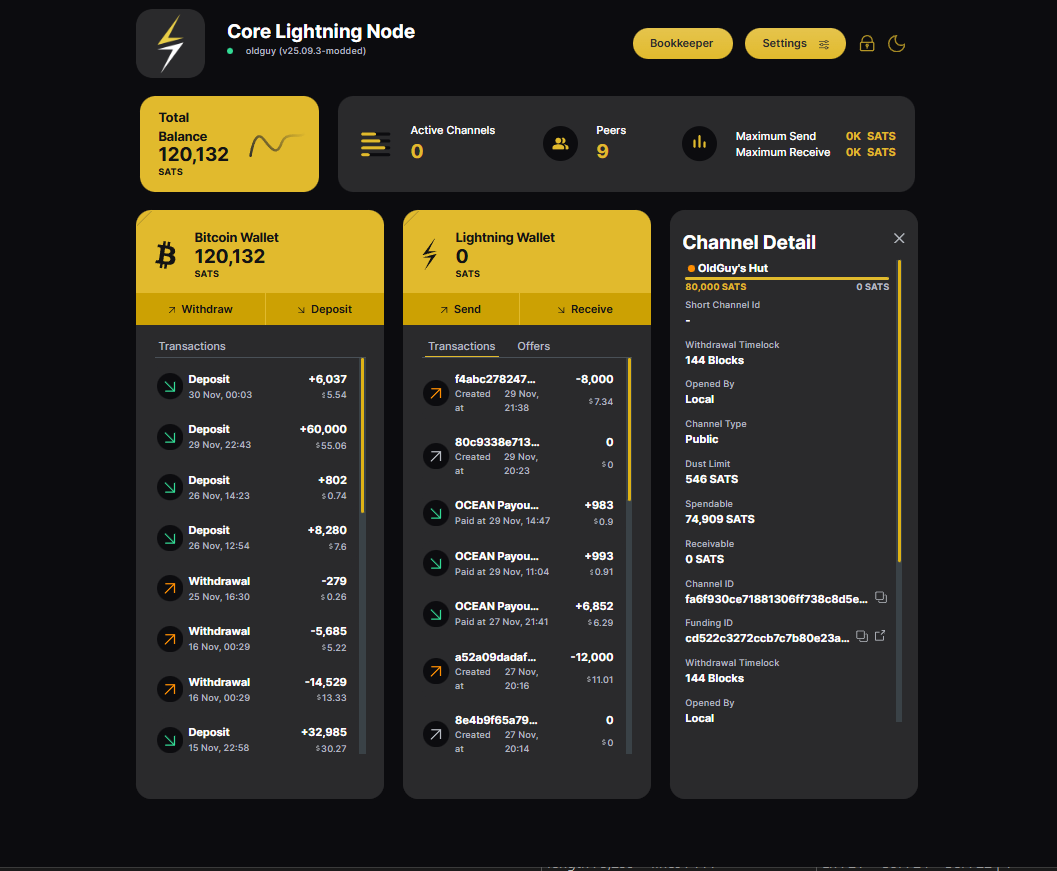

Click on the channel, and copy the funding ID. Search for that in Mempool, and see where it is at.
I want to https://mempool.space/ and dropped both ID’s it said not found.

The funding ID shows up here in your screenshot:
Or did you mean that in the Mempool service, that transaction ID is not found?

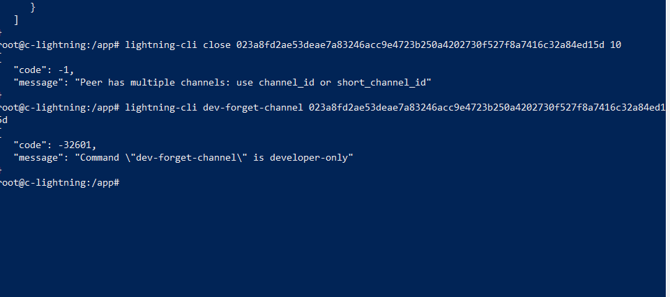

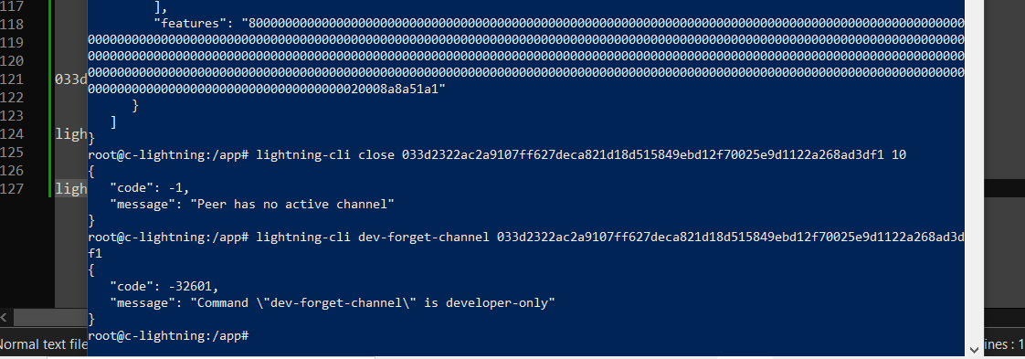

Step 5
Trigger a unilateral close with a timeout of 10 seconds (replace with your actual peer ID from step 4)
lightning-cli close 1234567890abcdef 10
Step 6 (after waiting at least 10 seconds)
Forget about the stuck peer (replace with your actual peer ID from step 4)
lightning-cli dev-forget-channel 1234567890abcdef
If you make it this far, let me know how the UI looks. I’m actually not entirely sure about steps 5 and 6 working, because normally you would use the short channel ID for those commands (I’m hoping the peer ID works instead for these) From the variable name they used in the documentation, I think this should be supported.
Darn. Looks like neither of the last two commands worked. After restarting, I assume the two zombie channels are still there?
There was a block that showed two in it but top one said 0 channel. The second one in that block said 2 but I used top one. I will redo it and use other one.
