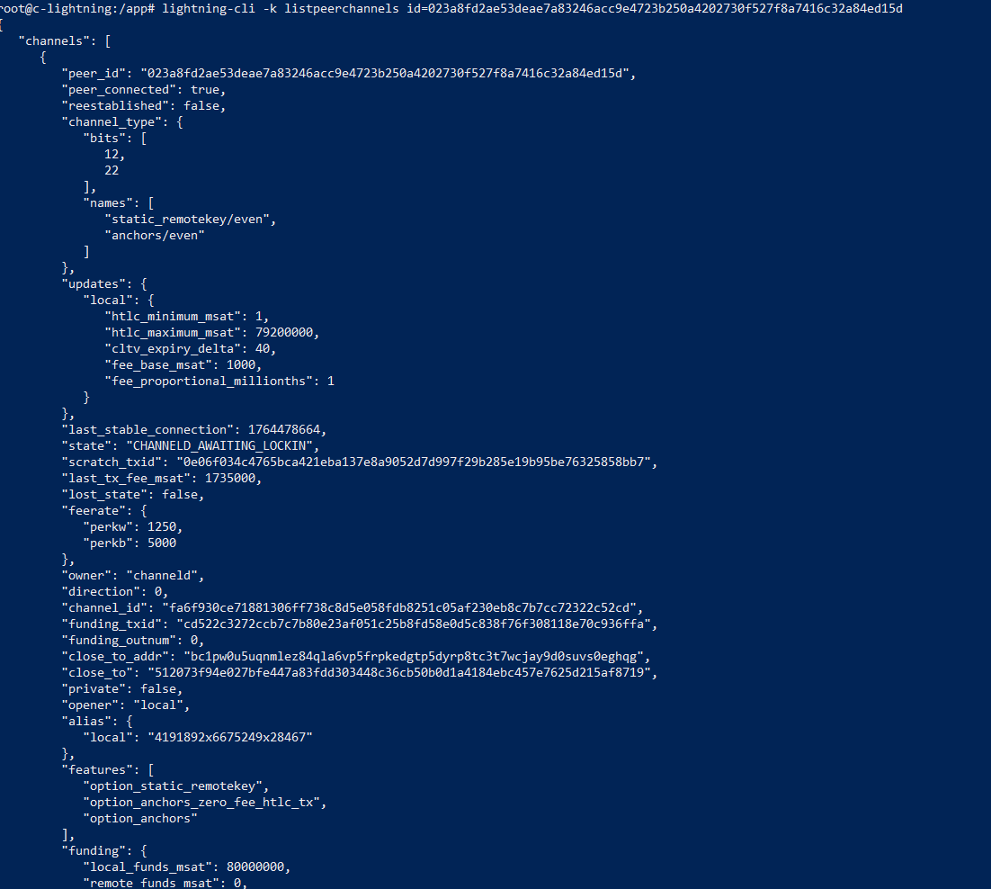

It looks like the “close” command won’t work with the peer ID since there are multiple channels. I know the short channel ID is missing in the UI, but if you run this (replacing the peer ID with the one that has channels):
lightning-cli -k listpeerchannels id=1234567890abcdef
Do you see anything in the output for either “channel_id” or “short_channel_id”? If so, try using one of those in the lightning-cli close 1234567890abcdef 10 command (replacing the ID with either of those two values if they were in the output).

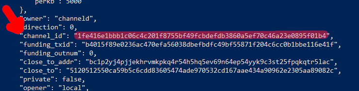

The clip I sent u that u added the red arrow and reposted it has a channel id, they both have them or do I need to redo that whole process and use step 4 to get it?

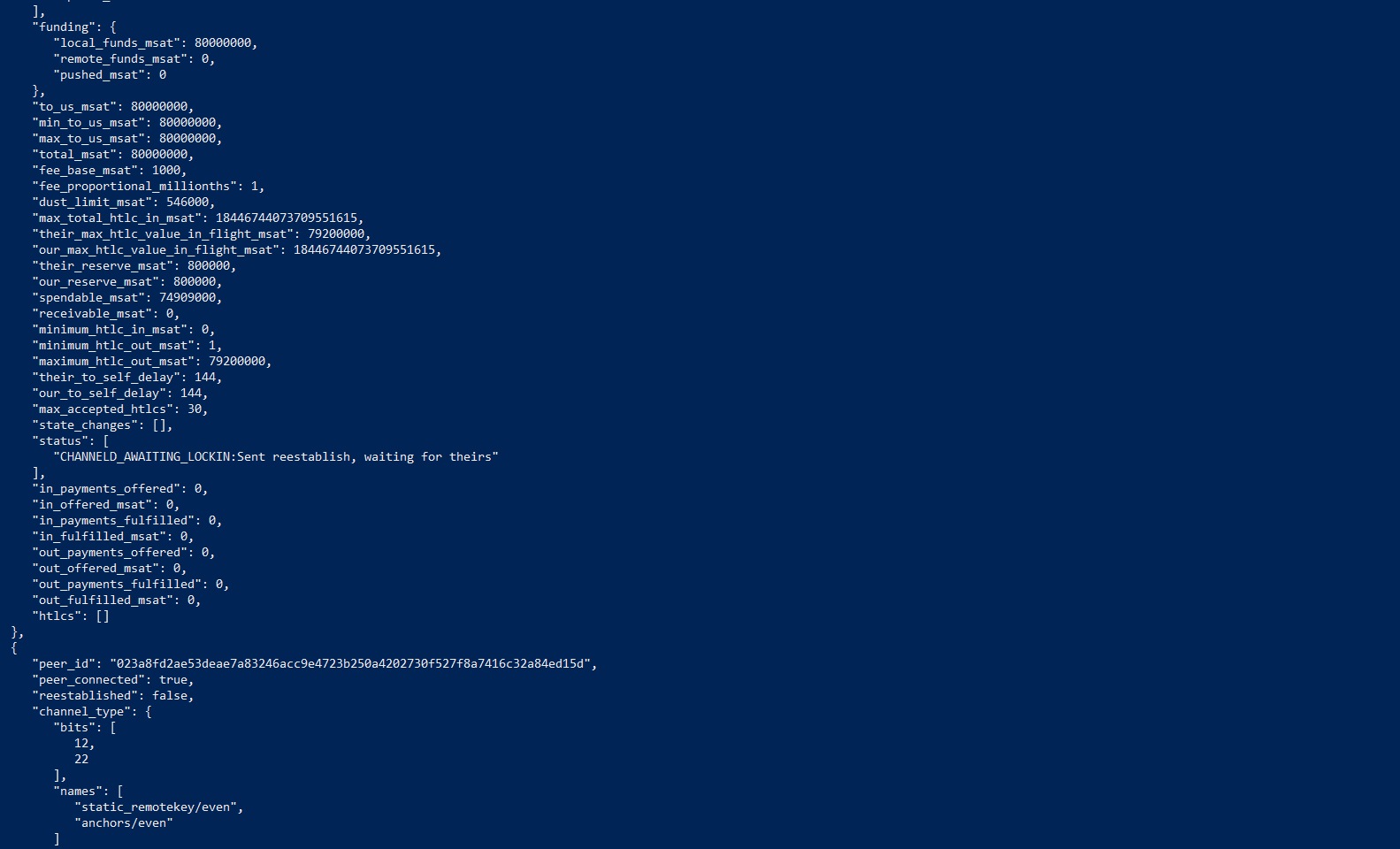

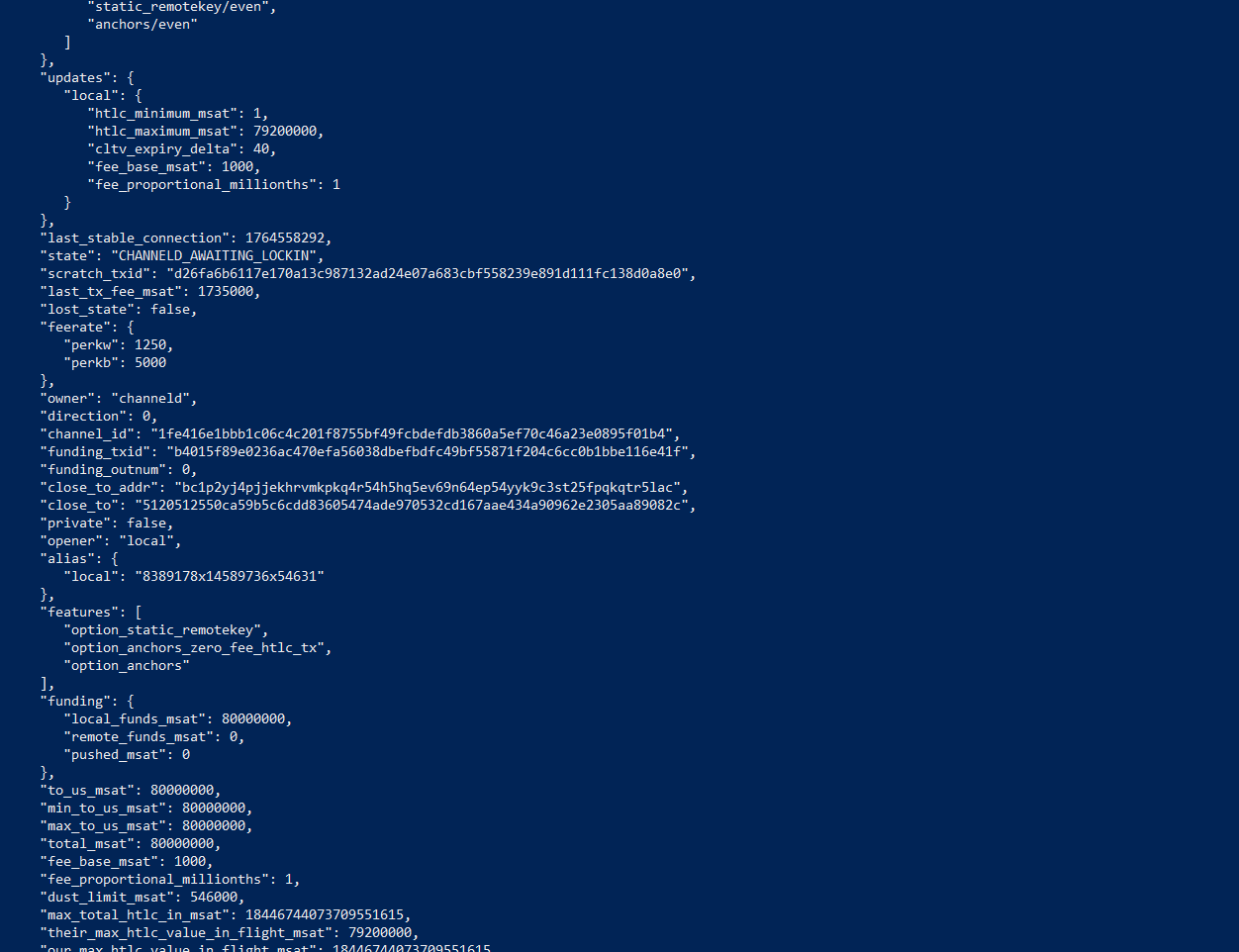

This is what I got.

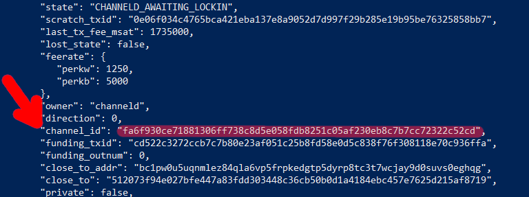

Cool, from there I can see the two channel IDs:
and:
Copy each of those and replace them into the close command:

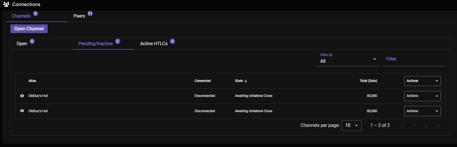

Hello Paul well I waited awhile and the LND closed the channel pending it said no funding as reason. At the CLN it shows the 2 channel still as pending. I redone the channel deletes as before but it said no channel with them ID’S found. When I check it still says waiting for unilateral close. Let me know if u find any info.
