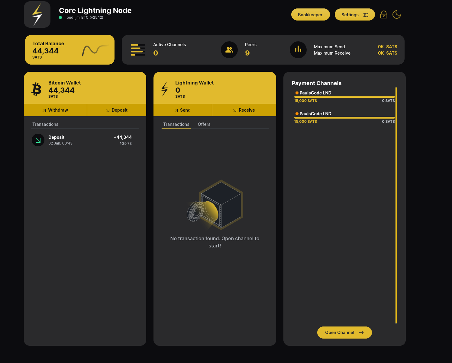

I try to open a channel with you Paul but my CLN still stuck on pending with 9peers confirmed. I can’t find my funded transaction in mempool.
What can I do to unstuck on pending status?
The number of peers listed is a red herring.

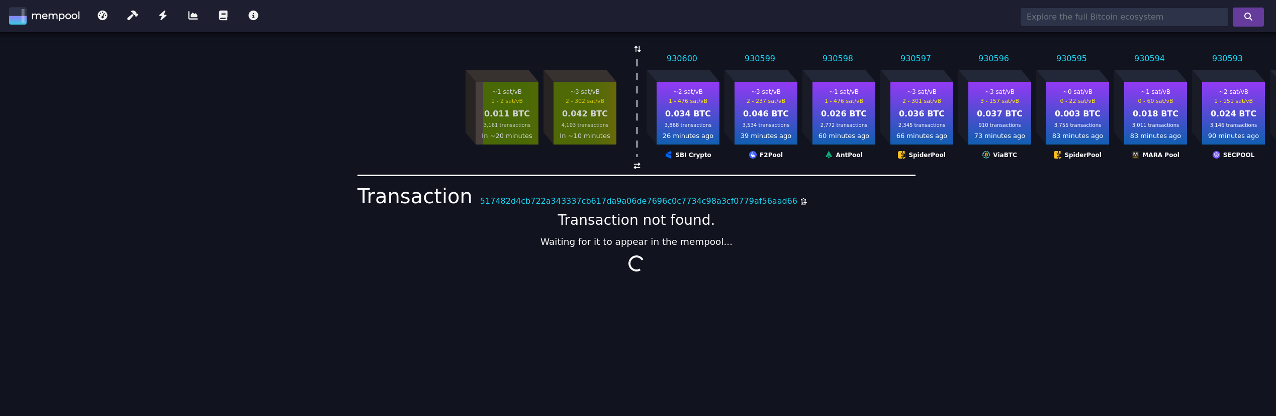

Check if the transaction has been broadcasted to the network, and if so has it been mined yet. Open the channel detals, and copy the value from “Funding ID”. Paste that into Mempool to look up the transaction.
Hi Paul,

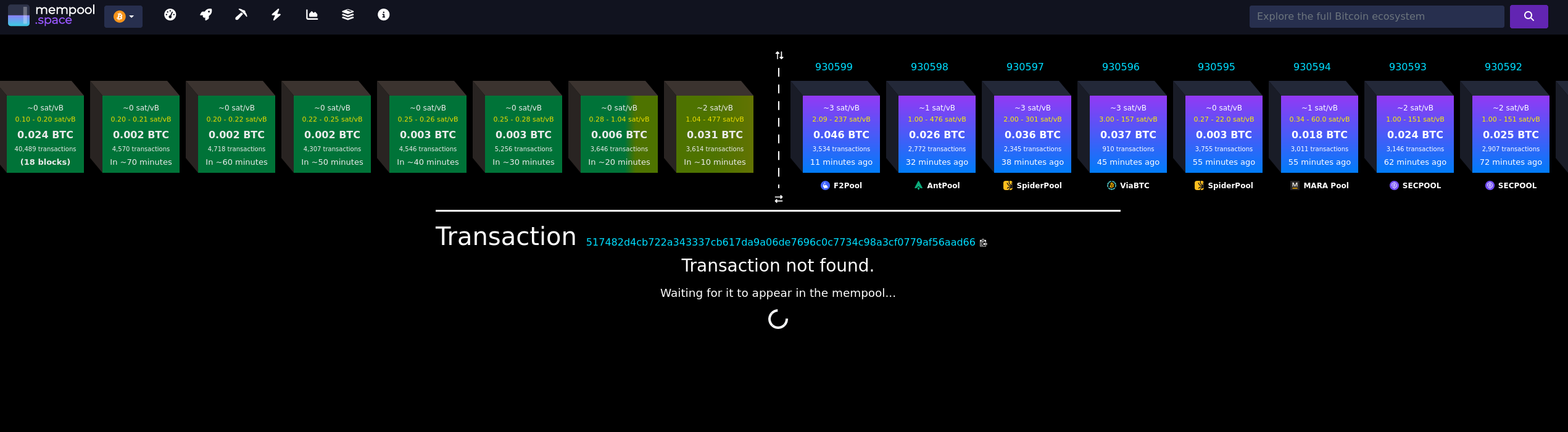

I did check with the mempool but there is no transaction found in the pool.
Do you get the same if you check with the Mempool service (as opposed to mempool.space)?

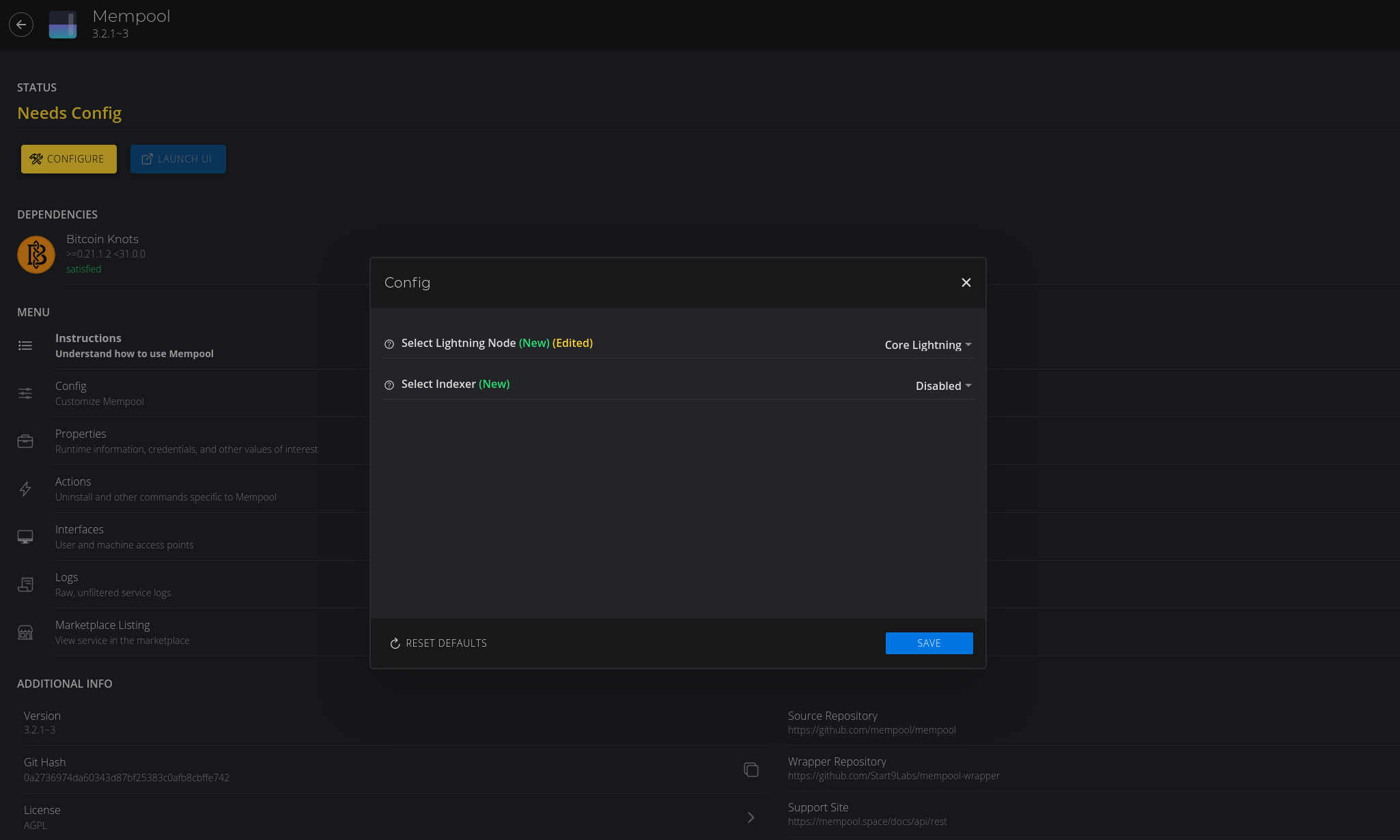

You can install the Mempool service via the Start9 registry (same place you installed Core Lightning from).
Ok, I hope the configuration is correct.
