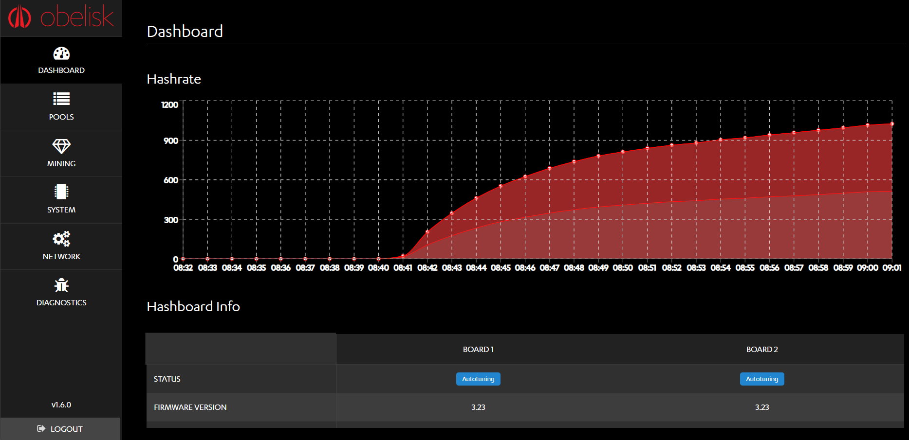

Spins up and Hashrate on Obelisk Dashboard climbs but not on Datum Gateway Dashbord

And I did the same and the miner was hasning as expected on this pool climbing to about 950 Gh/s

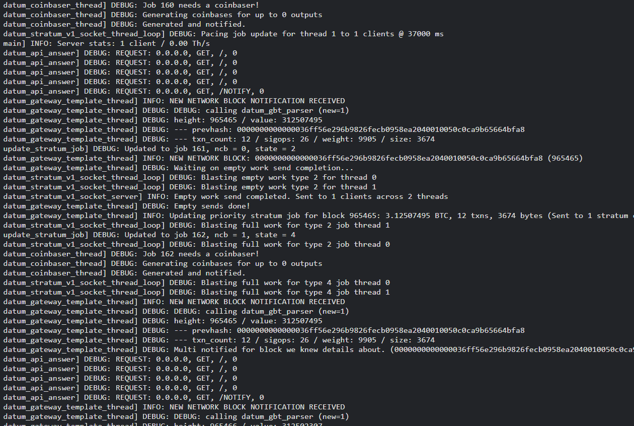

I then updated to mine (solo) on my Start9 setup, but the same result as previous, Datum showed 1 client connected but no hashrate. I tested for about 1 hour with no changes.
On the Datum config I tried with and without Allow hasher time rolling for BLAKE2b jobs
A extract from the Datum log
