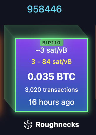

Loaded the Mempool BIP-110 visualiser and forwarded a link for HashGG to a chap who may find it useful.
