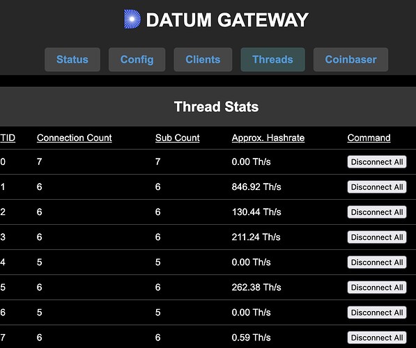

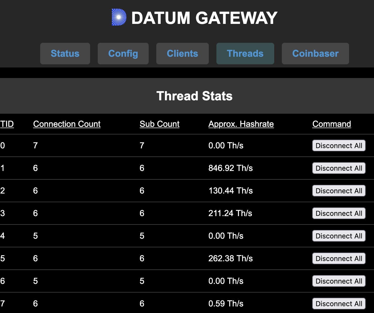

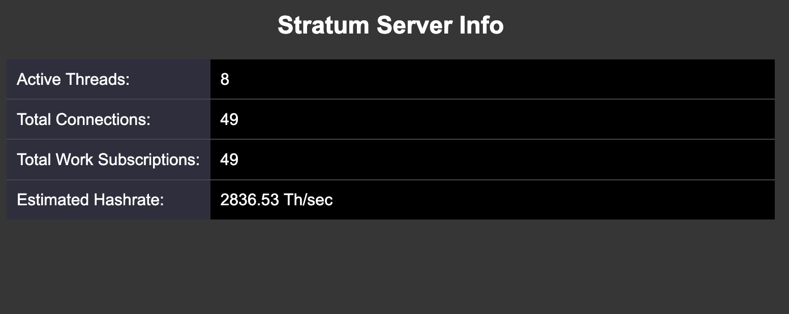

I got other things going on right now but as a aside I noticed when I turned 1Ph/s at my Datum server the total clients shot up to 49. Braiins must be supplying virtual hash thus all the clients?
Update:
So far renting hash is working at very well. For every 50,000 sats (24hrs at 1 P/h) I spend I get back roughly about a 26% increase in payouts (50,000+26%). Normally there is 10-16 blocks in the Window. No machine cost, no electric cost. Actually 'no cost" sats in return.
I’d like a little advice on how to look at this. Why so many clients? Is the gateway reading the AI generated hashing individually?
I’m not familiar with the term virtual hash, so I can’t comment on that point. I assume their workers are divided and organized in some manner (maybe by physical ASIC, for example) to help with their internal metrics, allocations, and scheduling. If they have different worker names as part of that system, that would show up as multiple clients. You could check the Clients section to see if that hypothesis holds.
