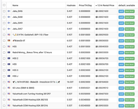

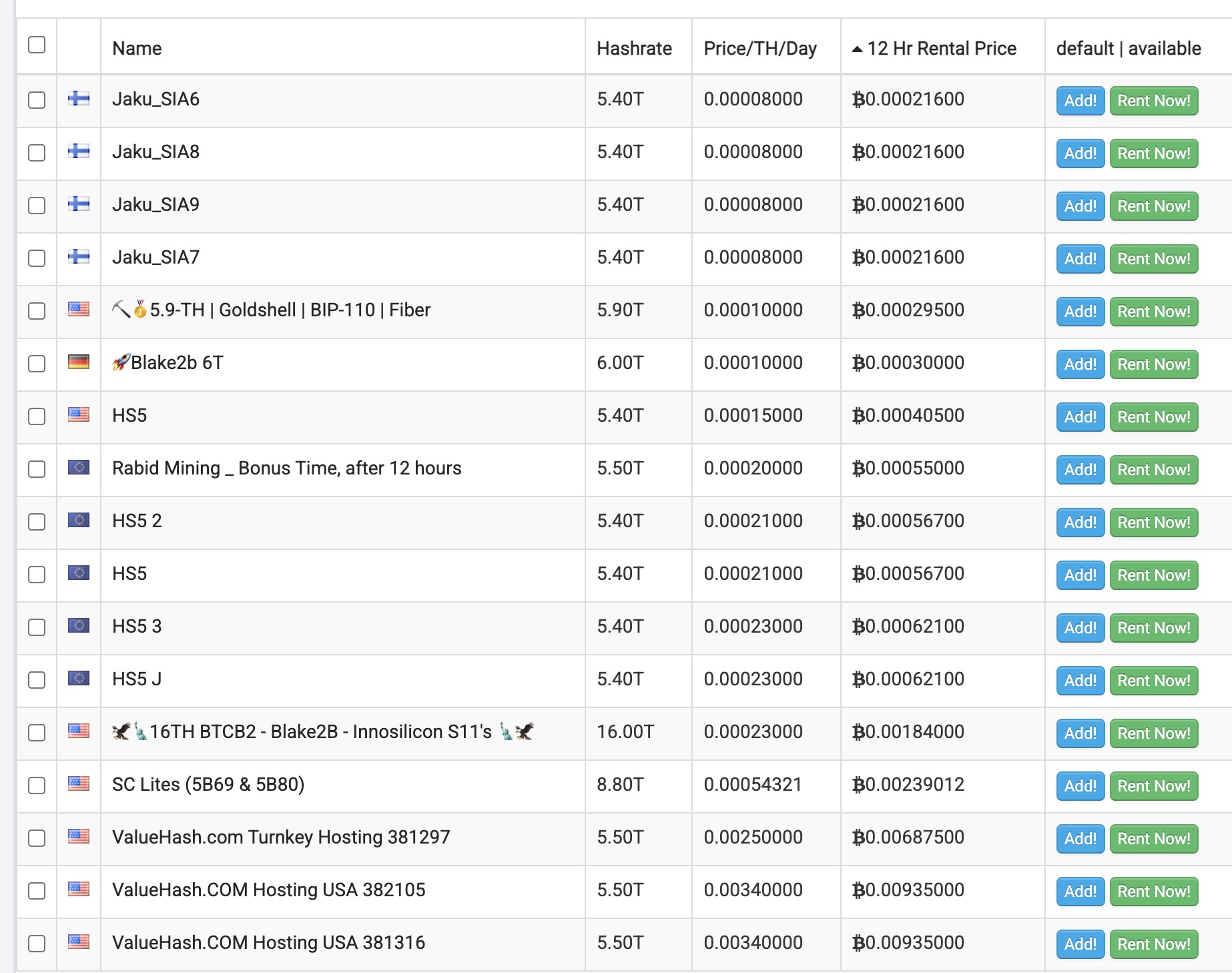

Be very very careful when auto renting BLAKE2B Mining Rigs…it can get out of control quickly. Market is priced all OVER the place.
5.4T = 21600 sats to 5.5T = 687500 sats for a 12hr session
The leaches are out in force!!
I have not used Pickhash with Blake2b due to this fact. I cant control the providers and the massive cost difference.

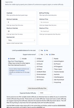

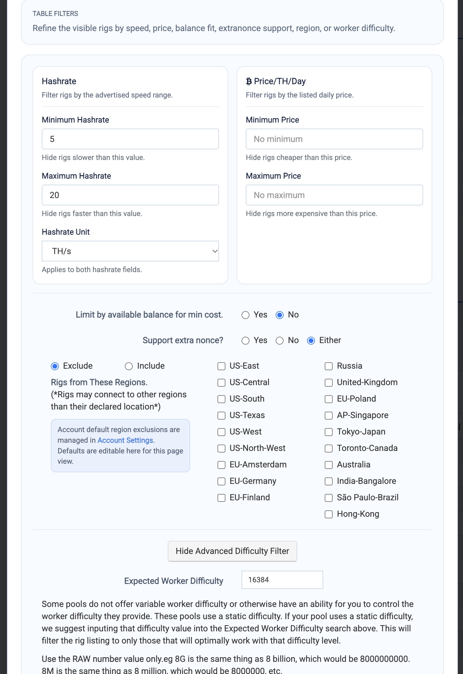

I have a set filter for Expected Difficulty Filter of 16384. This targets rentals between 5T and 20T that match my Datum settings. Might be a page you want to look at to get an idea of what to expected.

I agree, I now pick out the miners manually via MRR also. Depending on your location some areas of the world may give poor results, I am in the UK and miners in the far east tend to be less reliable for example. You can use the exclude option in the 2nd screenshot if you find some locations are worse than others for you.
