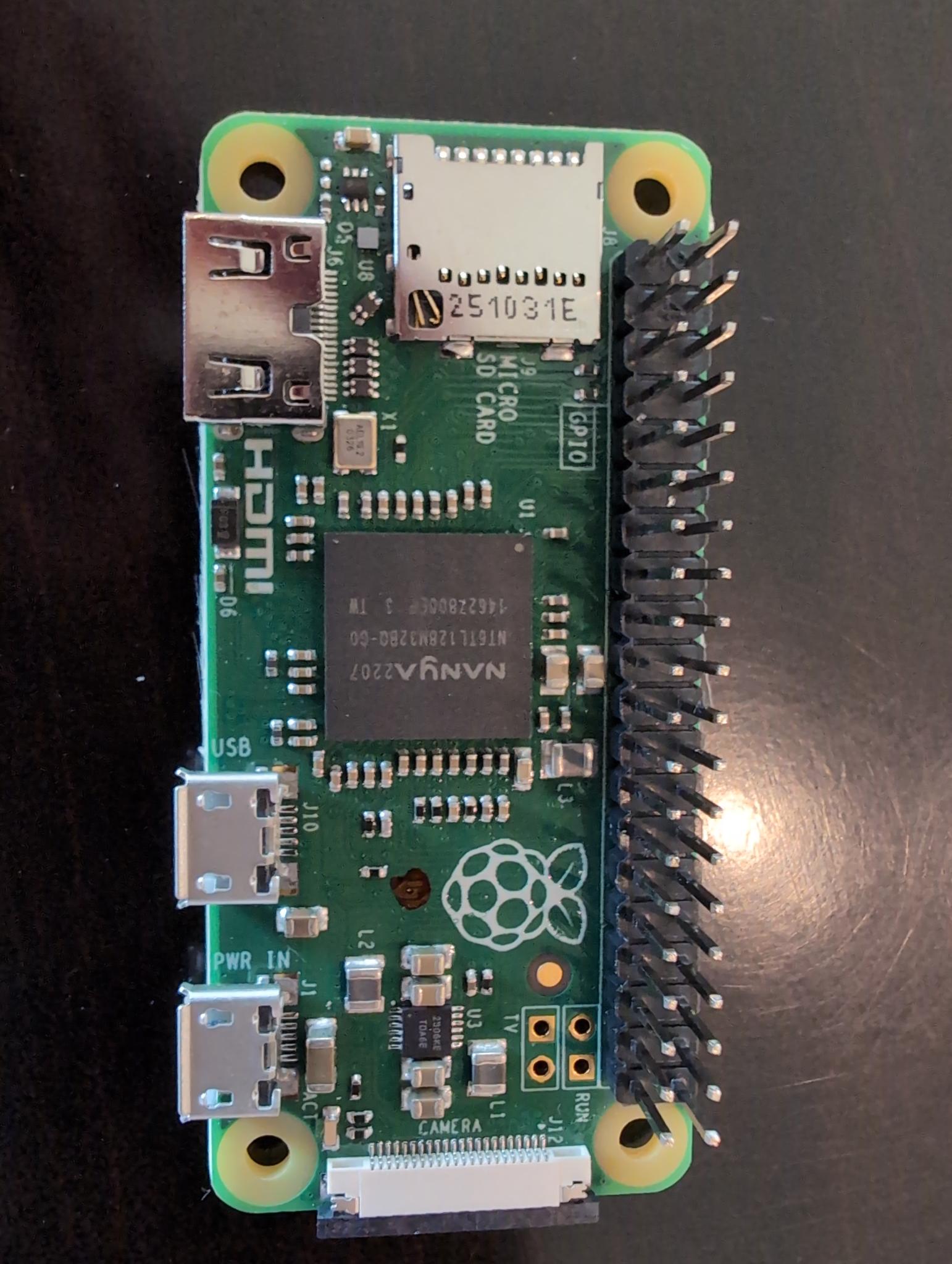

  1. Hi Paul, I said I would post a photo of the Pi v1.3 that came from Ali Express. Can you verify that this is version of Zero that has no wifi/Bluetooth capability?

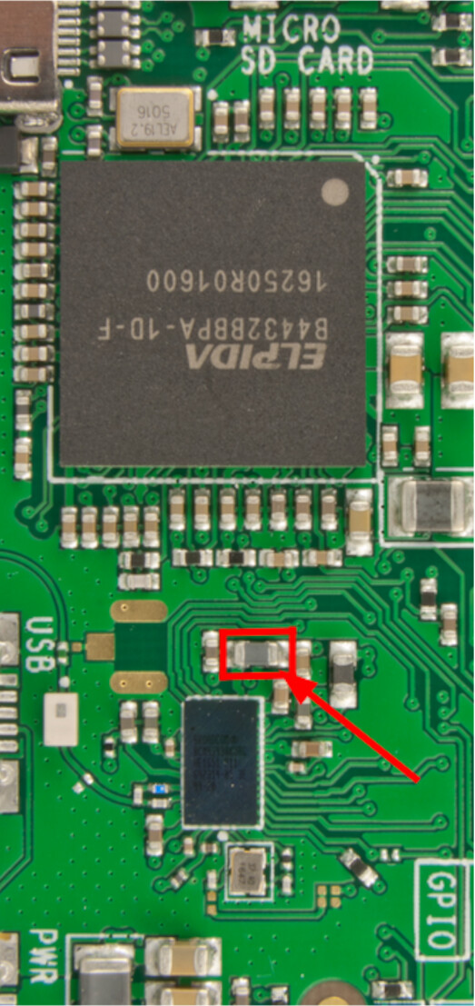

Yes that is the Pi Zero H (without the radios), so no modification is necessary. For comparison, this is what the board on a Pi Zero W(H) looks like:
Essentialy, the place that has a blank spot under the raspberry logo on your board, has circuitry for the Wifi and Bluetooth on the W board.

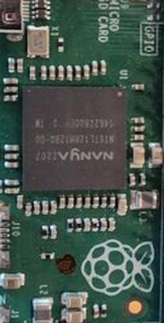

Cropping to the same section on your board for easier comparison:
