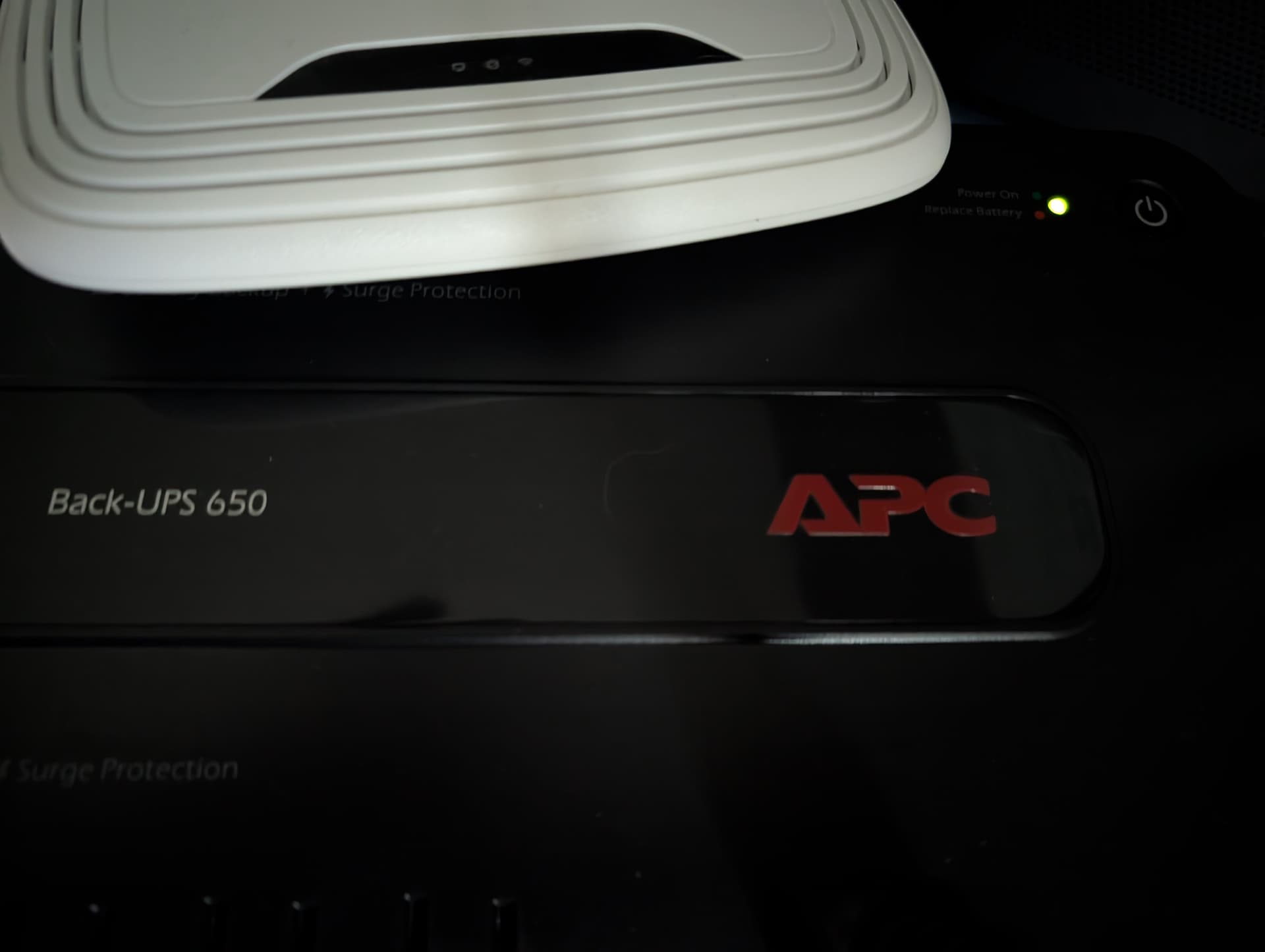

Coincidentally, I happen to be working on a video series related to this. The first one will be reviewing a particular model that is widely available and on the lower-end as far as cost. My ultimate goal will be to see if I can hook into the USB callback interface to have it run a script that shuts down the connected server. I hadn’t considered also throwing ASICs into the mix, but that would be good to add as well.
This is the UPS model I’m testing with (ignore the wifi router)
Yep.I looked at that one for sure. Would need two as server/wifi to far from miners.
Is the 360 watts…is that constant power just plugged in?? That is as much as 3 Nano S3’s on high (18 Th/s). :crazy_face:
Good point – ASICs are going to be a problem for a lower-rated device like this one (I was origionally looking at this from just the minPC + router perspective). The 360 watts is constant power when running off the battery. Basically, the APC guarantees the inverter can source ~360 W of real power for the entirety of the discharge curve (until the “low-battery” cutoff) at 25 °C ambient. The batteries will be exhausted in ~3 min at that load, but the inverter will not trip on over-temperature or current-limit as long as you stay at or below 360 W.
