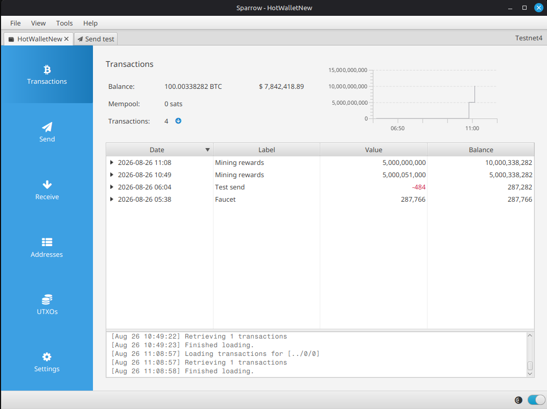

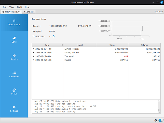

As far as wallet compatibility, this is something I am exploring now. It turns out that a protocol needs to be agreed to for indexers. I’ve started discussions on this with my own proposal HERE for how I think it should work if nobody else has a better suggestion (with the understanding that I am not as plugged into this as a lot of other devs, so I may be totally behind). One interesting fact is that these are changes to a version that only Fulcrum currently supports, so I would guess that it will be the indexer to reach for (though it too will require an update).
My interest in this topic stems from a project I am working on to create a version of electrs which supports pruned nodes (since a lot of folks that would like to follow both chains can’t afford to beef up their RAM and storage, or buy two servers). I’ve already written a version of electrs that follows my proposed protocol (and of course I’ll update it if a different protocol besides mine becomes the official one).
The main wrinkle is that Sparrow wallet (and presumably many other wallets) does not support the new chain for a couple of reasons. The obvious one is that it verifies rather than trusts what it gets from the indexer, by checking the POW hash itself (and that check assumes SHA256). I’ll be releasing a fork of Sparrow Wallet that supports the new chain (using my proposed protocol, until an official one is decided on).
I should have the full stack up on the next couple of days (on testnet4). So even if some of the players are slow to update, at least folks will have a temporary solution once the hard fork goes live. Once official decisions have been made, then I’ll put in PRs for electrs and Sparrow. Whether they will be accepted is another question (I don’t know how these projects view the hard fork). They are both open-source though, so if anything related to the hard fork is rejected, then supporters can always maintain an alternate implementation for them (and I am happy to host the repos if nobody else does – I just won’t be putting the majority of my time into maintaining them myself, so would expect contributors to help chip in).

I got electrs and Sparrow speaking the new protocol on testnet4:
