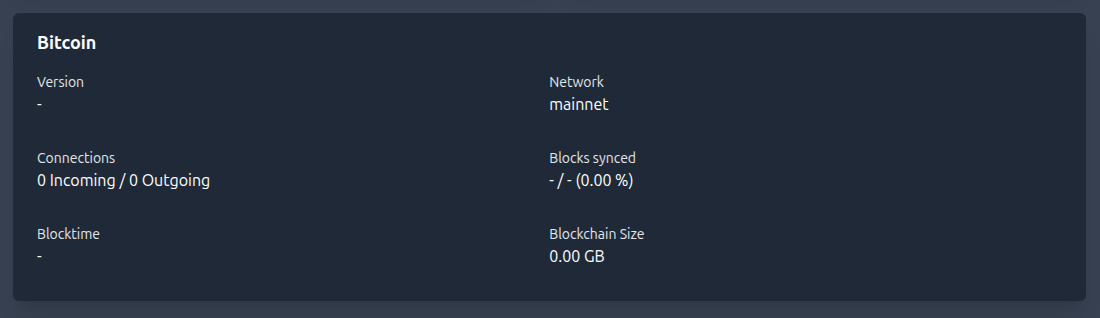

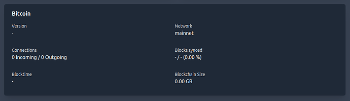

The only remaining issue that I can see is the web UI doesn’t report the status of Bitcoin version, etc. The status screen is correct.
Excellent! I’ll recreate the scenario on my VM once it is synced up, and see if I can figure out the status UI. I appreciate the help! I’ll include this info when I record Part 2.

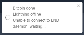

I’m having the same issue as @Gman above. web ui has constant spinner in upper right hand corner of screen.

Thanks for the details. Did raspberry’s suggestion fix the problem, or do you still see the error even with the newer LND version installed?
Yes, that fixes the looping problem but now I can’t see any information about the blockchain.
So not sure if upgrading to 19.1 is the proper fix.
