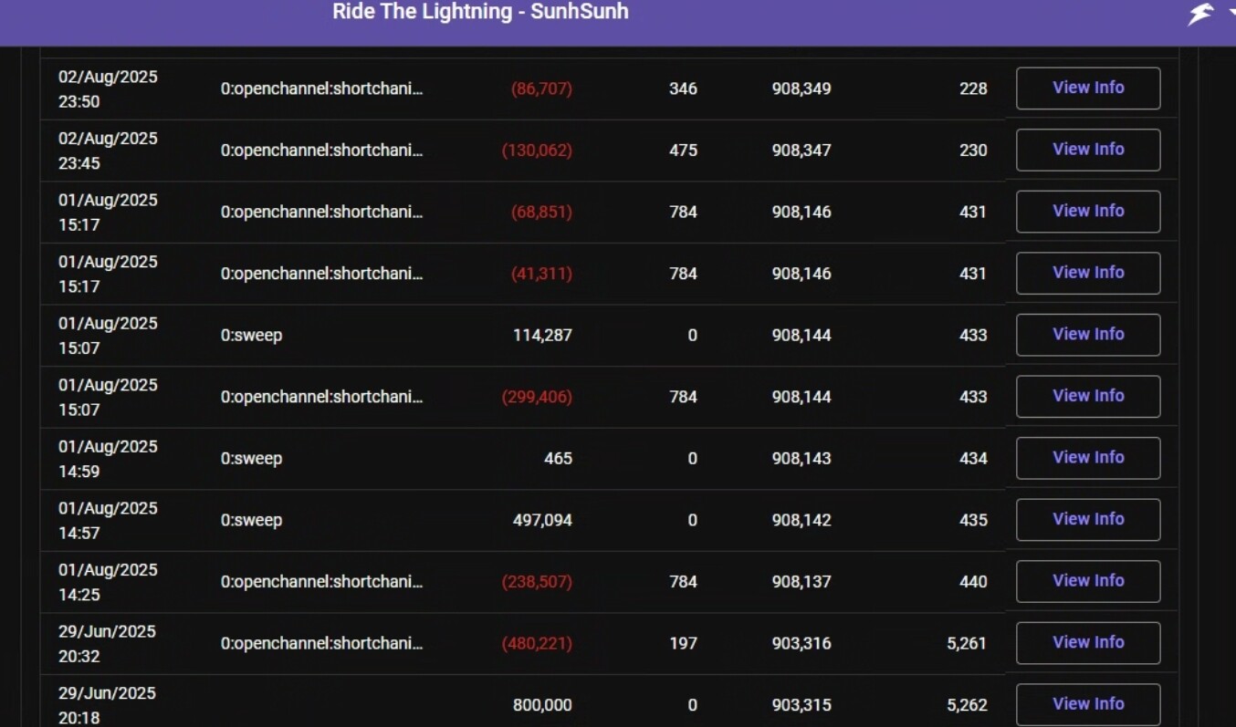

Lightning
2 peers/channels, 0 pending 0 closed
Lightning
0 transactions listed which seems strange as I tested several transactions
Onchain

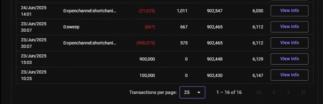

4 utxos 16 transaction 1 dust transaction
I see 3 open channel transactions and one sweep with red triangle mentioning dust

If I am reading this correctly, then you “only” lost 150K sats (plus min channel balances), correct? I am missing something in the steps here, though, because the ballances do not really add up:
You started with 1 million sats
- You have 357,000 sats in the base layer wallet
- You had 800,000 sats inbound liquidity
- You had 150,000 sats outbound liquidty
The total (base + inbound + outbound) would be 1,307,000 sats (which is more than you started with)
I believe I am missing some steps. Could you walk through, step by step, the process you did before making the backup (basically, everything that led up to that point in time). I just want to get an understanding of what the state should have looked like at that point, and then we can try to figure out what must have happened after that point to lead to the current state.
