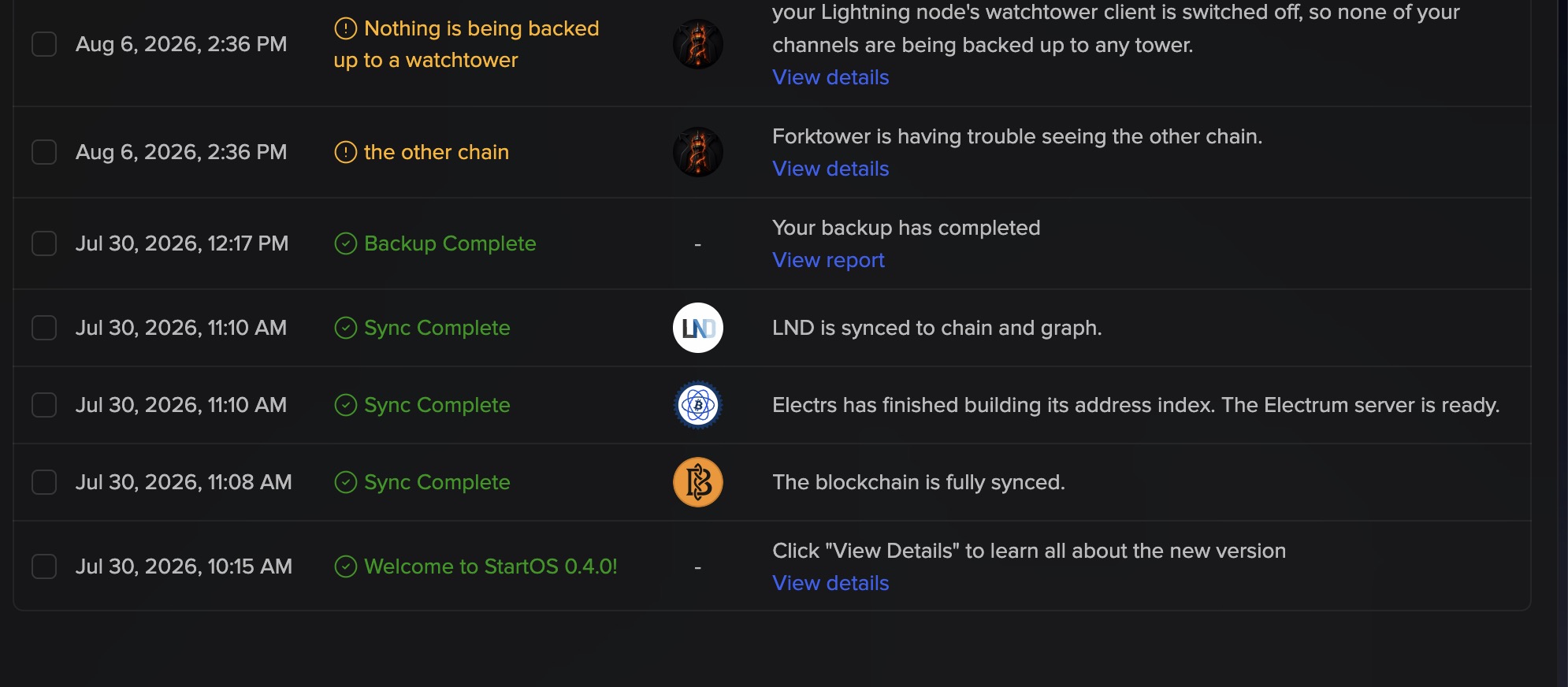

I have a friend that is installing on 0.4.0. He sent me a screen shot. (below).
Is Forktower working as expected?
