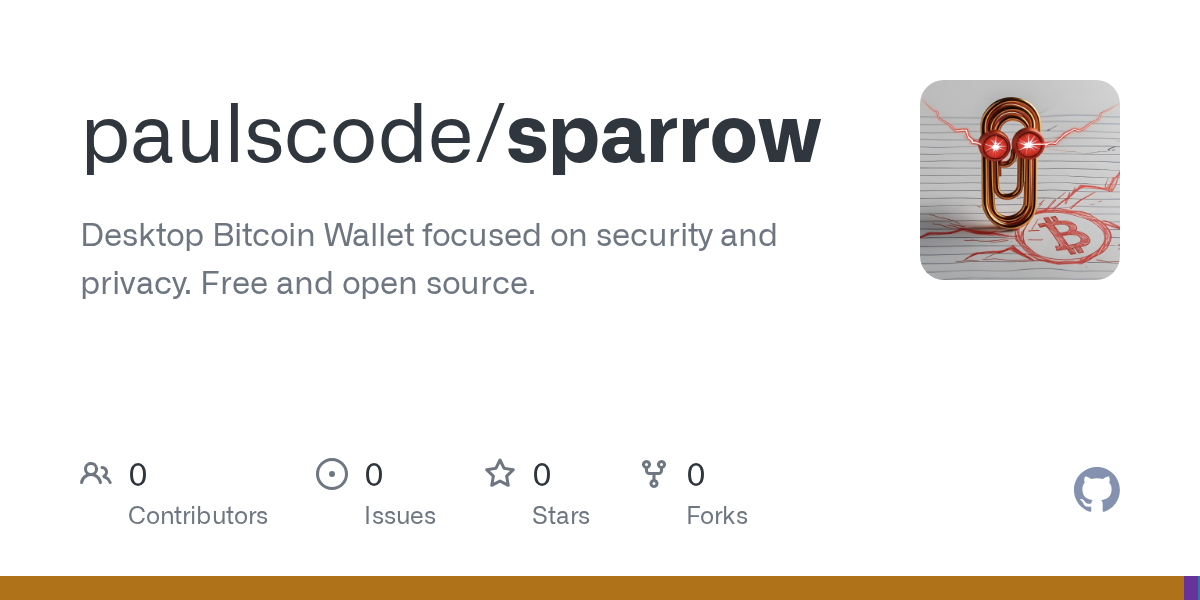

Paul, could you please post the GitHub link for your SparrowBlake2b build? I’d like to install the Linux x86_64 version. Thanks!
I currently am only maintaining the “standalone” versions for Windows (the .zip file) and Linux (the .tar.gz files). If it becomes popular enough, I’ll expand that out. Note that on Mac, I don’t have an Apple signature, so it will try to convince you not to install it (you’ll have to jump through some hoops, unforutnately)
