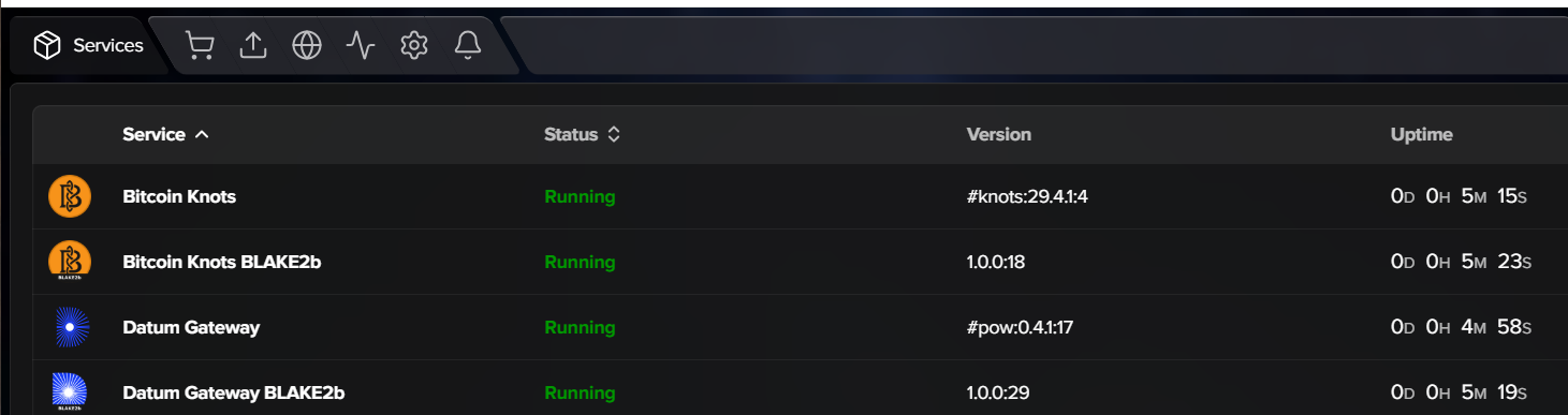

Yes, I’ll be releasing a video tomorrow on how to set this up. The currently supported configuration is Knots pre-RDTS as the main full node (with the normal versions of Datum Gateway, Mempool, and Electrs, plus official Sparrow). Then my Knots blake2b “Companion” (runs as a pruned node out of the box) with my custom “pruned companion” stack (Datum Gateway Blake2b Companion, Mempool Pruned, and Electrs Pruned). The final piece is a Blake2b compatible build of Sparrow (which I also have available on my Github until there is an official one)
I’ll eventually also be supporting the opposite configuration: main node as a Knots BLAKE2b full node with blake2b-compatible Datum Gateway, Mempool and Electrs and a Blake2b compatible build of Sparrow. Then my Knots pre-RDTS “Companion” along with my pruned companion stack (Datum Gateway Companion, Mempool Pruned, and Electrs Pruned) and official Sparrow.

Yes, my forks are designed to run as a “companion” node stack alongside your main node stack. My goal is to allow folks to run a second (pruned) companion node on the same server. This will enable folks who want to follow and transact on both chains but can’t afford a second server or an expensive NVMe upgrade. It also could be used as a fallback option if there are issues with Retropex’s forks.

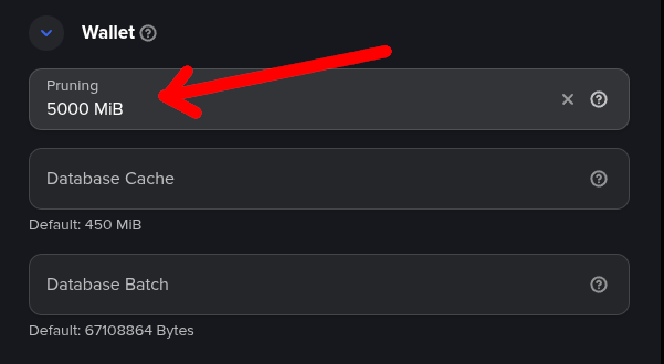

Is the Knots (SHA256) Companion a pruned node by default? I downloaded it and didn’t see anything in the settings about pruned or full node.
Good catch. I think when I ported in the extra bells and whistles from upstream, this reverted from pruned by default to based on the size of the disk (pruned if the disk is too small, pruned, otherwise full). I’ll fix this and push an update shortly so it defaults to pruned unless the user decides they want to run two full nodes.
If you’ve already installed it, you will need to go to Actions and Config → Other Settings → Pruning and set it to 5000 MiB:
Otherwise it will likely try to run as a full node, and will fill up your disk if you don’t have enough space to run two full nodes.
