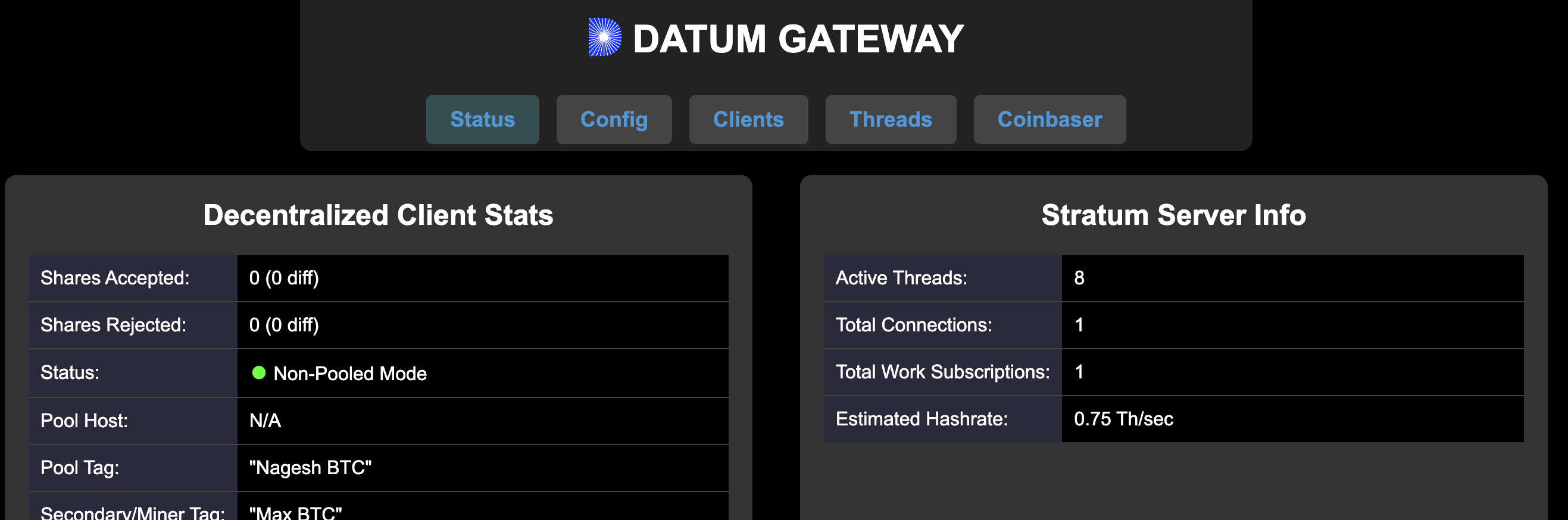

I just set up my bitaxe and it seems to be connected. I was wondering if there is a check that I can do to make sure it’s actually mining? Thanks!
Are you lotto mining, or pool mining with Ocean? If the latter, you should see a graph show up on Ocean if you search for your ID (bitcoin address) that you are mining with. You can also check the BitAxe UI, and also the Datum Gateway UI should show some information about connected clients, etc.
I’m doing non-pooled mining. Attached is what the ‘Status’ page shows.
Looks normal. The estimated hashrate will be volatile at the low BitAxe rates (you’ll get a better estimate from the BitAxe UI itself), but looks to be connected.

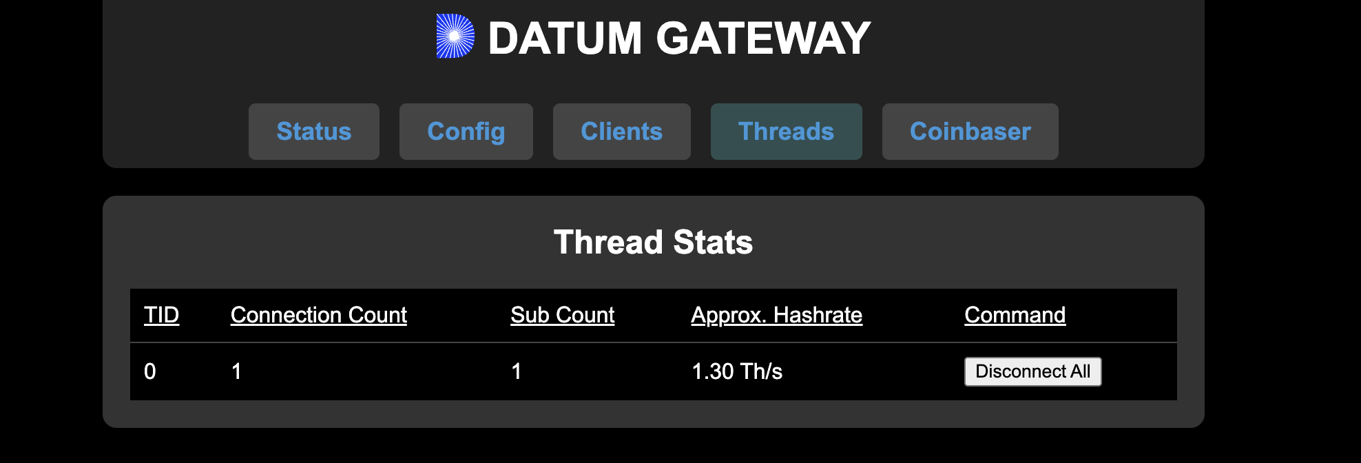

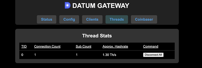

Here’s the threads tab.
I checked the bitaxe site and it shows that I am up and running. Thanks again Paul!
