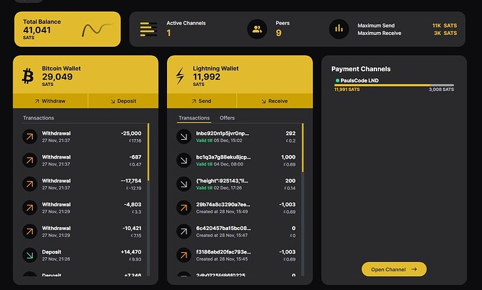

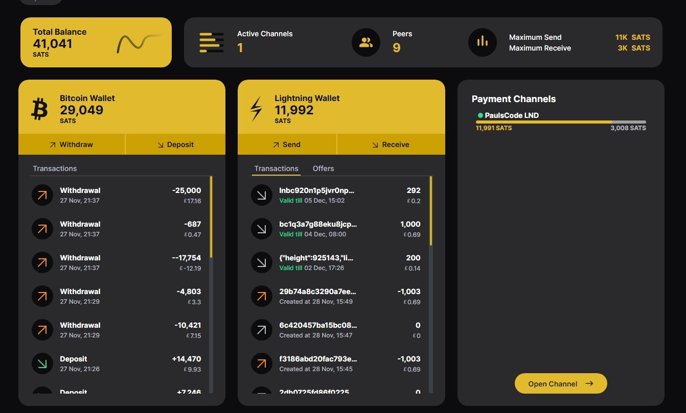

this is my lighting node
is that what you mean by inbound / outbound the maximum send and receive on my lighting node paul ?
i also get this when trying to send invoice from my lighting wallet to wallet of satoshi Ran out of routes to try after 18 attempts: see paystatus
For sending, make sure XPay is enabled (Advanced > Experimental Features > Xpay). Core Lightning’s built-in routing is quite bad. You will also need to leave some outbound (you won’t be able to send all 11,991 sats) since you opened the channel (I don’t know the exact amount, off hand).
That said, looks like you have 3,000 sats inbound, so you should be able to receive sats. Is your payout from mining less than that amount?

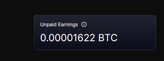

Screenshot_29-11-2025_232342_ocean.xyz
thats my unpaid earning

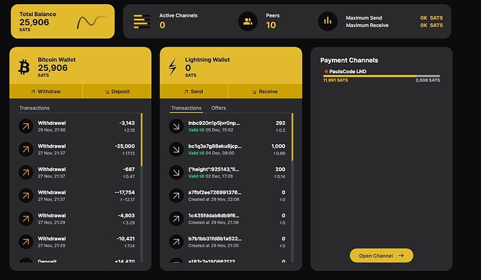

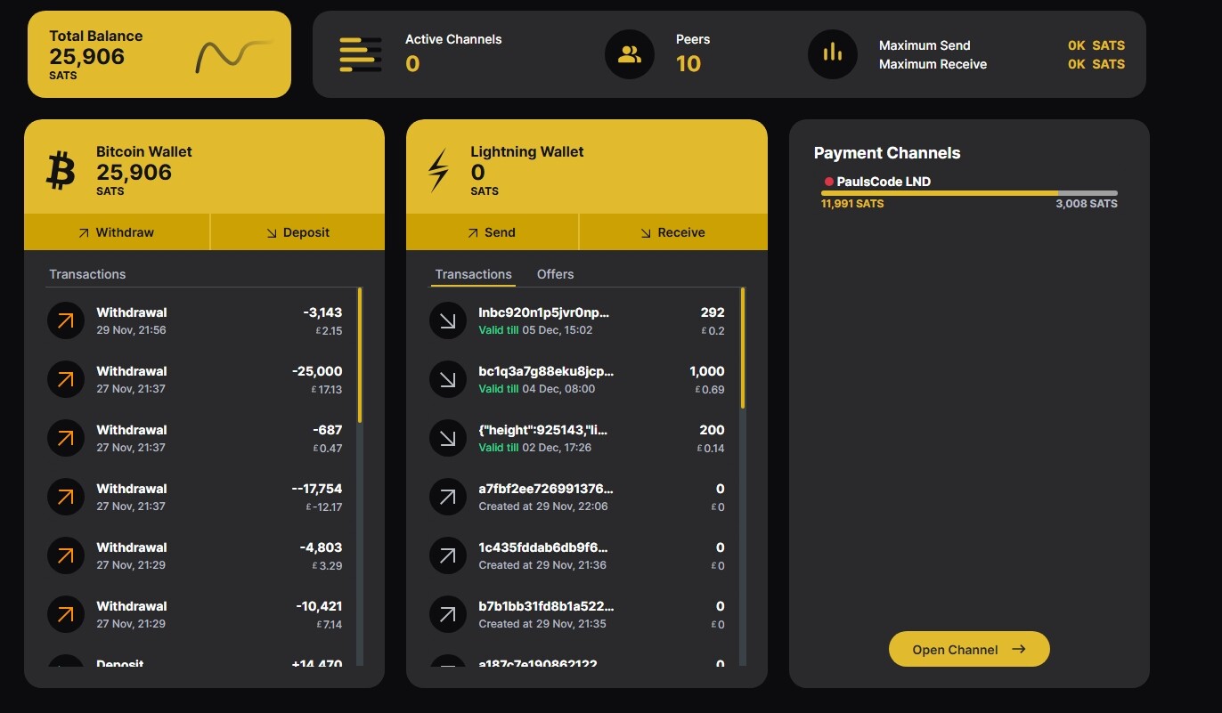

now the channel has come inactive
Yes, I am restarting my node to see if that helps. Just a minute.
It should be back up now.
yes it back up,
