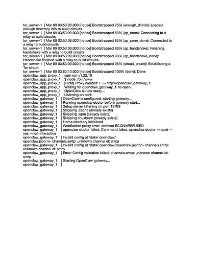

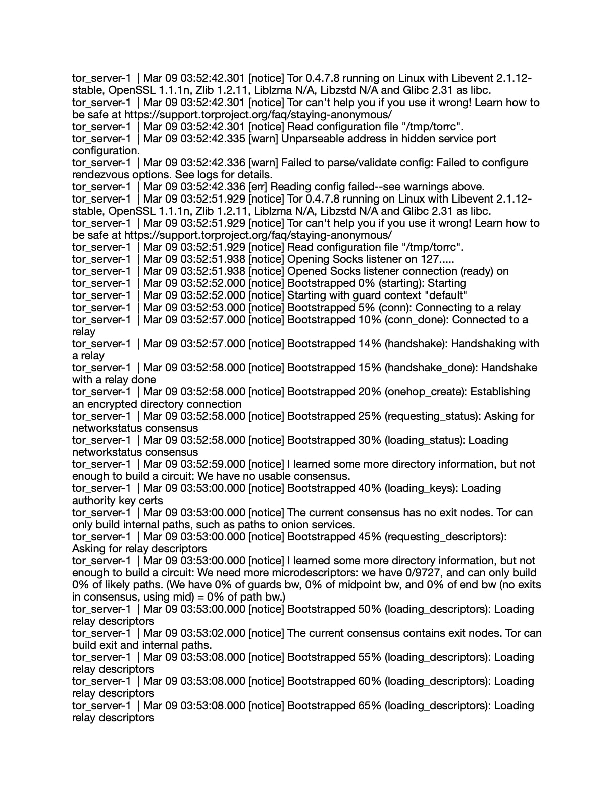

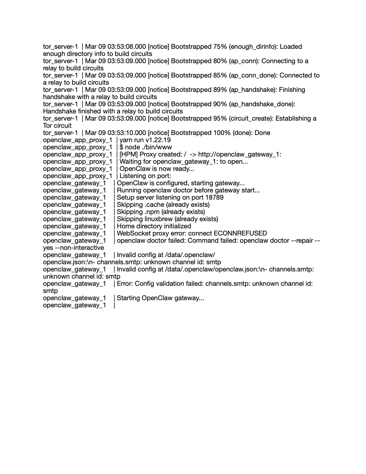

Here is what I have
The log strongly hints that something related to an invalid configuration for SMTP (an email-related protocol) is the problem. Did you do any recent work on your OpenClaw instance related to emails?
yes , was in the process of adding a gmail acct, and had given the ai agent the keys for that account and earlier had added agentmail but it was fine after that install

I assume those would require getting a shell into the OpenClaw container. Have you figured that out? If so, I would recommend working with an LLM to try and fix the /data/.openclaw/openclaw.json config file first. In particular, if you can find a key:value pair containing the word “smtp”, then removing whatever it is part of might get OpenClaw back up and running again. If you can find that part of the config, post it here (removing any SMTP passwords if present first), I might be able to help you edit the broken part out.
