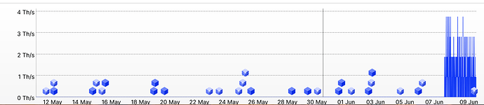

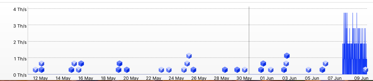

I verified all my settings and connectivity. On the Ocean page I see the following states increasing: Shares, Estimated rewards, earnings, and hashrate.
I am not sure why the Workers section was showing my worker “Online”. It is now showing my workers as “Offline”.

What hashrate are you running at? I have seen on a couple of my lower-hashrate devices that the shares difficulty is set high enough that they often find shares at a slower rate than the liveness checks (so between shares, it looks like they are offline). If that were the case, you would still see a graph of hash rate over time, though (if it is flat-lined, then that is definitely not the issue).

Logs like the ones you posted. Hash rate is averaging 1.04 TH/s
Ok, cool. Looks like it is working fine. I think 1 TH/s is low enough that your worker will appear offline periodically when it happens to take a while to find a share. That period of being “offline” will be compensated for by the subsequent spikes above 1 TH/s when it does find a share.
Shares use a proof of work process that is very similar to how the main blockchain works – they have a difficulty factor (much lower than the main difficulty factor of course) and are found randomly just like blocks. The minimum difficulty that Ocean supports is set such that a slower ASIC like yours may take some time to find a share, and while it is hashing away to find one, it can appear to be offline when the pool doesn’t see any shares coming in from it in the mean time.
My 1 TH/s device often says offline in the Ocean dashboard but its hashing away and the shares are counted by Ocean. My 6 TH/s never appears as offline. Both devices always show as connected in the Datum Gateway.
