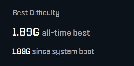

For reason/s unknown my trusty Gamma, modestly overclocked, set a new difficulty ath today. No idea why it suddenly did this (prev. high was 913m) , or what difference / benefit having a miner running at a higher difficulty would bring. Any ideas? Or if you know of a good online video / guide to mining bitcoin please post up a link.
1_89g

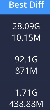

The first hour I plugged my Gamma Pro it hashed out a best diff of 28.09G. It’s never been close again. Best diff is still above my pay grade so if you find info on it I’d be tickled to see what you discover
Just for reference - Since then this is what I have for the Gamma Pro, NerdQAxe and a Gamma. (In order in pic below)
bestdiff
