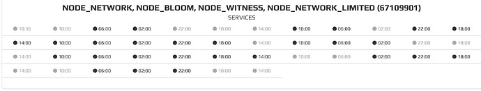

Not sure about that. Also. I have noticed by copypasting some nodes from my Peers list that their addresses when you look them up on the bitnodes website, they also have this PENDING message but they have a section below that that says:
7-day-30-day-90-day
ADDR MONITOR
NODE_NETWORK, NODE_BLOOM. NODE_WITNESS, NODE_NETWORK_LIMITED (6710901)
SERVICES
Some have other settings (looks like it’s settings of how each node is setup). But my node has nothing there. So im still wondering if this is setup properly.
Also, I thought I wasn’t helping the network because I have no incoming connections (other than the 2 127.0.0.1 ones which im still not sure what they mean)
I thought that for the node to be reachable and help the network, you would have 10in connections from other peers that are connecting to you, then the other 10out connections from where you are downloading blocks. So I don’t understand what incoming connections mean then in this context. Like I said I thought that would be people connecting to your network, and there’s none. Same for this other poster above, which also reports a 127.0.0.1 connection. So basically, how are we helping the network, if we have no incoming connections?
So you do not see this type of table:
Exactly. So what does this mean?
My node was pending to but after 10 minutes it was reachable and i could see it on bitnodes.
I also have only 2 incoming connection. But since its reachable i think thats oke.
The bitnodes API documentation provides some useful information about what happens behind the scenes. It looks like the Pending status means “The node has just been activated pending availability of a new snapshot.” so this is probably just because your node is new.
The “7-day / 30-day / 90-day Addr monitor” and the Services section are proably also blank because your node is new. These populate when your address is propagated around the newtork and observed by Bitnodes’ crawler. Once it encounters your node within a future window, it will report what services your node is advertising.
The one connection from 127.0.0.1 I am not sure about. My theory is that Tor forwards traffic to a local port, and so perhaps the incoming peers on tor show up as coming from 127.0.0.1? This would be odd I think, but it would explain what you are seeing.
As far as helping the network, you just need connections for that (doesn’t matter if they are incoming or outgoing) The main reason to make your node a “listening” node is so that you are included on the dashboard node version summaries (such as Clark Moody) – it makes sure your node is being counted in the spam war.
