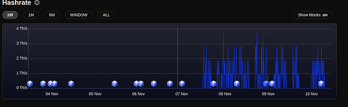

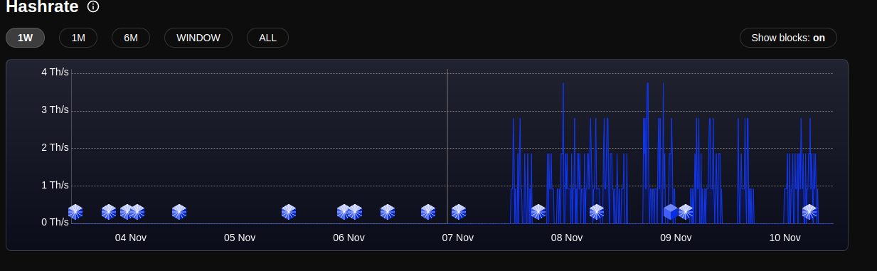

Continuing to study the ocean, already the payment increased 12 sat for 2 blocks. Such small payments I think because it just started to hurt or may be due to frequent breaks in the work (electricity is missing after rocket attacks, we have war). Who thinks why I have such small rewards? thank you all!!!
Yes, I think it is probably because you have just started. IIRC, they split up your rewards over some number of blocks, so you will have leading and trailing ramp-up/ramp-down periods when you fire up a new miner.
Thank you very much, I seem to be beginning to understand how this works…at once it was 3 sat, then 6 sat , just 10 sat.
