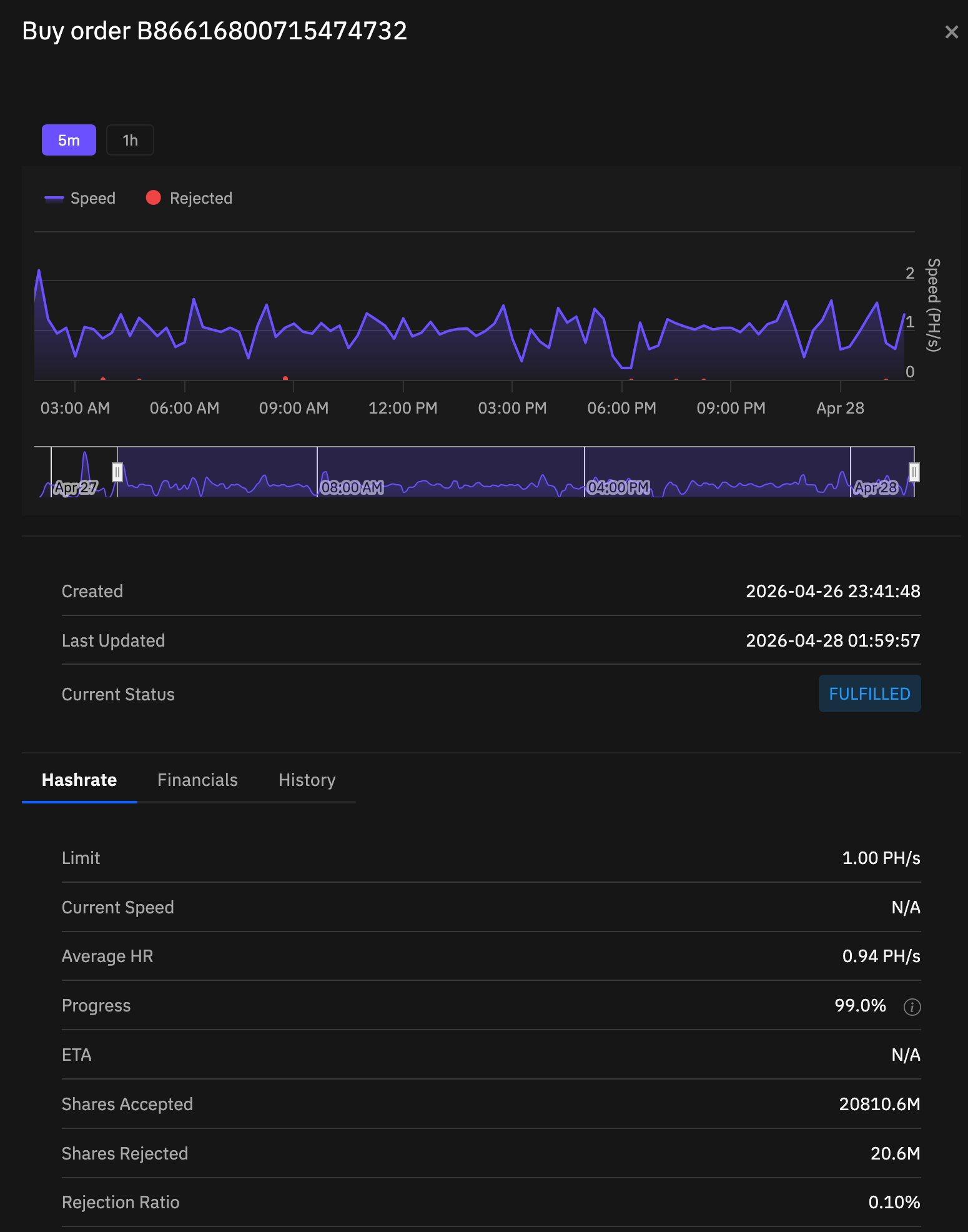

Follow up: 1st run with HashGG. Rejection rate is very low at 0.10% vs 0.40% I have when Braiins point to the OCEAN pool via their node.
