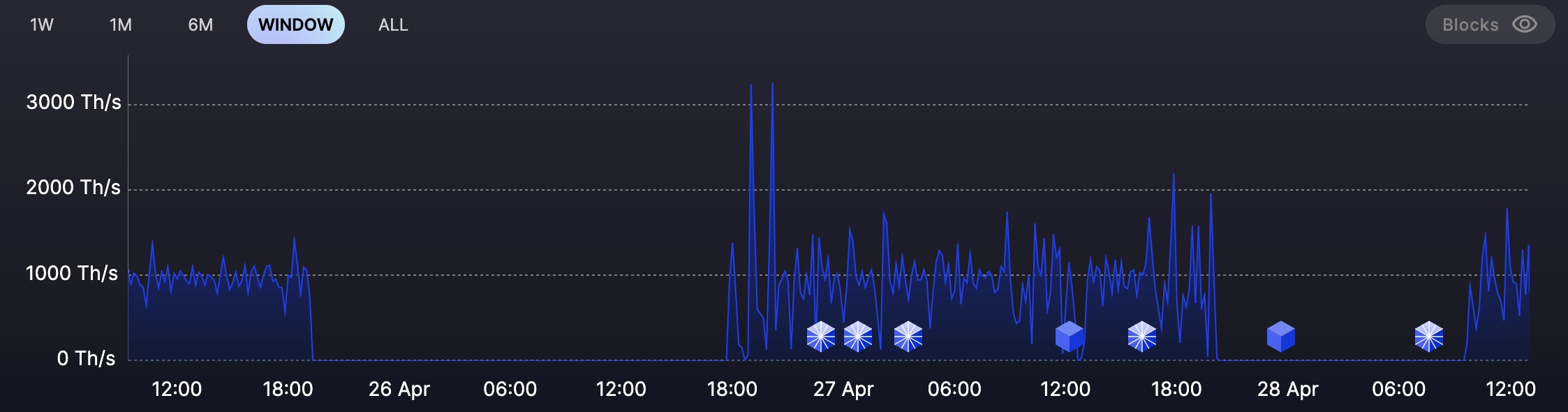

Paul walked me through the setup of renting hash from Braiins and mining with Ocean. My first results are in. I started with 1m SATS and rented 3PH for 7.54 days. I have 681,602 SATS in unpaid on chain earnings with Ocean. I invested $770 USD for the 1M SATS and returned $525 USD for a loss of $245 USD which works out to $33 USD per day for the 7.54 days. Matthew Kratter has estimated a likely return of say 90-95% of the sum invested with losses over time being in the region of $10 USD per day. I am doing this to support the network so I just want to see if this was typical for a first attempt? According to the Ocean graph they failed to land a block on the 25th and 26th of April so I had zero payout for at least 2 days. Is this in line with the experiences of this group?

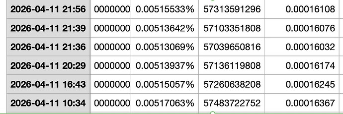

EDIT: Not sure if your new to OCEAN but TIDES works based on hash you contribute to the pool and its reflected as Shares In Reward Window. No shares are dropped until they leave the window. There is a last 8 block limit in the window…so what that means is until the current window doesn’t reflect your hash the “last blocks” are still subject to payment.
…But it has been long enough since 25,26 that you should have noticed what I just said.
6 Block in “Window” example. Last column is sats earned each time

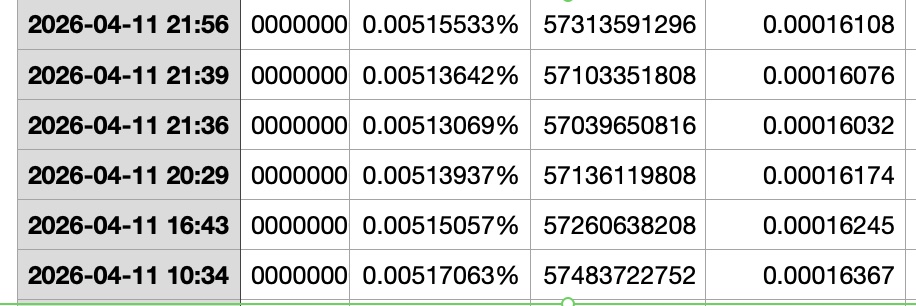

(A snapshot of just the Brains worker)

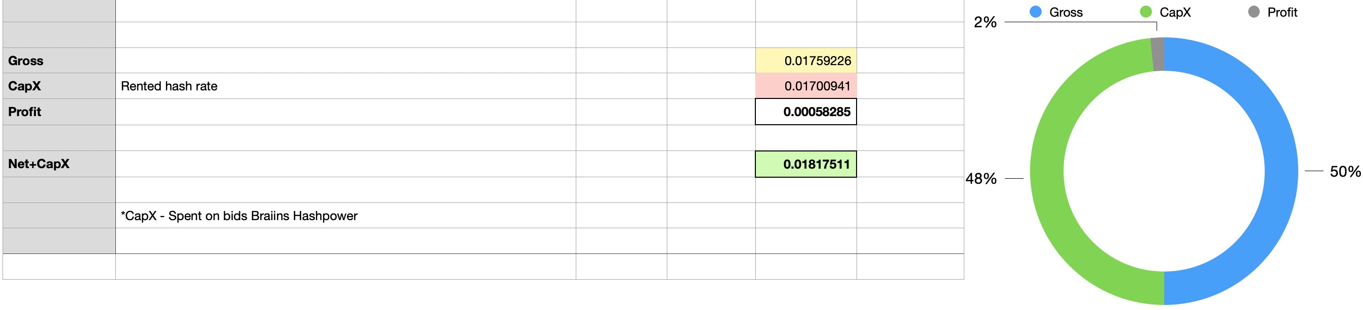

Greg is actually making a profit so he has the system down pat.
So he thinks…basically like I said its a wash (at least at 1Ph/s). Today’s numbers are still holding the same though at around 2%-3% “profit”.

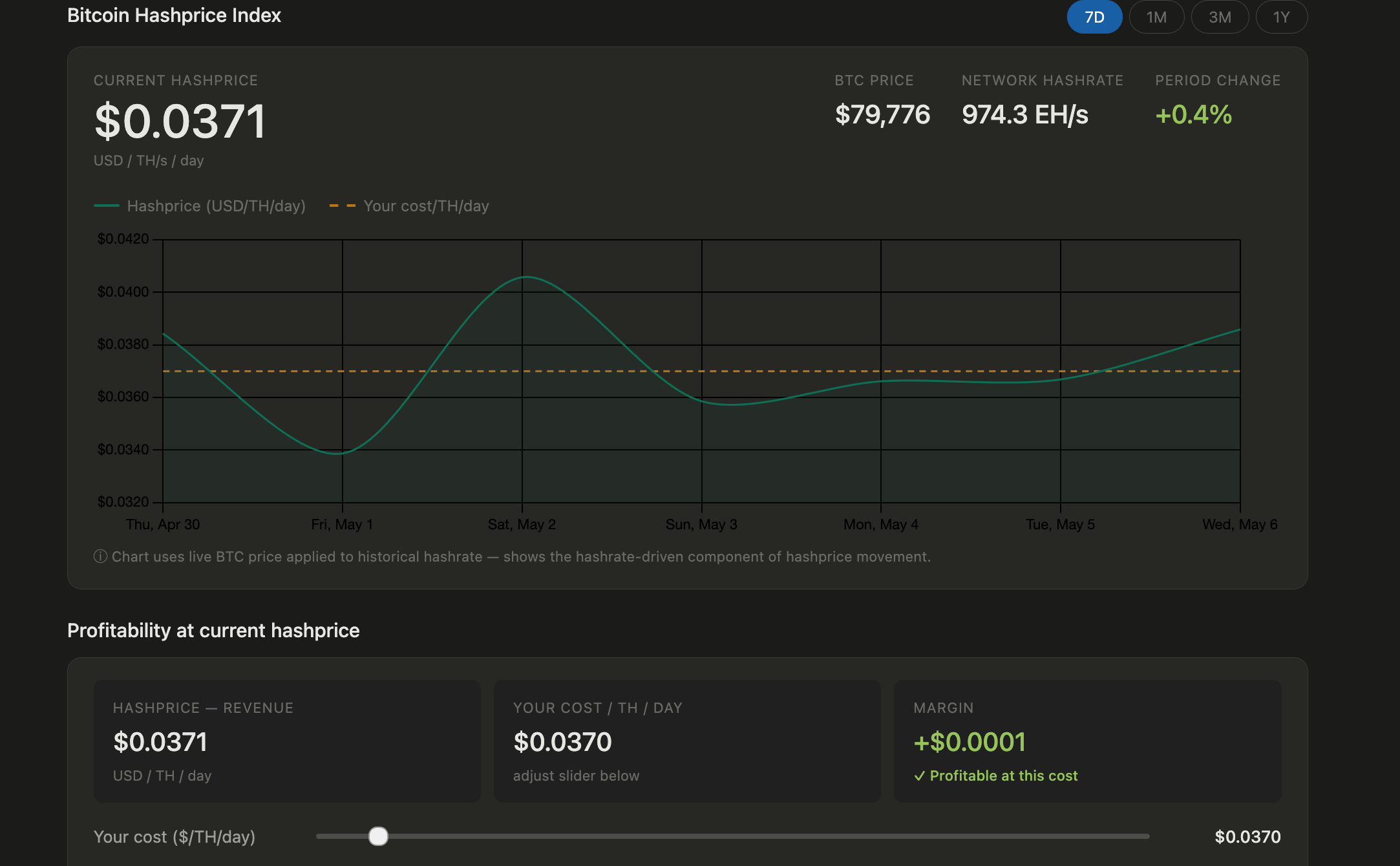

That is true but I pay more attention to hashprice as termed by Luxor. I will not over-bid daily hashprice by much…I’d rather to stay as close to market price as I can…if I over pay say 60000 sats when the rate is closer to 50000 I will let the order pause. I refuse to chase hash that is above market data. The reason is OCEAN’s luck. The pool is averaging 3 blocks a day for the past week (almost 2 windows). I’m in it for 2 reason: 1) to support BIP-110 and 2) a profit. If profit gets way out of hand I’ll stop until things recover. Leaves a real bad taste in my mouth to “give” Braiins my sats. :face_vomiting:
EDIT: I had Claude help me build a little hashprice dashboard so I can see whats happening in realtime. Braiins use to display USD per PH/s but they removed it so I built my own just to stay a-breast.
You got me to wonder what I actually set my bids at…looks like I’m pretty consistent over 22 bids +/-1500 sats on average.
