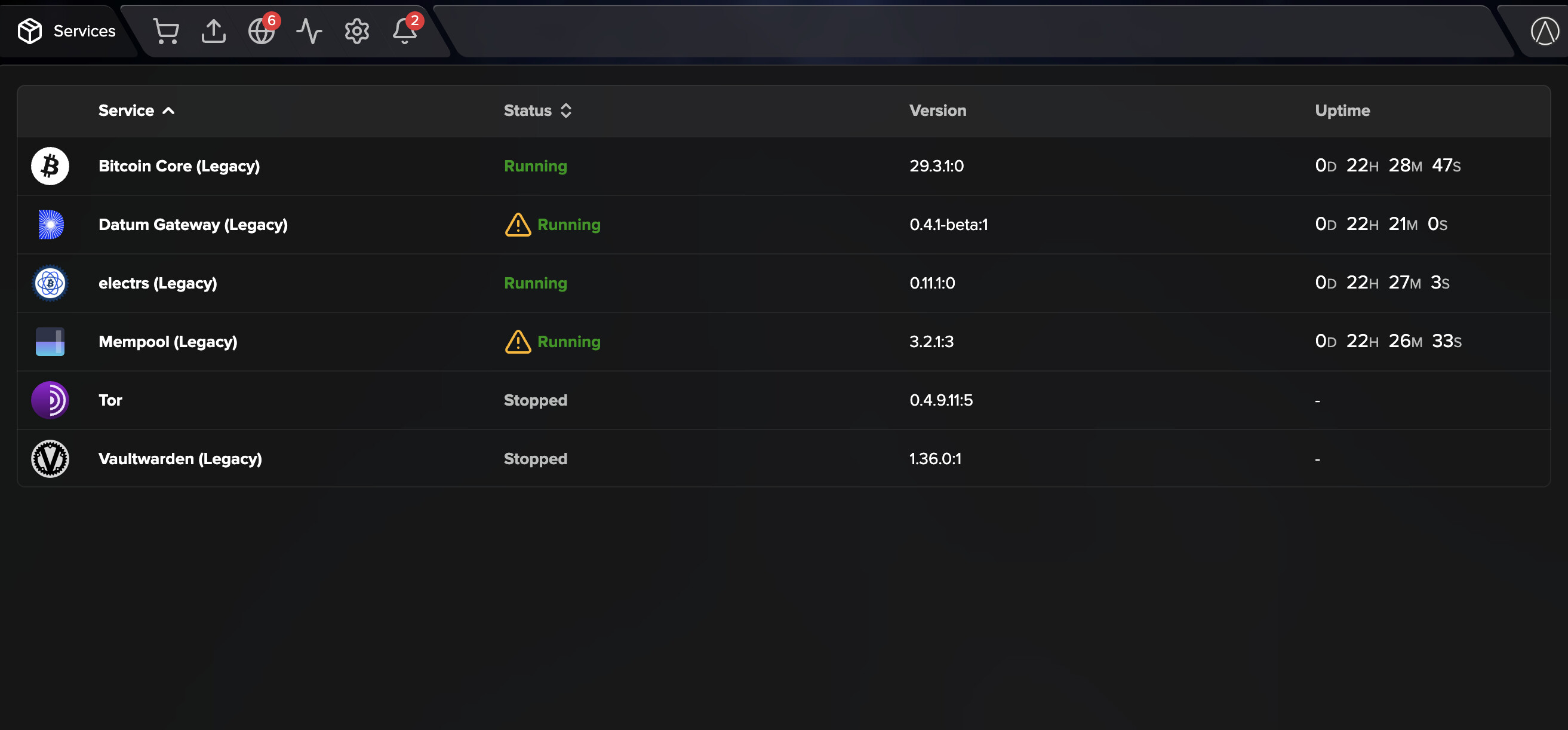

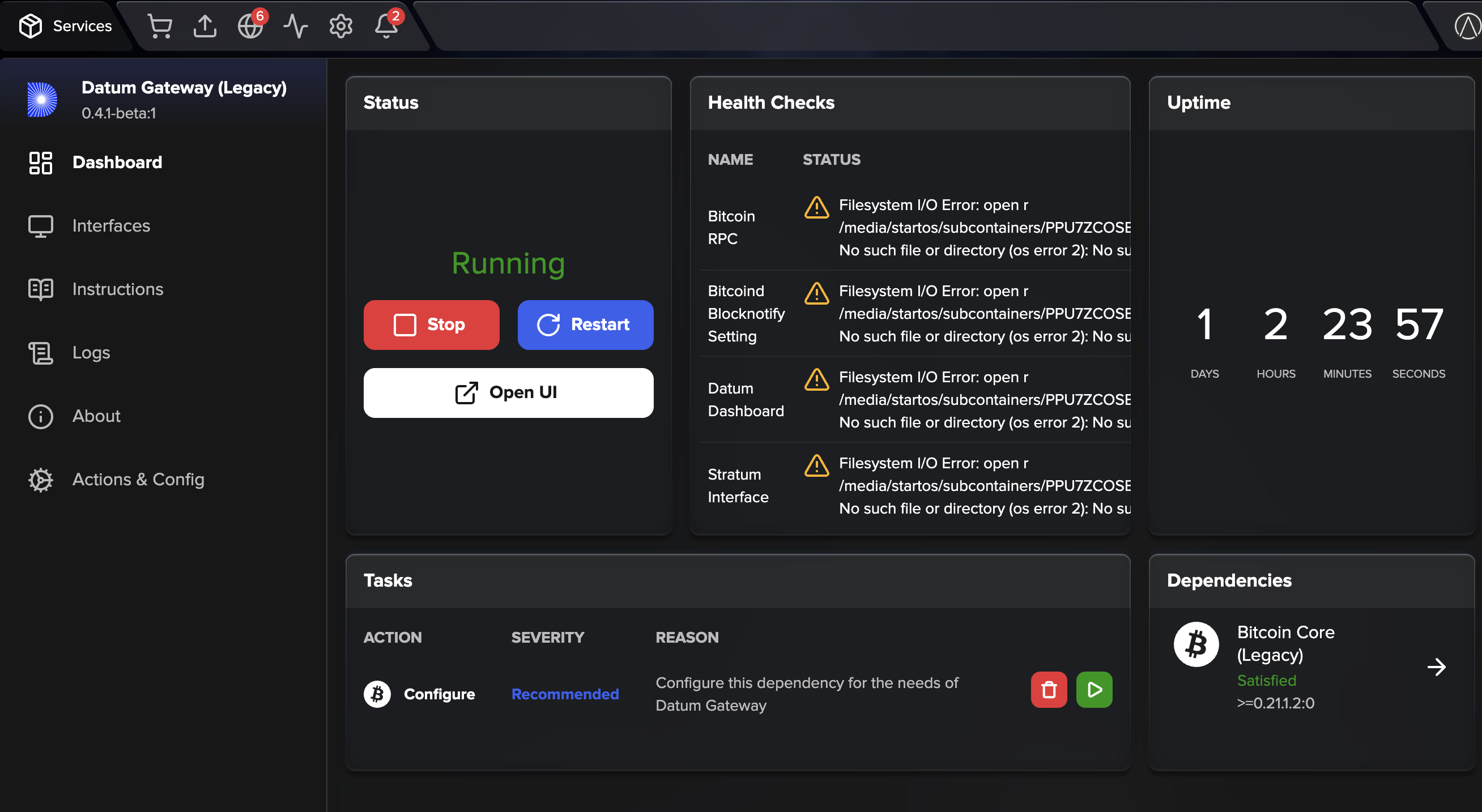

I’ve made the switch (mostly) but there are still a couple of things that are not working properly. I’ve been working with Perplexity to solve it but ultimately, its still not right. I have included a screenshot that shows the issue. Any help would be appreciated. Thanks, Bob

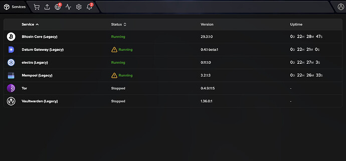

All the items that say “Legacy” are 0.3.5.1 versions of the apps. You will need to update each from the market place next. What errors do you get?
Note that “Legacy” in this context is “Legacy StartOS”, not “Legacy Chain”.
Be careful about upgrading to the latest version of Electrs, if you do this you will need to upgrade to the latest version of Core.
Good point. You could just replace it with Fulcrum, though you’d have to wait a couple days for it to reindex.

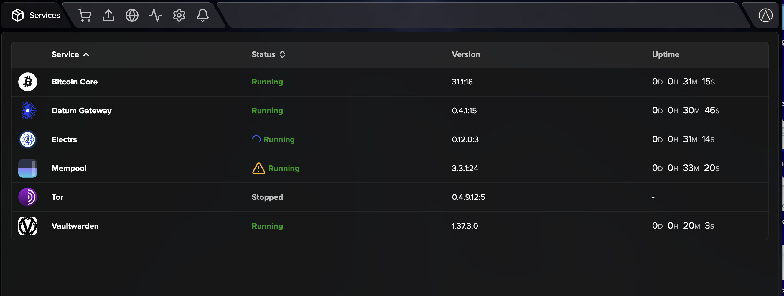

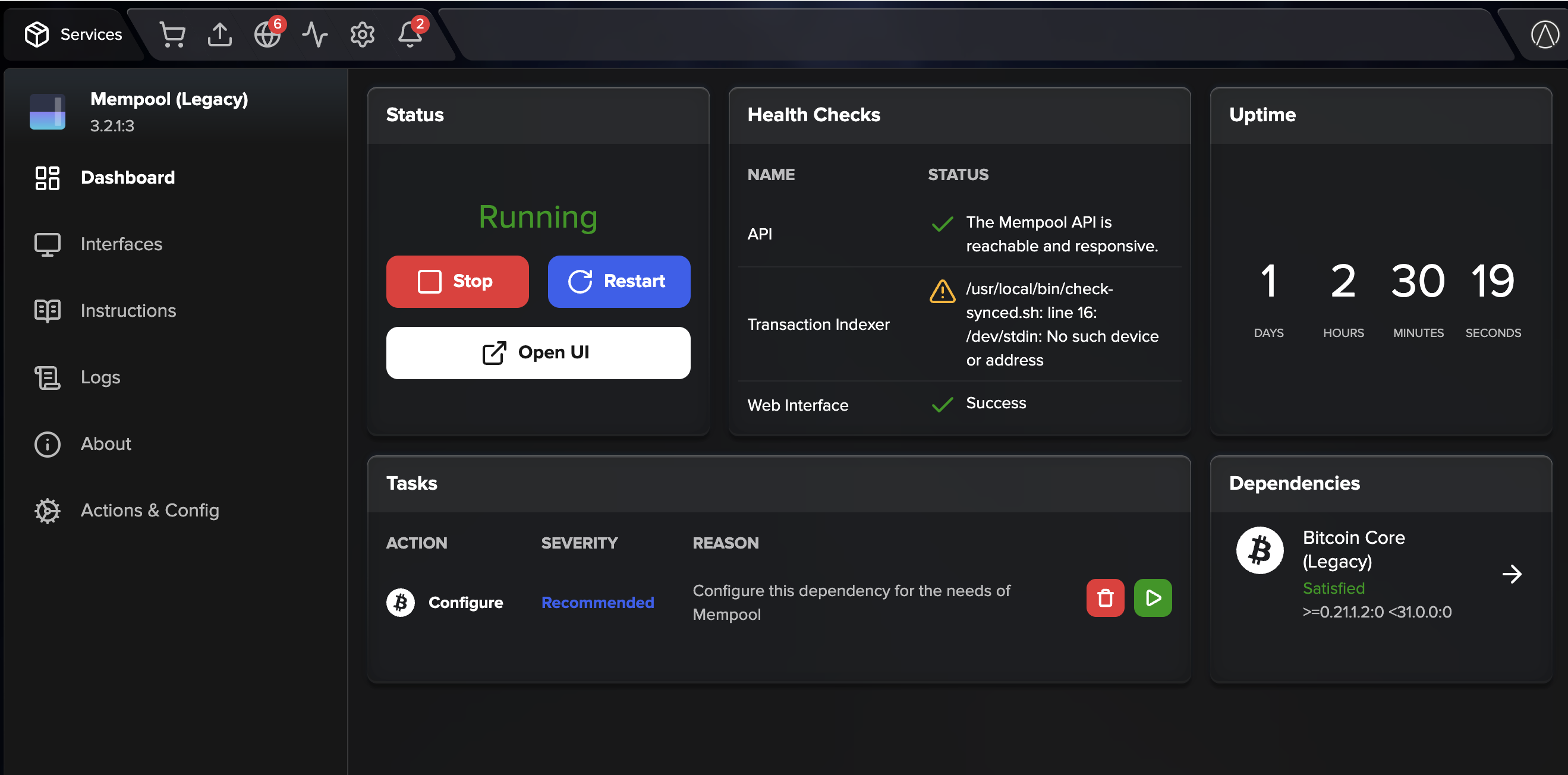

Hey Paul, thanks for your response. Below are screenshots from within datum & mempool.
Bob
Thanks. I didn’t get that.

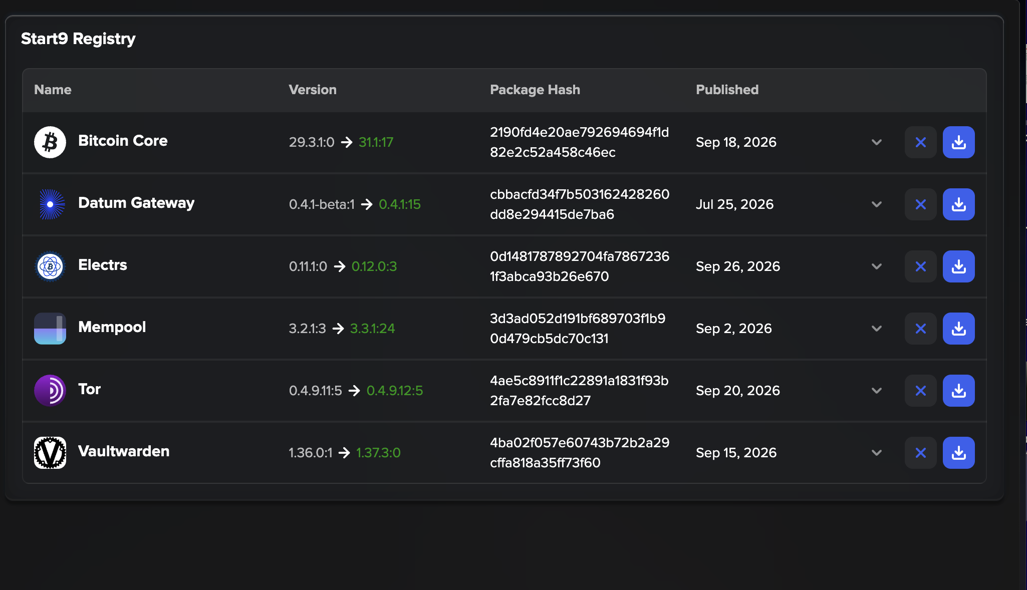

Is this what you’re talking about?
Yes, let me know if any of the updates fail. You can switch Core to Knots Pre-RDTS, but electrs will stop working. Options are to switch to Fulcrum, of wait to switch from Core to Knots until after I publish my updated Knots version.
Is doing all of the updates the best way to get my node up and running properly and simply. I just want my node running properly and that my miner is mining. Though I have followed the schism around core, I just want to move on and make sure I’m running a node and mining, etc.
Yes, update everything. If any fails, let me know.

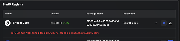

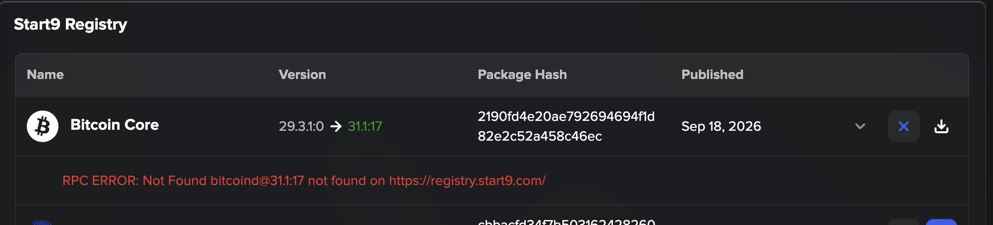

The first one failed.
That is a StartOS error. I’d try rebooting and then try to update again. If still failing after some time, report the problem to Start9.
Also, be sure to refresh the page.. I’ve sometimes seen older versions cached in the UI, and a refresh will display the newer version.
Do you mean to reboot the startOS?

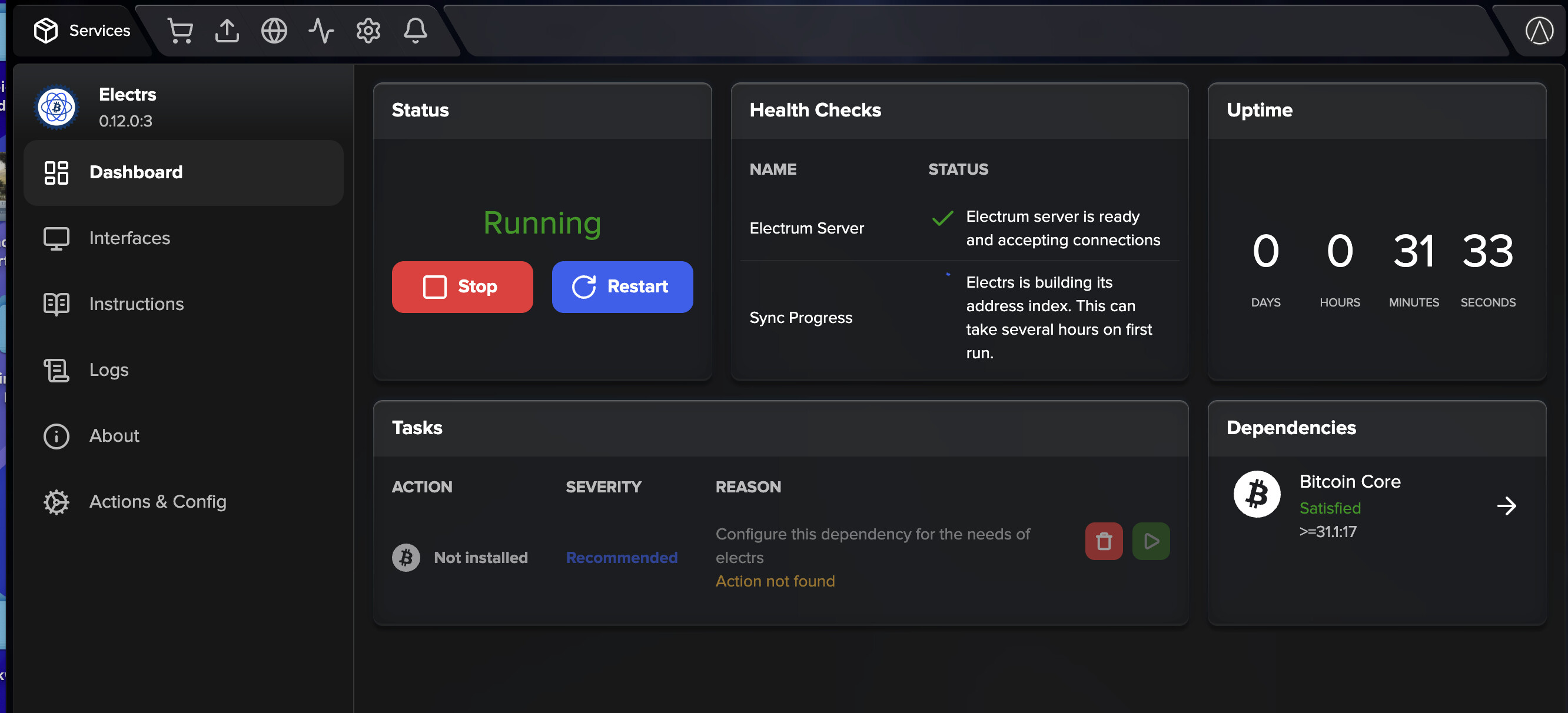

I rebooted startos and then was able to do all of the updates. electrs is still syncing.
@paul Electers is still spinning today. Any suggestions?
Anything interesting in the log?
