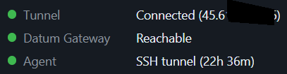

I’m having issues w/ my XBT Blake2b miner(s) connecting with HashGG over VPS. Both connect fine to my local IP. Neither to a VPS. However HashGG notes all green.
Have tried both BTCVPS and BitLaunch VPS. All connect green like above but can’t get the miners to work.

Resolved, thanks Paul. It was my setup issue, thank you so much for all the help in private chat!
Side note for others, HashGG (Blake2b) Companion is working with common VPS from my other BTC Node. In other words, Node1=HashGG/BTC from before hardfork and Node2=HashGG Companion/XBT can both connect to same VPS. Don’t need to rent 2nd VPS for 2nd node.
