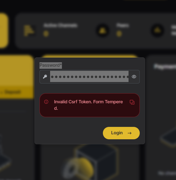

Found problem can’t have ride the lightning open on LND because both r set up on there. Thanks anyway Paul.
I didn’t quite follow. Did you find some information that RTL doesn’t work when you have Core Lightning and LND installed on the same server?
No if u have ride the lightning installed and it running with core lightning in it u can’t open Core lightning by itself even if not open at the time in ride the lightning but Lnd is open alone.
Oh, interesting. That is a good detail to know.
I’ve had this problem off and on.
{"level":"error","message":"\tInvalid CSRF token. Form tempered.","timestamp":"2026-09-12 14:11:54:1154"}
I am suspecting that it’s more of a “cookie setting problem” in the browser if you don’t log off properly. So, accessing the UI say from the IP address rather than the local mDNS address works. So after deleting the browser cookies for the page solves the issue.
