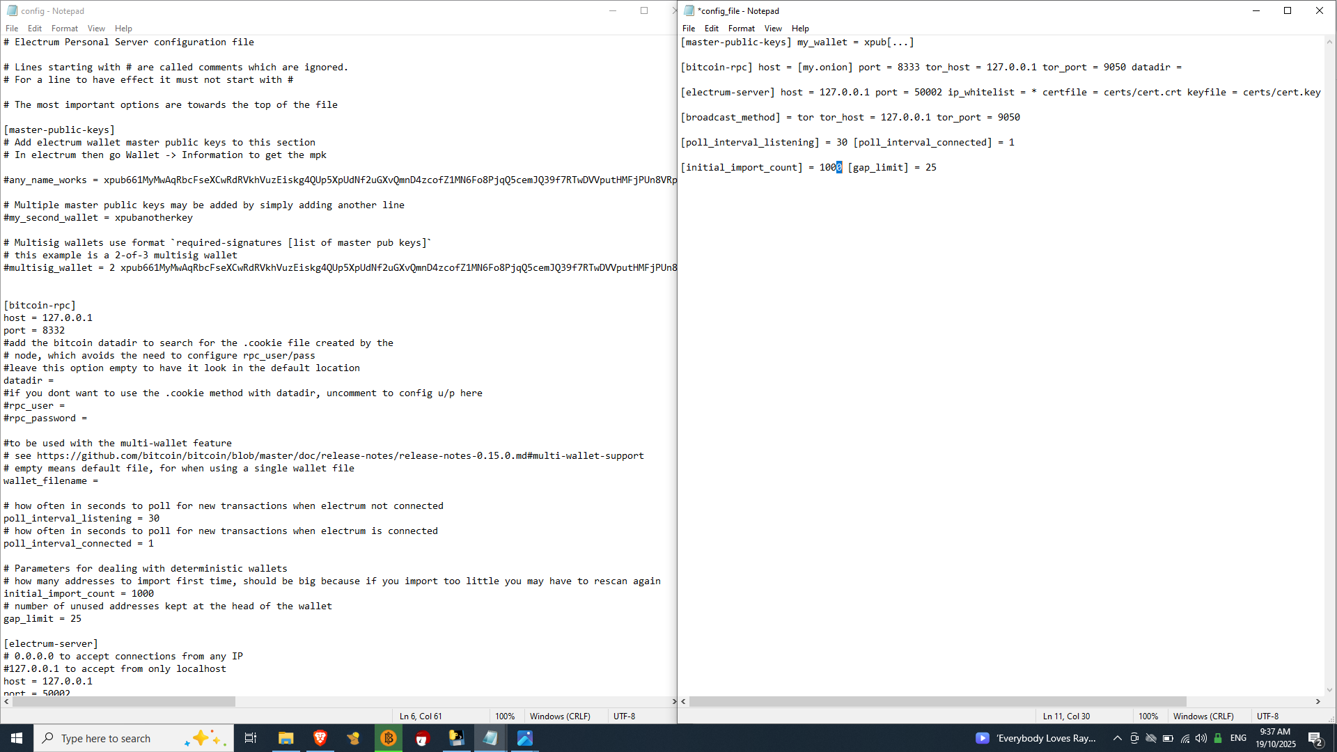

Now I am getting blocked when launching the app with error on the config_file: ''The following arguments are required: config_file
And from their config notepad I tried something but still get blocked.
I am trying to find the cheapest way but I would probably end up doing my own start9 as Desktop is slow to synchronize new blocks at every launch anyway.
PS I found someone doing it on youtube with Linux and he seems to keep the config_file format the way Electrum gave it. Check 5mins12sec bottom right screen.
