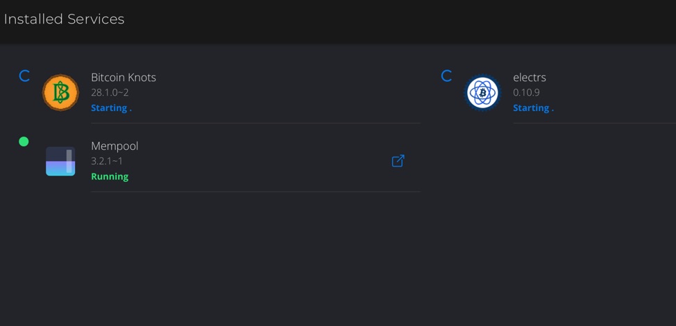

My Start 9 running Knots had been running flawlessly for several months.
I noticed that the host mini-pc fan started spinning up often…it never did that before other than the initial blockchain download.
For some reason Knots Mempool, and Electrs are continually syncing / restarting? And in the process drawing many resources I guess hence the fan coming on.
In the graphic above…each time Knots and Electrs goes into this “starting…” mode the fan really winds up on the mini-pc
Everything is updated and I have tried several reboots…same problems.
This never used to happen.
Have any ideas or suggestions?
