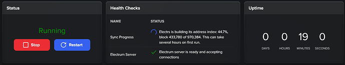

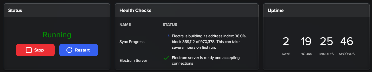

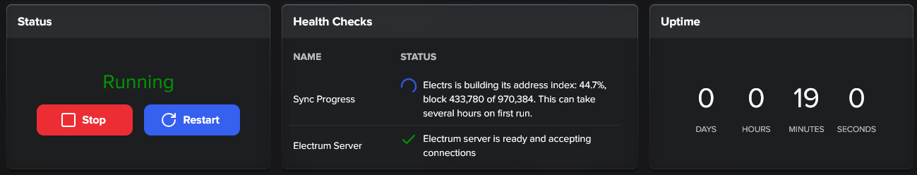

Electrs sync/index looks to be taking 4-6days roughly at the rate its going ( with 13GB Mem available and 900GB Storage )
Is that Electrs Pruned? If so, do you only have the companion node on that server, or do you also have a full node?
yes its pruned. and yes I have a second full chain on the node too ( knots from StartOS marketplace )
Ok, is the full node one running and synced, or stopped?
Full SHA256 chain is fully synced; I tried stopping it to see if it made any diff to CPU usage - but the usage remained very low; so started it up again. The only thing I noticed was a bit more heat when running both chains
Do you want to see logs?
It should sync faster if the full node is running. It will automatically use the full node if it detects it, up until the chain split, then it will switch to the other node that you have configured in Actions & Config > Select Node (which should be set to your companion node). Try stopping Electrs Pruned, start the full node and wait a minute, then start Electrs Pruned again. It should detect the full node on startup and hopefully sync faster. Syncing from a pruned node is much slower, because it has to reach out to the peers on the network to get each block that has been pruned.

Maybe. I’ll see if I can find where that message gets printed. It might always get printed when connected to a pruned node, even if it has a full node to grab from, but based on your speed you are seeing it probably isn’t doing what it is supposed to. No, don’t stop the companion.
Thanks Paul, your suspicion was correct as the index just jumped 6% in 19mins :slight_smile:
“Fully synced” now! Thanks!
