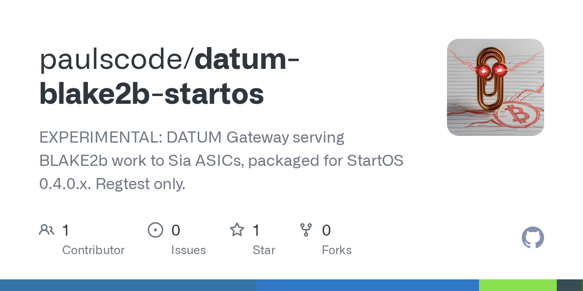

Share this in the Bitcoin section of the forum: Bitcoin - PaulsCode (a free account is needed to post)
or, if you already use GitHub:

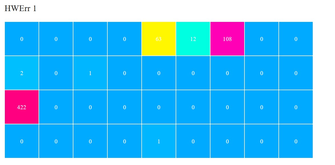

For information, the miner has a /#/debug page, and there I found the following pic with overviews of the ‘chips’, everything looks normal with the exception of the HW-Errors, the numbers indicated fit to the total number of errors shown on the homepage. This looks like a possible HW-problem, but could also be certain ‘timings’, which lead to the errors culminating on three of the chips:
Interesting. That counters my earlier theory about the difficulty being too low. We’ll know for sure when you start mining on a higher difficulty (if the HW errors continue, then constant re-orging isn’t the cause). I’m leaning to it more likely being something physical specific to your device (such as old thermal paste, a literal bug stuck in a heat sink, or just failing old chips for that matter). Timing is also a possibility (though that wouldn’t be specific to Bitcoin I don’t think, maybe a fine-tuning issue)
