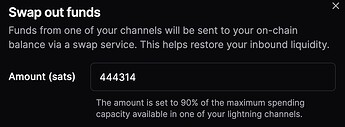

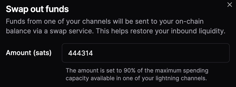

So…I imagine a swap would be the way to go? I have a Spending Balance of 550,000, Receive 0, On-chain 133,00. When I click on Swap I get this window…
The amount of sats is per-popluated.

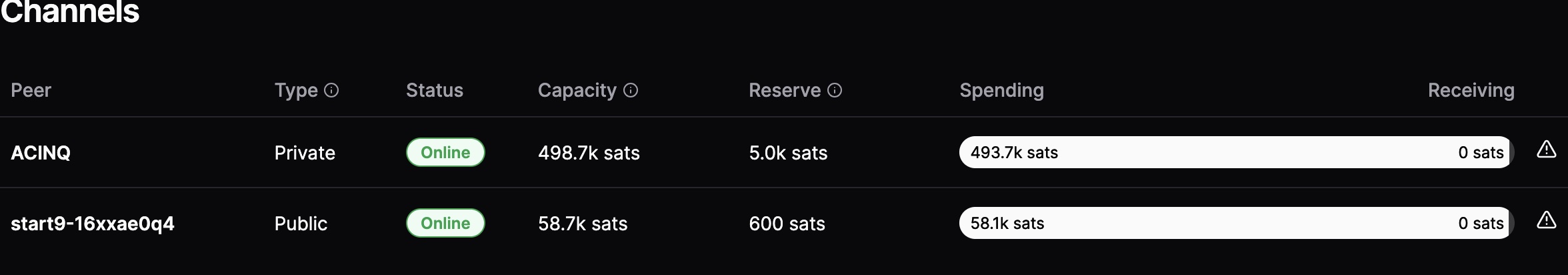

I have two channels -
Without revealing upcoming content inside your upcoming videos…what the heck do I do here @paul
Reason: I’m going to be bringing 90TH/s unit online in a 2 weeks and participate in two pools. If you would rather not jump ahead of tutorial I do understand. The current videos I see online speak to the Cloud hub for Alby which I do not want to participate in as I’d rather self host on Start9.
Argh!!
Your channel with ACINQ is 100% outbound. You likely want to move most of that out (typically, you would send it to cold storage, but you could send it to a hot wallet or to your Lightning node’s base layer wallet). That will create inbound liquidity on that channel (which is what Alby is referring to).

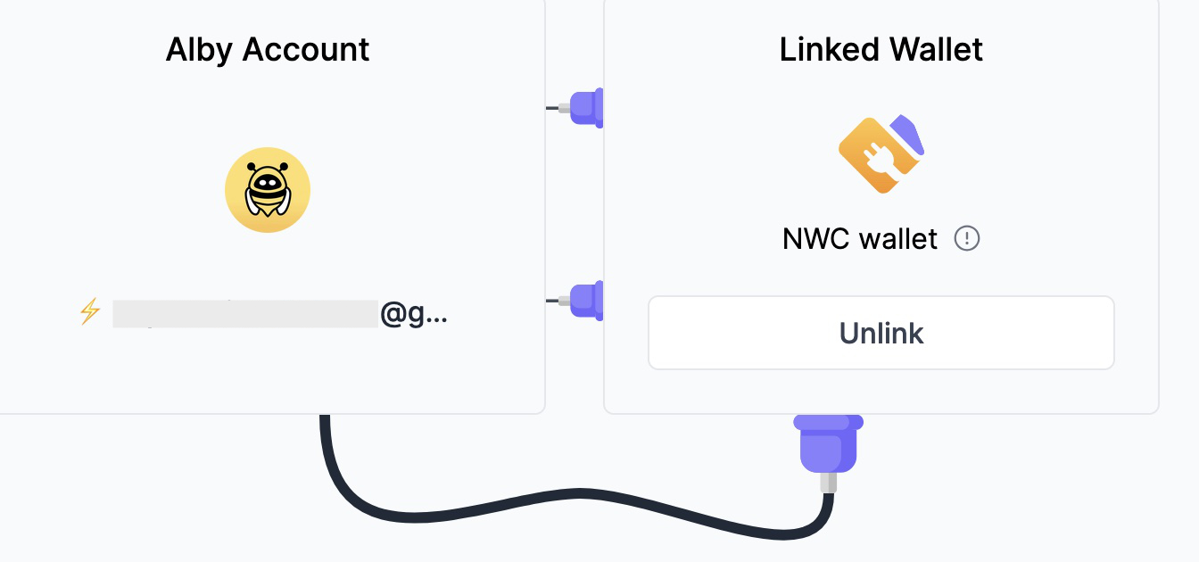

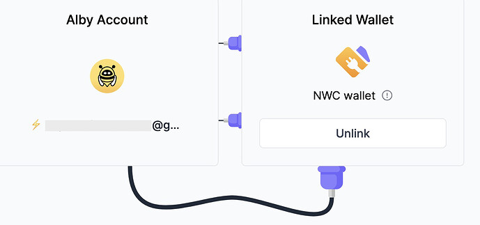

I wonder if this is the problem? The Alby account is tied to a NWC wallet. Certainly could be that could it?
I responded to Alby support with my setup and this image as well. I’ll see what they have to say.
Ah, I hadn’t even noticed that before. I see the same thing on my account. Will be interested to hear what they say about it.
