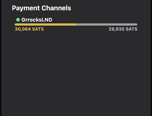

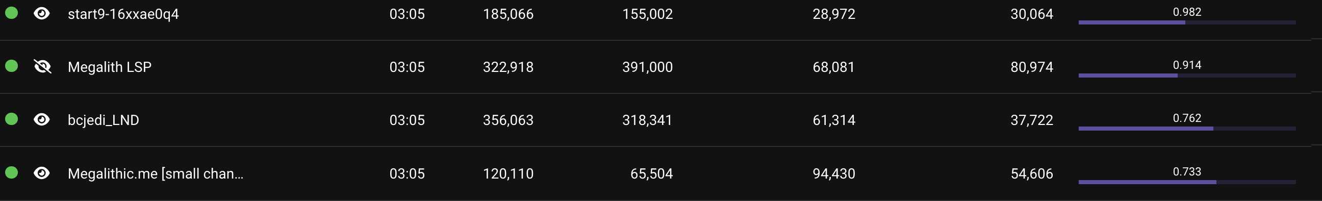

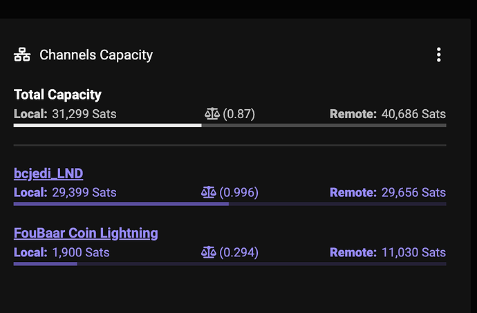

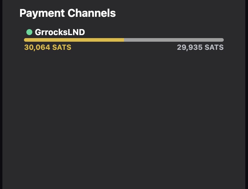

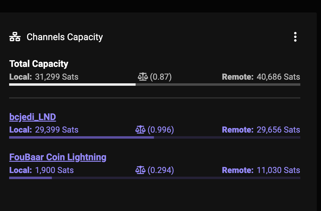

I don’t use Paul’s node at all. The 2 images below are my two lightning nodes, LND and Core.
The two Megalith’s, “blank” and “blank” are my LND peer/channels
The “blank” in LND is the channel I opened from LND to Core. In the Core snapshot the channel “blank” is the same channel as “blank” over in LND. Those 2 channels are one in the same. Follow?
The “blank” peer/channel is the other user here on the forum. It’s our routing channel. He has a similar setup to me but he uses different channels in LND..I think he might use MegaLithme and Pauls LND. Not exactly privy to his setup so take what I say about his setup in LND with a grain of salt for now.
MegaLithme (small channels) appears to play a role with the other user on this forum more so than it does me. Not sure why but that’s what he reports. The MegaLith LSP is used in circular re-balances for his channel from my end. I try to keep him balanced at 1 but at times it’s a challenge. Sometimes he has to finish the re-balance from his end…probably by withdrawing his sats from Core (OCEAN payouts) to his LND node. I’m not exactly sure what he does. He may chime in and let you know (and me) what he actually does. Regardless this setup works well for both of us.
You follow what I’m saying?

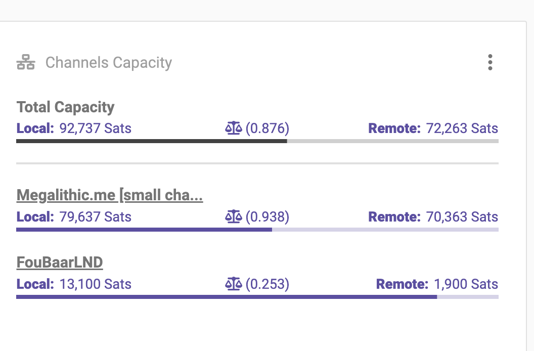

Thanks Greg, thats been very helpful. I’ve now set up my two Lightning nodes thus:
Probably not optimised at all!
