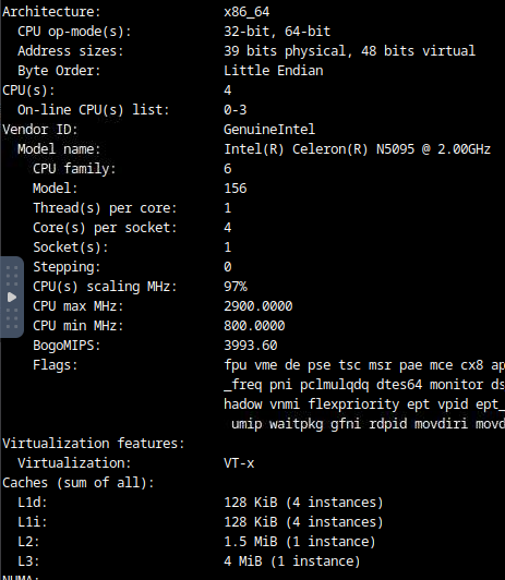

Could you describe what you know about the full hardware stack (don’t need all these details, but they can help with ruling out certain hypotheses)?

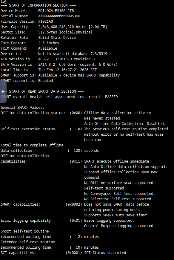

Thanks for getting back to me Paul. The miniPC wasnt down at all, only the external SSD was not connected for a day or so. So when I remounted it, it would sync slow and wouldnt get to fully synced. As mentioned I believed that the external SSD (call it SSD A) was faulty. So I purchased another SSD (SSD B) but after the initial 60% IBD it started to slow significantly. I have since added back the old external SSD A to see if it makes a difference but that one sync’s slowly as before and is currently at 98.8% with a new block every 4 to 8 minutes. Therefore it seems that both external SSD’s are updating slowly. I have gathered the following information on the hardware stack, I hope this helps, if not let me know what else you would need. cheers
  1. The minPC model

  2. The specific model of external SSD

As long as it takes on average less than 10 minutes per block validation, it can keep up with new blocks and stay synced with the network, and everything will appear to be perfectly fine. The problem with a low block validation rate like this is if you have any significant down time or need to resync, while it will technically catch up eventually, in practical terms it may not be realistic at all.

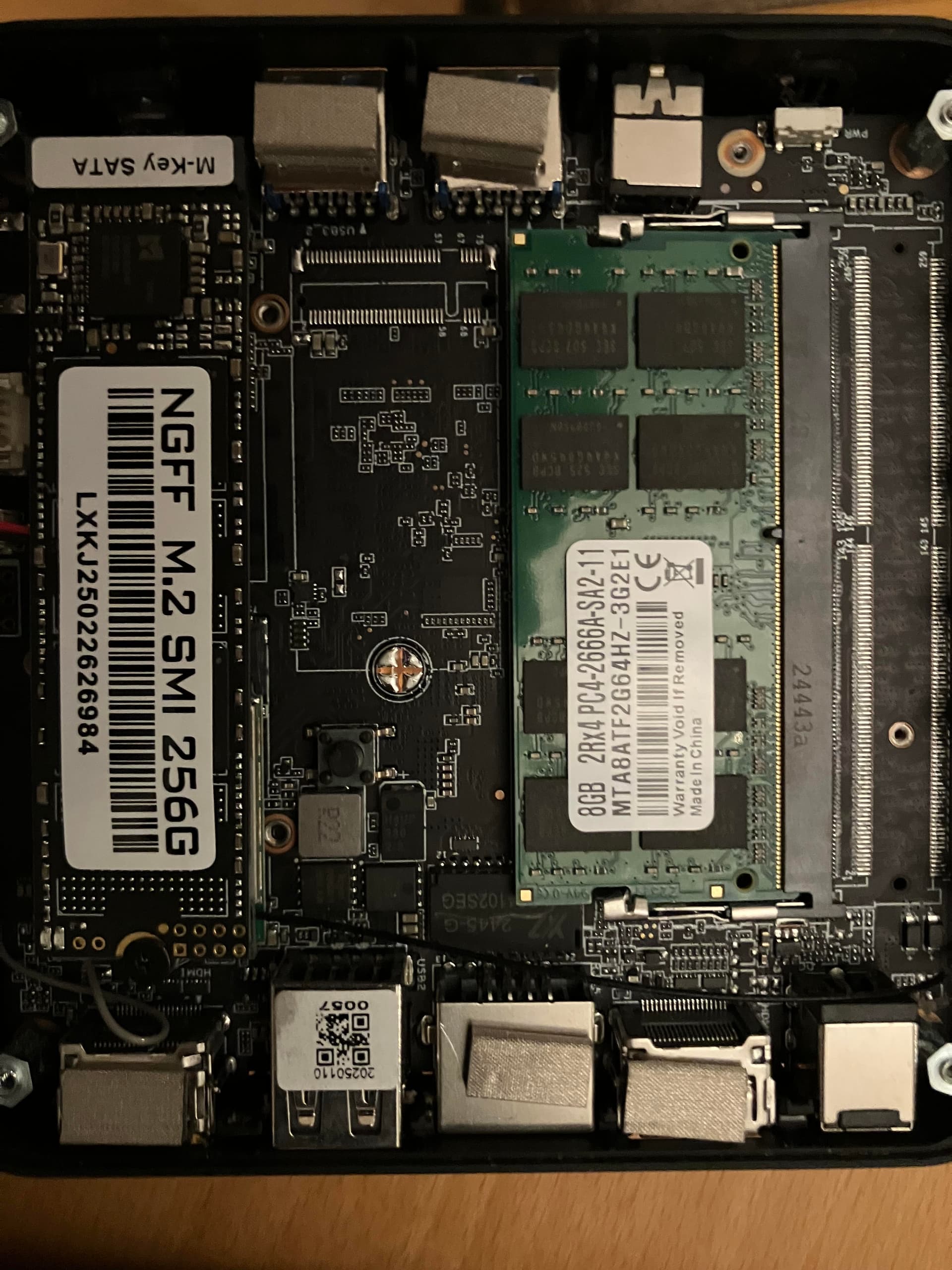

I have opened her up to get a better understanding of whether its a SSD or HDD. From what I can tell its a SSD and from what I have read the socket wont allow NVME but please take a look below.

Yes, the internal SSD should be good. It is SATA, but doesn’t support NVMe so can’t go any faster than what you have. Too bad it has only one RAM slot.
If you’re not in a hurry to upgrade the RAM, I have a 16GB DDR4 2666 stick that I’ll send you if you DM me your shipping address. I can’t sell it because it is an A-Tech model that doesn’t work in a lot of mini PCs (and I don’t want the bad eBay review if it doesn’t work for the person who buys it). If it doesn’t work on your miniPC then you’d only be out the time.
