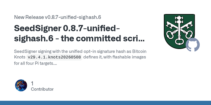

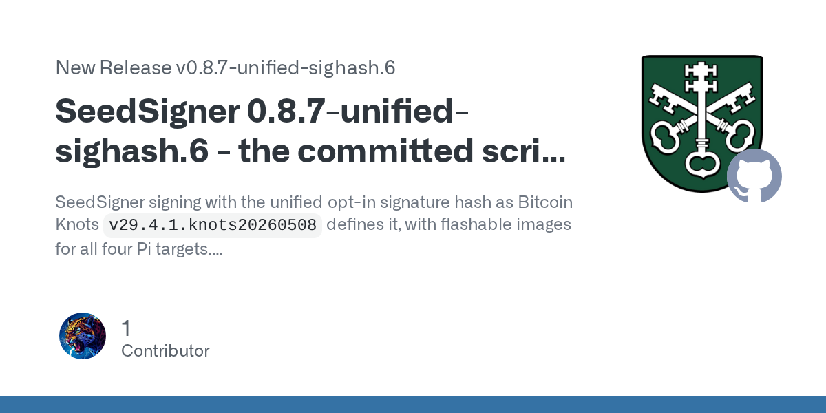

You will want to ensure that your BLAKE2b coins are replay protected before you start sending them anywhere. For that, I recommend getting Sparrow BLAKE2b up and running, and use a version of SeedSigner that supports replay protection to send your BLAKE2b coins to yourself. Once you confirm that transaction did not replay on the main chain, you can be sure about your two stacks being perminantly separated and safe from replay moving forward.
And that would be where? Do I have to build it?
I have a version here for the SeedSigner Plus (big screen version) I think there is an unoficial firmware for ColdCard too, and there are probably other forks of SeedSignerOS besides mine for the smaller seedsigner standard model (I haven’t been plugged into the hardware signer discussion as much as others have been)

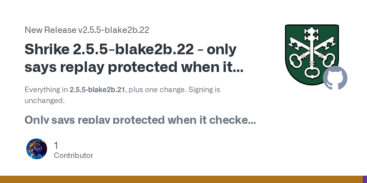

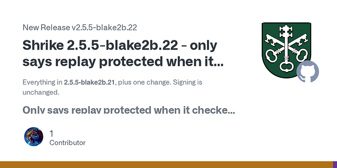

Actually, I just thought of a simple option that doesn’t require a seedsigner with the updated OS. All you need is Shrike or Sparrow BLAKE2b:
  1. Create a new hot wallet in Shrike/Sparrow BLAKE2b
  2. Send a small amount from your cold storage to the new hot wallet (something insignificant, not dust, but no need to risk much here).
  3. Send that amount from the hot wallet back to cold storage, with unified sighash selected (make sure it shows Replay protected).
  4. Now do a consolidation transaction in your cold storage, combining the replay protected UTXO with other UTXOs that you want to also be replay protected.
The output from #4 will be replay protected UTXOs in whatever size you need, that never left cold storage, and never required a hardware signer that supported unified sighash.
