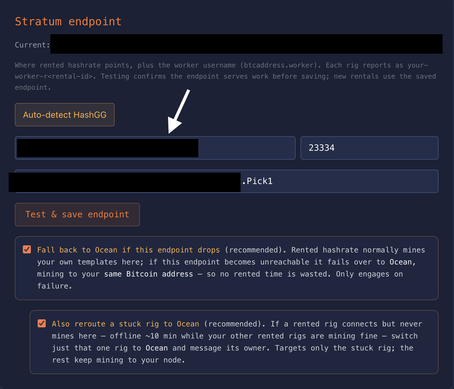

Take a look at the settings in PickHash down towards the bottom (as shown in the screenshot) and confirm that these look correct. Click on the ‘Test Endpoint’ button to confirm they are good.

I did what you mentioned in your reply before I wrote my initial post. Everything was green, connected, and seem to be working just fine, except for the connection from Datum to the Dashboard. Eventually though the problem was fixed, and currently everything is working the way it is supposed to. After I finished my first mining session (the one that wasn’t working correctly), I started another, and for some reason everything was suddenly working fine. So I am not exactly sure what the issue was, but whatever it was, it seems to be gone now.
